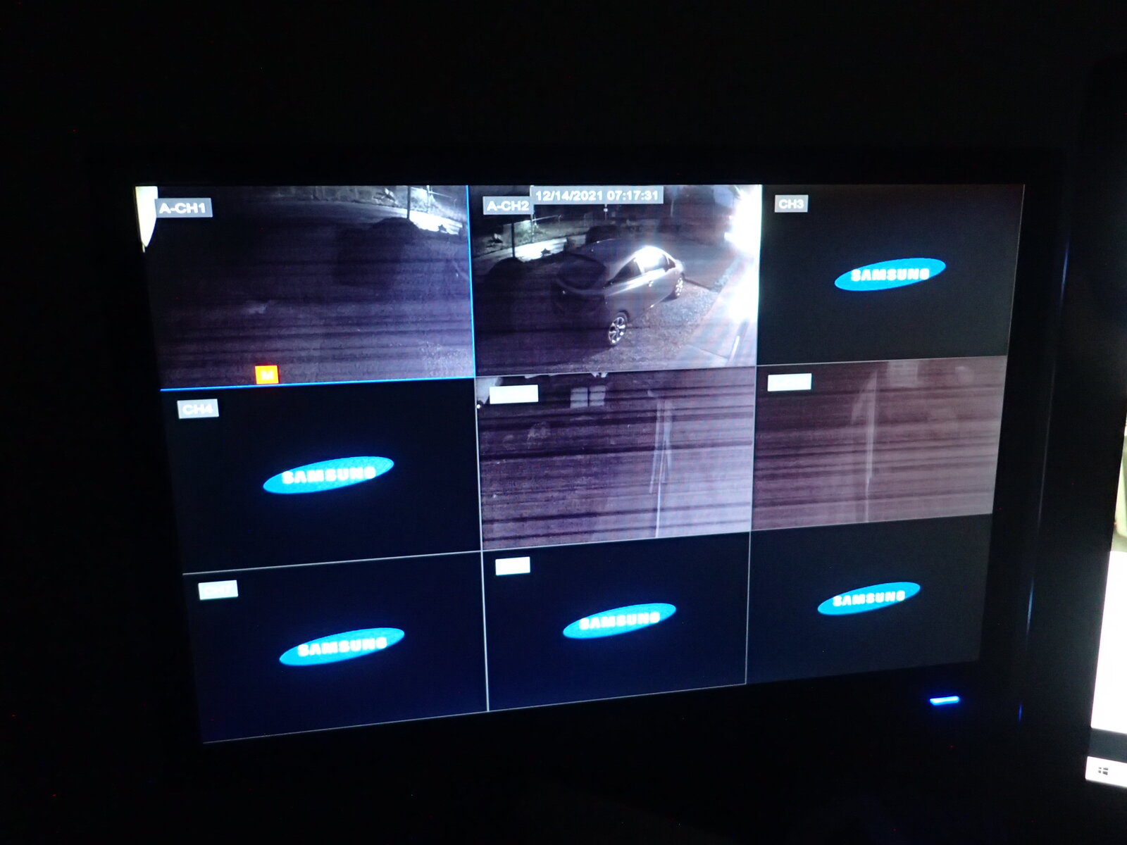

My 2017 Samsung has developed this problem,
6 cameras fitted, been no problems since installing.
3 are showing stripes across the picture 3 are completely blank.
Any ideas if this unit can be saved ?

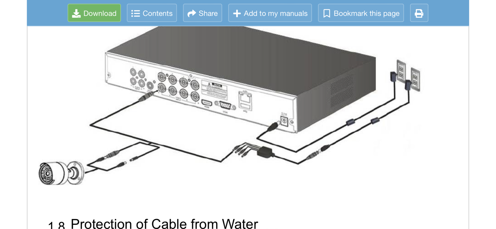

According to the manual on line …. It’s a separate psu for the cameras …. I would start with replacing this for a start OR UNPLUG the cameras at the psu and reconnect one at a time ….if one of your cameras are faulty it MAY cause this issue !
According to the manual on line …. It’s a separate psu for the cameras …. I would start with replacing this for a start OR UNPLUG the cameras at the psu and reconnect one at a time ….if one of your cameras are faulty it MAY cause this issue !View attachment 254214
Thanks I will try this suggestion, to eliminate the cameras first.
