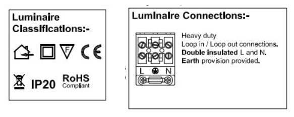

Could you perhaps help me understand (or, at least, comment upon) these couple of snippets from the MIs for a luminaire (which nowhere say that it "must not" be earthed, or must not have an earthed conductor entering it) ...
Thanks.
Kind Regards, John
One can only assume that they have done the decent thing and provided for ongoing continuity of cpc even though their light doesn't actually connect to it.

Indeed so. It seems eminently sensible to me, particularly given the regs' requirement that a CPC be run 'to every point'. However, I posted that as part of the a discussion about MIs saying that a Class II item "must not" be earthed and/or that an earthed conductor must not enter such an item.

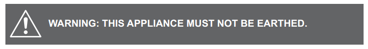

Fair enough - that's one, at least. Cooker hoods, like light fittings, are amongst the few things intended for end-user hard-wiring.
Do you have any thoughts about the reason they make such "must not" statements (and as prominently/'dramatically' as that one), when they do? I'm certainly not aware of any regulatory reason why one cannot earth any exposed metal parts of a Class II item. There obviously is no need to earth such an item, but nor do I see any reason why it should not be done (other than the general undesirability of creating 'unnecessarily earthed metal' - which, as I said, I find hard to believe would be their reason).
I suspect we are probably talking about ignorance, in that they probably believe that 'it is not allowed' to earth metal parts of a Class II item.
Because it is considered hazardous to do so and saying "Please do not earth it" is less emphatic - the same as "This product must be earthed" and not "Please earth this product".
Because it is considered hazardous.
There you go.
Ok. It makes their product safer.
Perhaps there are rules. Are there any hand tools which are still Class 1?
That is your view but you will have to ask them.
I would say that a "This product must be earthed" statement (for a Class I item) deserves far more emphasis than a ';warning' against unnecessarily earthing a Class II item.
Because it is considered hazardous. .... Because it is considered hazardous. ... Ok. It makes their product safer.
I think we will have to agree to disagree, since I find it hard to believe in your "philanthropy" explanation. I don't think one ever sees "this metal sink must not be earthed", despite the fact that unnecessarily earthing a sink (e.g. if plumbed in plastic) undoubtedly creates a far greater potential hazard than does unnecessarily earthing a light fitting or cooker hood - and, of course, bernard would presumably disapprove of any such warning!
In passing, those MIs you linked too contain a good few "musts", including the following, and I wonder what you think about them ...
... and must be connected to the electricity supply via a double pole switch having a 3mm minimum contact gap on each connector.
... The fuse must be rated at 3 Amps.
... The connection point must be placed in a position adjacent to the appliance so as to be readily accessible for an engineer in the event of a breakdown.
Kind Regards, John
