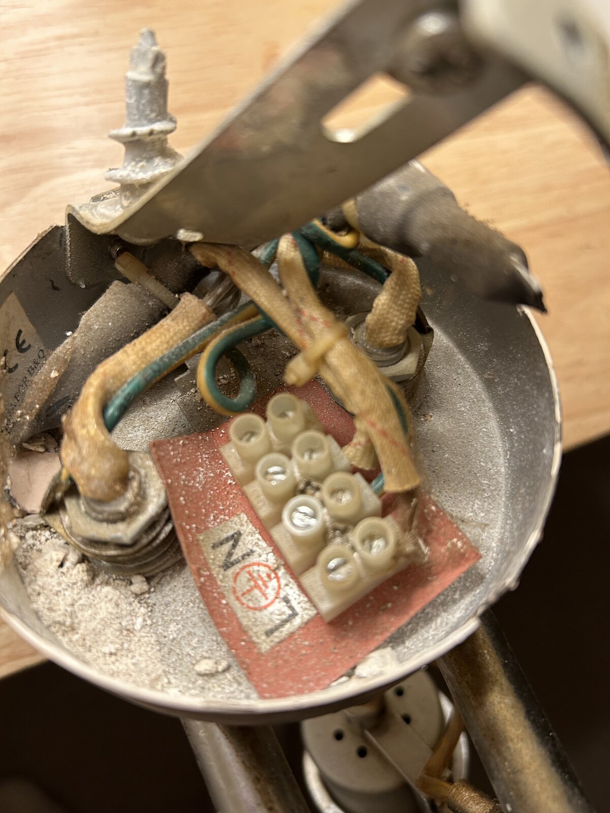

I stripped it down to clean it, which didn’t make any difference, there is no switch for it, I assume it should work off the light switch as the bathroom fans do. I’ll try and disconnect the wiring to it and take a picture tomorrow. Thank you
Did the light fitting you levered off have any extra loose terminal blocks with wires connected to them inside it?

Don't disconnect the wiring to the fan ,show us it connected.
No it didn’t, I’ve attached a picture of the old fitting thanks for any help

OK. But there is a 4th one attached to the 3 labelled ones.
Did it have any wires in it?
I don’t know, I literally had to rip it down, I’ve got the same setup in my bathroom, so I might try and see how that has been wired without disconnecting it
