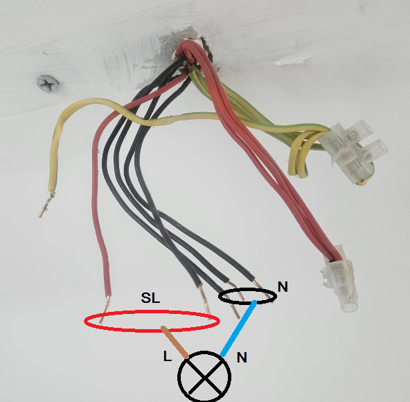

You need to find out which black is the live from the switch ,for that you need a multimeterthere are 3 reds going into the connector block, plus 1 'open' red. There are 4 open black wires.
I have a connector block, but not sure whether I can just 'tie off' 3 of the black wires in it?
So the black that goes with the floating red is definitely a neutral.yes two light fittings in the room, they both come on off the same light switch
There is a way to do this without a tester but much easier with one.Hey Pete your on a roll now![]()
YesGreat. getting a multimeter now. will test the blacks to see which beeps as the live switch and connect that to live with red. then the 3 other blocks into the neutral. correct?
