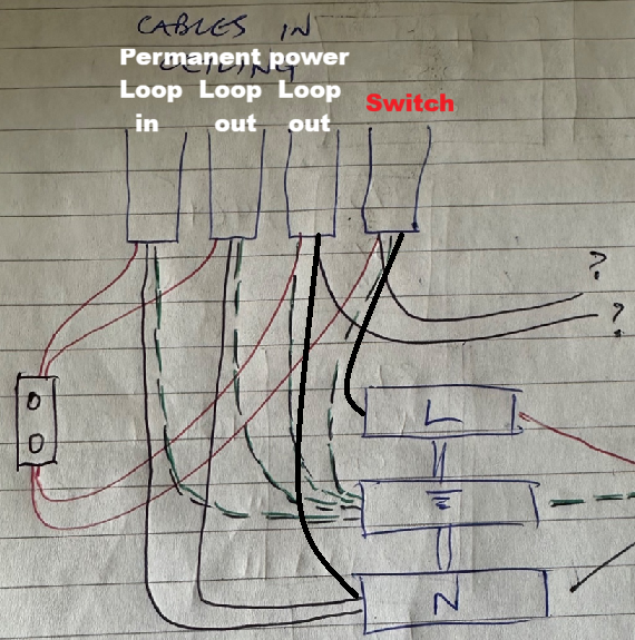

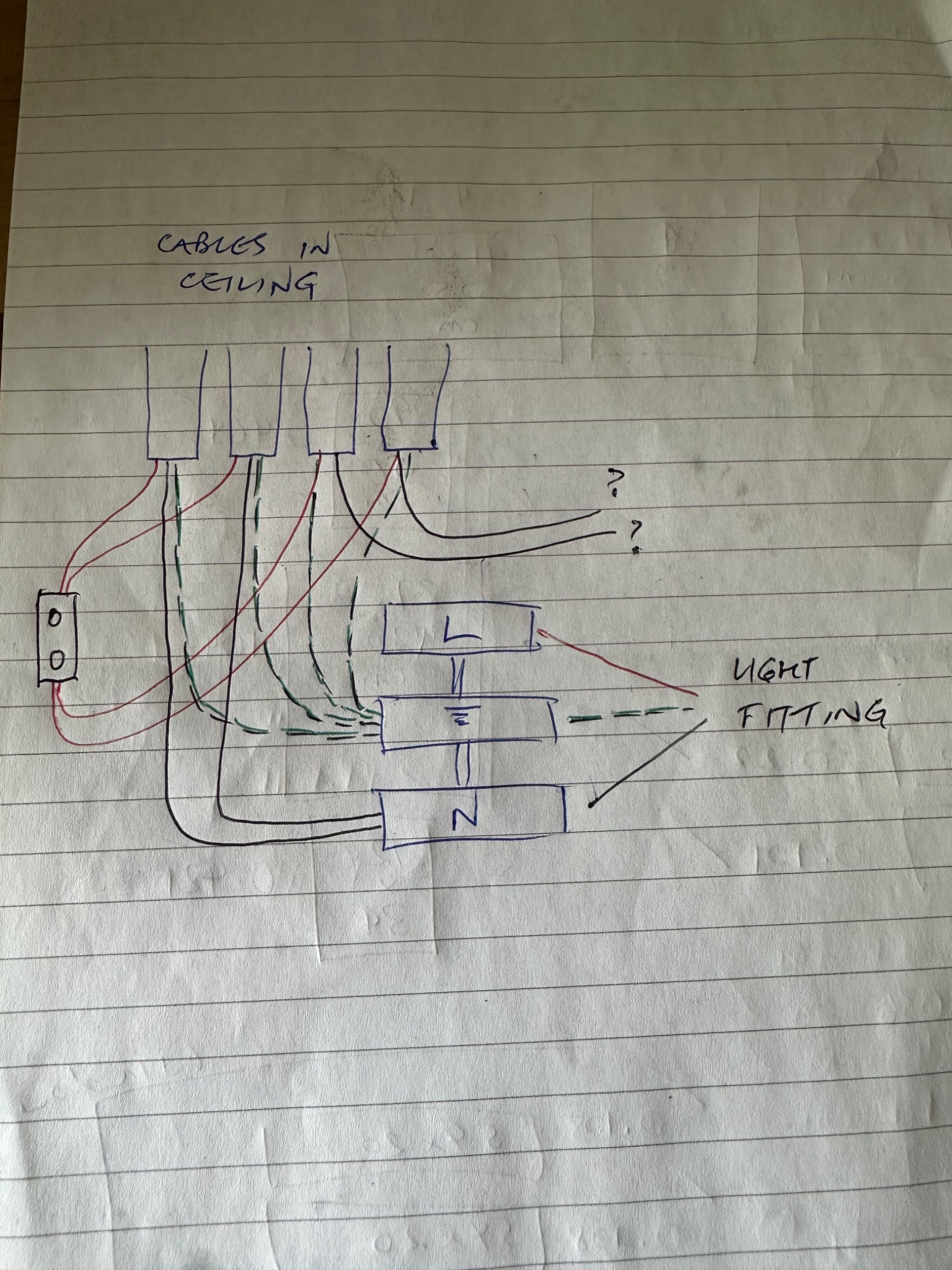

Hi please see attached drawing.
I have just undone the ceiling light and I have 2 neutral wires disconnected and nothing going to the live.
The lighting on the consumer unit is off.
Please advise how to correct/connect
Many thanks

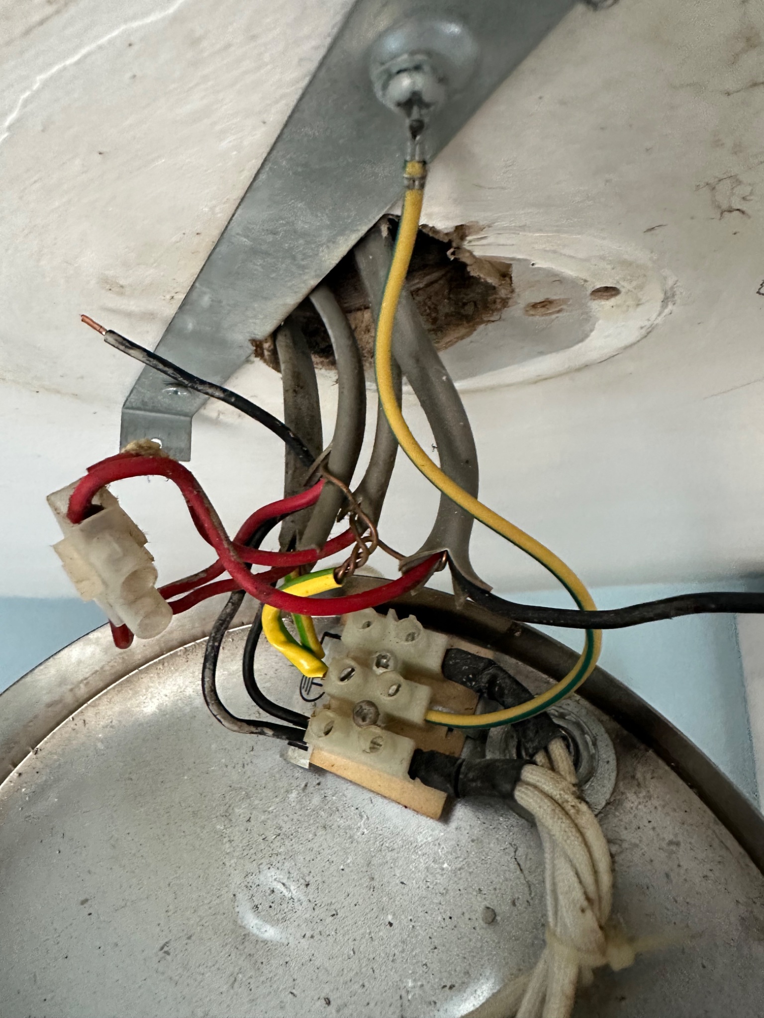

Got a picture of light fitting.
Your diagram isn't correct. Well it don't make sense as I'm sure you are aware.
I can’t swear that the person hasn’t messed with the wiring trying to sort themselves

I'm assuming one goes into the L terminal and one into the N terminal. Something like this:
But the difficulty is finding out which.
BUT I AM MAKING ASSUMPTIONS AND MAY BE VERY WRONG

Is it a few loops at the light and a pair to the switch
Not that familiar with uk wiring so a power off and a multimeter needed ?
Put a chock block on any (ALL) loose wire ends (one per end) turn the power back on and then answer Sunray’s questions about what else works/ doesn’t work and do you have any test equipment e.g. multimeter.
Reason for looking at wiring: small amount of water dripping from leaking bathroom above.
In the absence of a multimeter if I can identify which cable goes to the switch can I connect that neutral to the live and and the other to the neutral.
Not in th property at the moment to check what else works. All I know is it tripped the lights breaker and it cannot be reset as things stand.

Put your testers on earth and one of the blacks the one that goes on and off (230v to 0v) when you switch the switch is the L the other one will be the neutral.
If it's you're going to suggest things like that I'd say put one black in the L terminal, make the other black safe with a single terminal and then try the switch.
If the switch operates the light then good you have found the switched live wire, if it doesn't - go round turning the others that don't work on/off, if that makes this light or others work then you have found the neutral wire.
