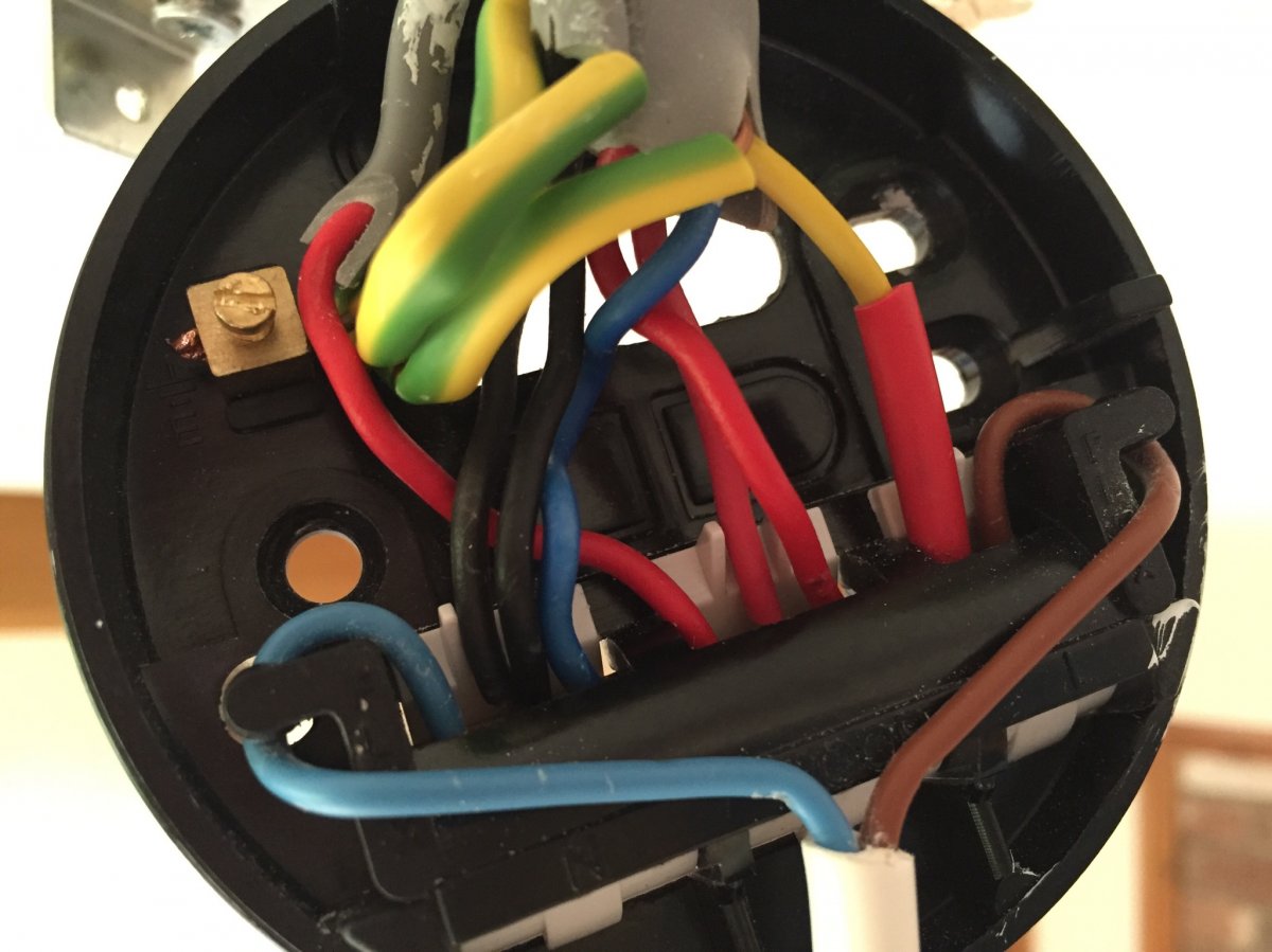

I've just taken this of and tried to fit a light fitting. Which didn't work. I've put back as I thought it was and now the ceiling rose doesn't work. Can anybody tell me what I've done wrong...

Are you sure all the copper wires are connecting to the terminals?
Was the red sleeve definitely on the yellow wire before?
The wiring could be correct but it is impossible to say from here.

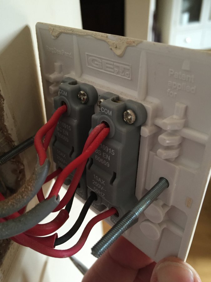

Can we have a picture of the wiring in the relevant switch?
The switch on the left as you look at it controls the lights on the ceiling... Definately haven't moved the red sleeve...

I think we were expecting the cable with the red,yellow&blue conductors to have originated at the switch, but it obviously does not.

Certainly check that the wires in the light you have altered are correct. Make sure none of the conductors have broken off, they sometimes do.
