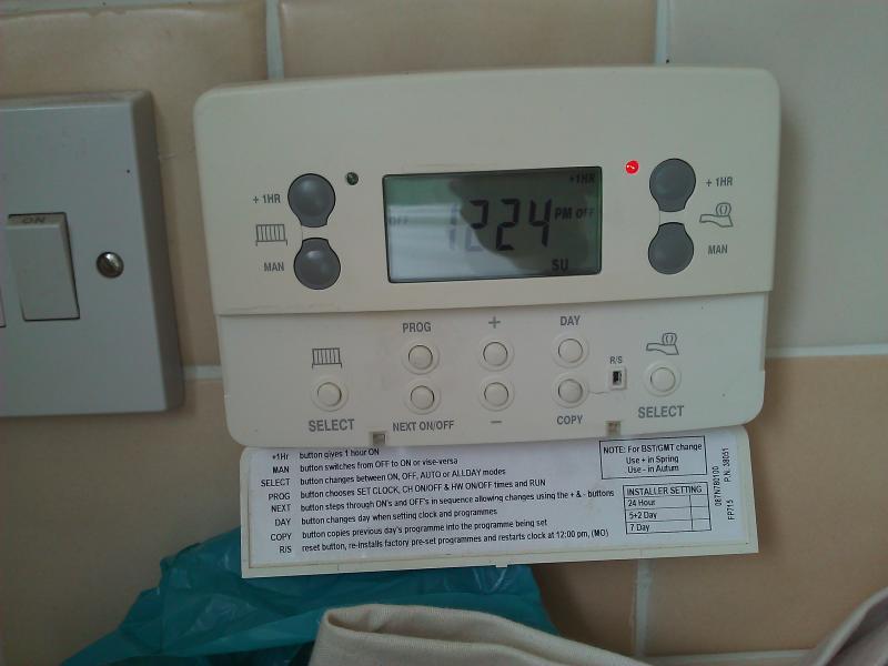

The boiler has a programmable timer which is preset with some on/off times but we have this set to "Off" all the time and only use the +1 hr for heating the house when it gets really cold (So far not that often).

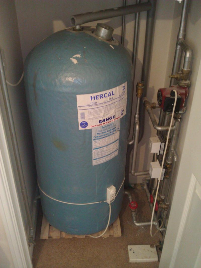

I have uploaded a picture of the airing cupboard (the thing that I randomly flicked was the white box on the right (well one of them) hope thats helpfull!

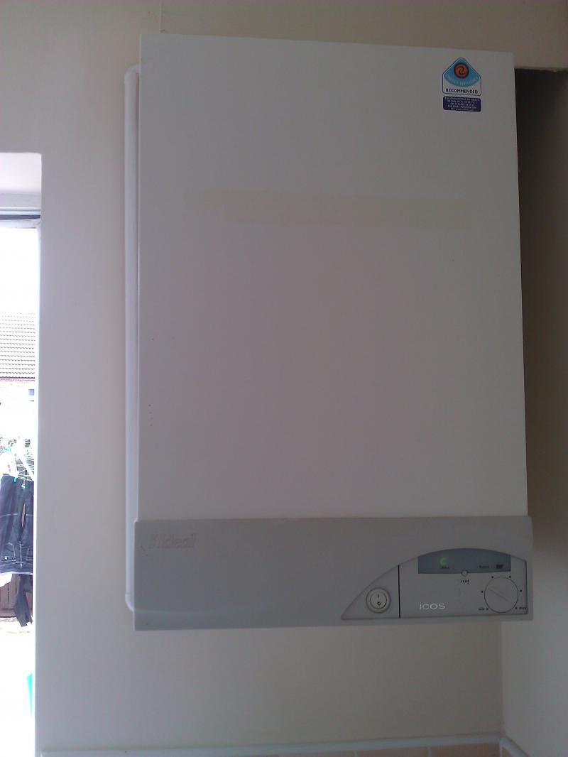

Make and model of boiler would be helpful

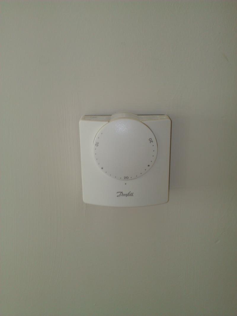

That's OK at the moment, but you will need to set some times when it starts getting colder. What make make/model programmer is it? Do you have a wall thermostat, if so make and model, please.

You have two motorized valves (HW and heating). The heating valve may be leaking internally, so water can circulate even when the valve is off. You can check by feeling the pipes.

Are you talking about the pipes which go into the side of the HW cylinder?
Finally randomly flicked a switch on the top of something (Dunno what it was) from automatic to manual and back again and the pumping noise stopped
The two white things are motorized valves (see earlier). It sounds as if one of the valves is sticking.

I have uploaded pictures of the boiler, user manual, Thermostat, and a few other bits and pieces.
In response to your questions:
I only saw one tank in the loft (however I wasnt up there looking for them it was an unrelated job, so maybe I missed one) As for make/model Ill have a look later but I dont remember seeing anything any markings on it it was just a big tank...

"Are you talking about the pipes which go into the side of the HW cylinder? "
Yes the pipe to the top was cold, but the ones comming out of the bottom right leading into the loft were hot.

Not connected. The white heating valve is probably passing water when it's supposed to be closed. You can tell this by feeling the pipe either side of the valve.
Yes the pipe to the top was cold, but the ones coming out of the bottom right leading into the loft were hot.
The pipe at the very top, next to the immersion heater, is the hot water supply to the taps. The branch going up into the loft is a safety vent pipe. You will see the other end hanging over the cold water cistern in the loft.
The pipe at bottom left is the cold water feed from the cistern in the loft.
The two pipes on the right are the flow from the boiler (via a white motorized valve) and the return to the boiler. They are connected internally by a large coil of copper pipe. The water passes through this and so heats up the water in the cylinder.
