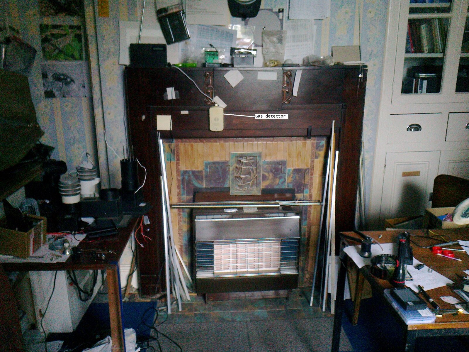

Post some pics...this system sounds like a museum piece and we could do with a laugh :)
Hi G,
Go on then have a laugh at my expense;)
C
dear Mr clutter from clutterville, check the wiring to the BBU it may have been burnt through if you havent had that serviced properly, then I would be looking at the pump, when I say I , really mean anyone daft enough to take that on :LOL:
Hi I,
Clutter? You should see the other three walls:) Actually, there are a lot of different subjects in there, as it is a big tidy workshop squashed into a little room.
2nd opinion for looking at the pump (water logged)
I flushed and inhibited the whole water system.
I'll check the wiring, also.
C
Is that a gas or CO monitor? Looks tidy compared to my office. Mrs Vicario refuses to hoover it as she can't see the floor some days.
Hi V,
A gas monitor. I clean my PCBs with chemicals, (Degreaser, alcohol etc) and it goes off then) Actually, the boiler has a gas cut out, but the fire doesn't, and it's impossible to change it.
I tidied up for the photo;) Yes, we are too busy to keep clearing up all of the time. I presume you are doing jobs in parallel, like me.
