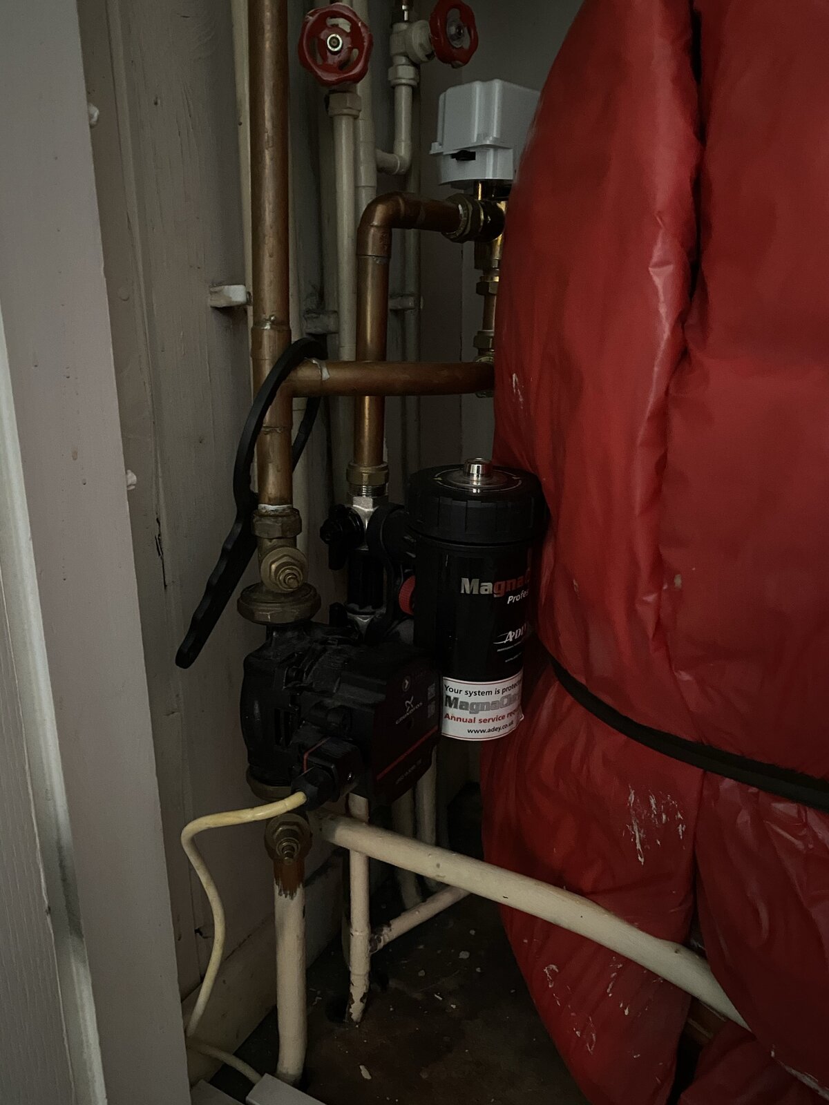

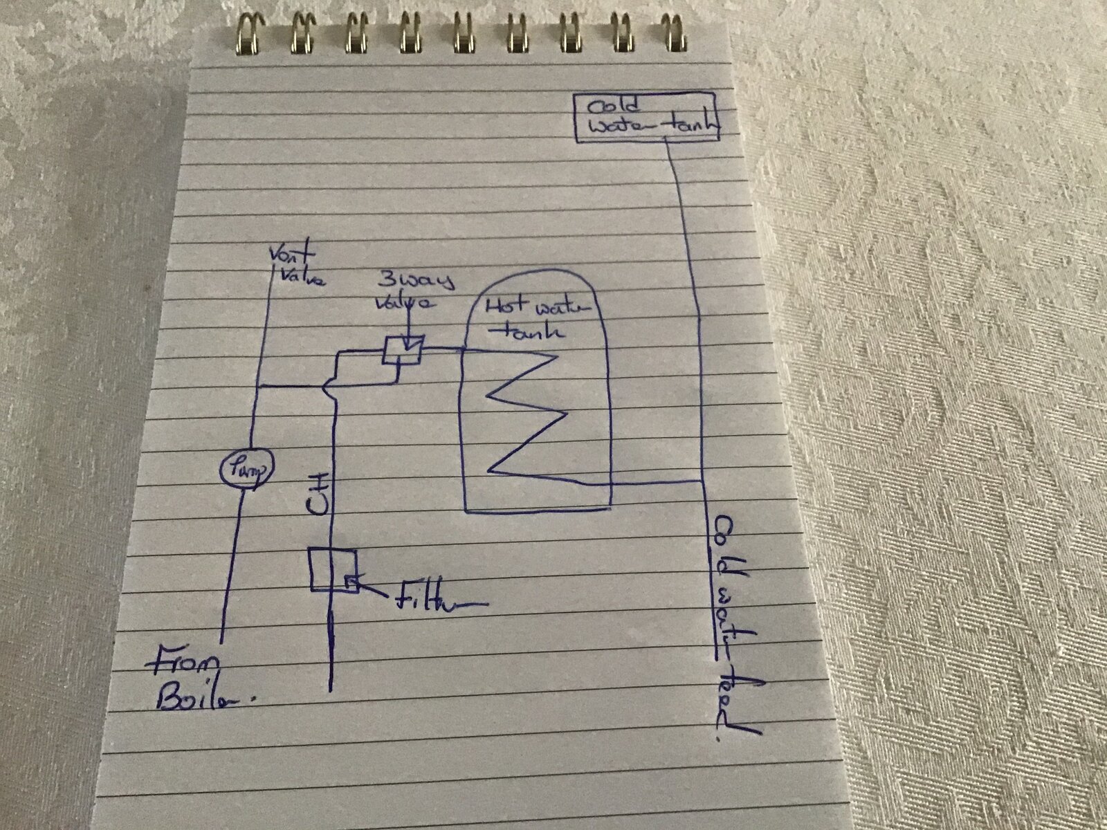

If you take a look at the photo attached and the rough sketch of the layout I have. The filter is only on the central heating side of the system this was down to available space. The vent for the system is on the opposite side of the hot water tank

If the system is getting nice and hot, then there's not a lot wrong with the Boiler, get it serviced regularly and it'll go on for a while yet hopefully.
I'd say the problem lies elsewhere, given you've an old cylinder, possibly designed for gravity circulation. I'd put money on the Cylinder is taking the Lions share of the flow when HW and CH are on, and given the heat losses with that thin jacket, it will be taking longer to reach temperature, (if at all), hence the HW is rarely getting to set temp, and so the call for HW remains for longer, meanwhile starving the CH of flow.
Would be well worth upgrading the cylinder for the new type with factory fitted insulation, and fit a Gate Valve or similar on the Return as it exits the cylinder to control the flow flow.
Also I'd suggest the Cold feed from F&E Cistern needs relocating, possible risk of the system pumping over with the current setup. The Vent needs to rise continuously form the boiler, then the cold feed to couple in within 150mm, then the pump, to create a neutral point.
When I mentioned my father in law had very similar problems in my initial post, the engineer from British Gas who came was unable to sort the problem other than fitting them a new boiler which they probably didn’t need. However his supervisor came along said it was piped up wrong similarly to mine, he cut off and blanked the piping to the vent and cold water that went below the floor boards and re-attached them next to the pump boiler side. Why would he have done this? It would suggest to me that rather than having the floor up to sort out a blockage, he basically moved that part of the system from under the flooring to next to the pump. After this was done their heating has been brilliant.
With a Fully Pumped system, you have to be careful the water doesn't take the path of least resistance, which in some cases is straight up the vent pipe, and into the F&E Cistern, rather than around the system as intended....
Given the cistern will quickly fill in this situation, with only a 15mm pipe feeding back into the system, you'll soon have a cascade of (sometimes very hot) water coming from the overflow pipe, known as 'Pumping over'. Once it stops, the system will settle and refill from the F&E cistern, with fresh water as required, which you certainly dont want as it dilutes the inhibitor. Pumping over also pulls a load of air into the CH system which you also really dont want...
By connecting the Vent then cold feed in close proximity, shortly before the pump, this has the effect of creating a 'neutral point' in the system and prevents Pumping over. Some use a air separator, such as the Myson Aerjec for this purpose, but they are often a common point for blockages, and then get cut out to be replaced by the 'H' setup of pipework.
