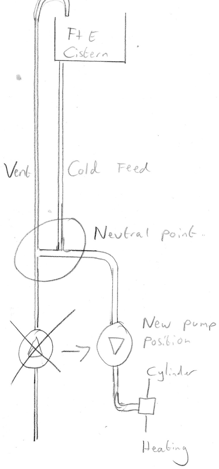

Knocked up a rough sketch of what I think you need to achieve. The Pump needs removing from current position, (assuming that's the vent going off from the pump up into the loft), so its fitted after the Vent and cold feed. This puts the vent and cold feed on the suction side of the pump, and coupling them in close together cancels them out and creates a neutral point to prevent pumping over.

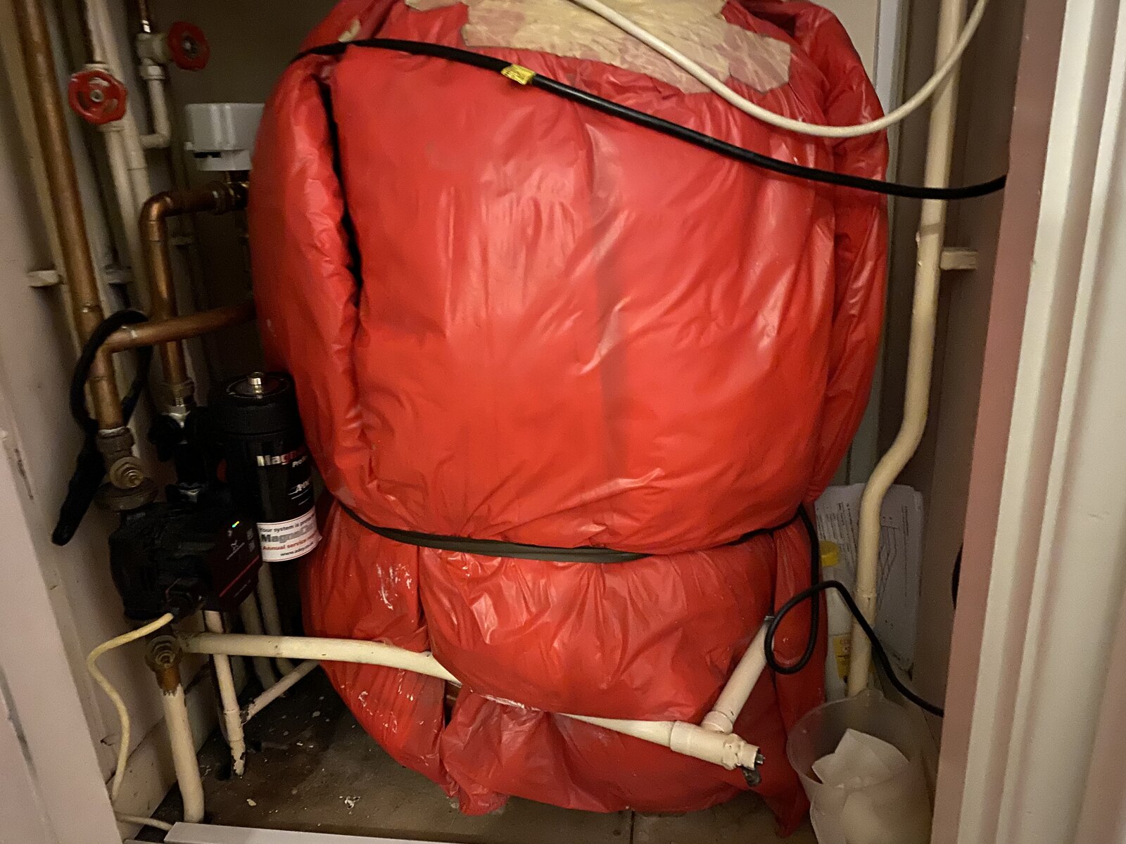

The pipe to the right of the picture right of the hot water cylinder B7C38571-ED54-4DB4-A254-14B390F8220D.jpeg is currently the vent pipe, the pipe that continues above the pump terminates just above with a bleeding valve on it to get the air out.
I don't think the open vent should be across the top of a tee like that, as it will add to the risk of overpumping. Better to to take it from the top of a horizontal run. And the cold feed preferably up and under (no more than 150mm from the open vent) to reduce convection in the pipe warming the F/E tank, with risk of algae growth.
