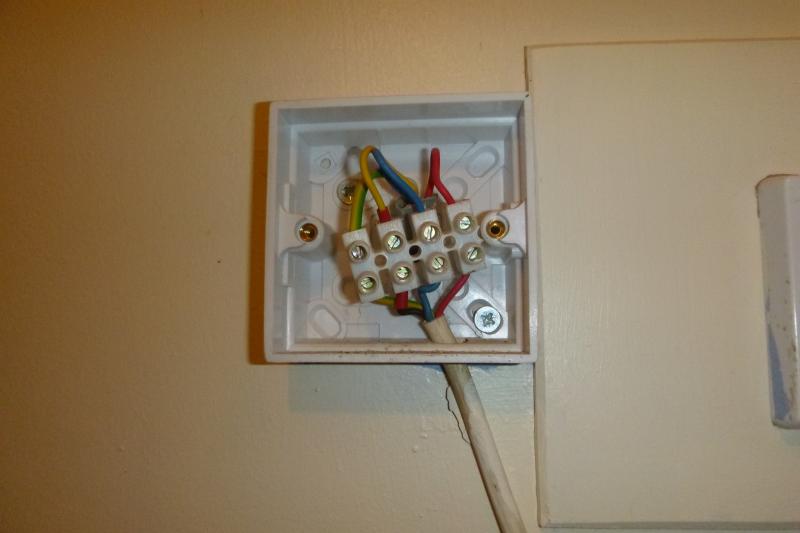

Yes you can use those existing wires.
The red is live, yellow is switch live and blue is neutral. When you wire the receiver use the red as live but also put a link wire between said live and the remaining switch position.
Simples although not technically the correct way to do it because on the time clock you would need central heating on constant to keep the live "live" all the time to keep the receiver and stat paired up.
If using this method, best to buy a programmable stat. Leave the heating on constant on the existing programmer, and control ch timings with the new stat.

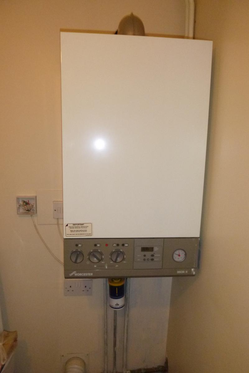

Hello. Thanks for your advice. Upon tracing the wires in and out of the boiler - there is a handy box on the wall that I could use to locate the receiver. If reception is an issue - I will work that out later!

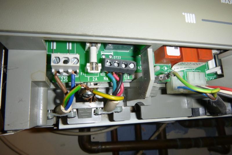

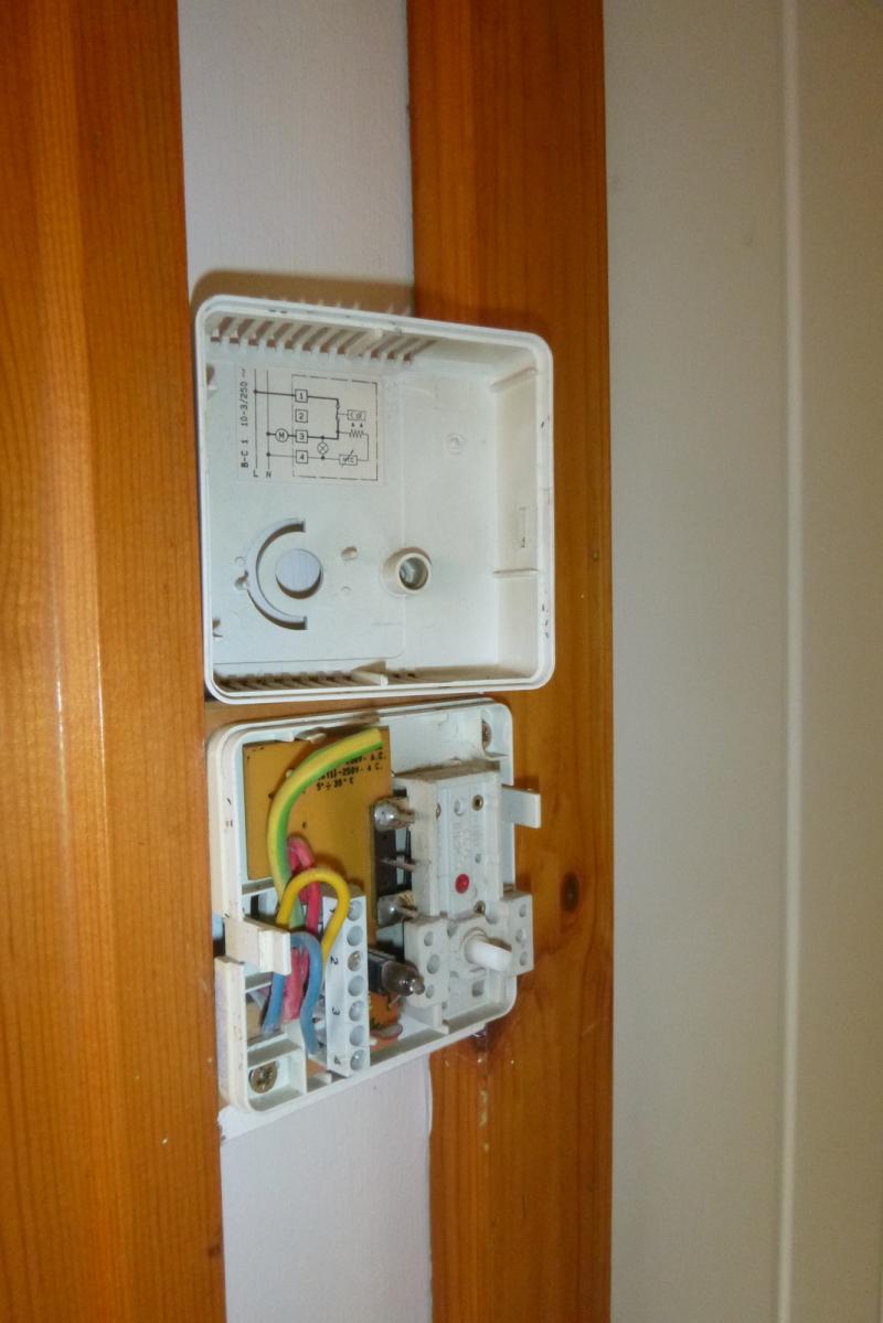

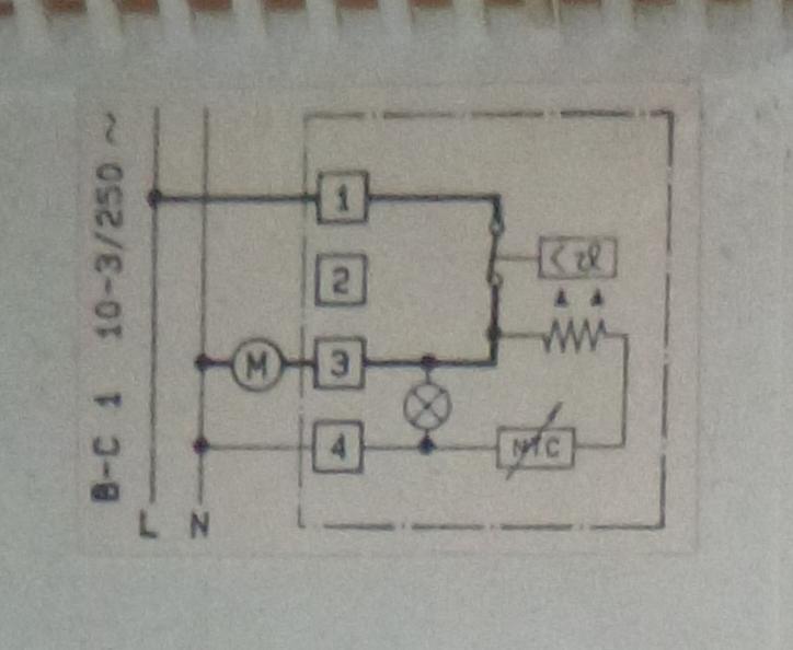

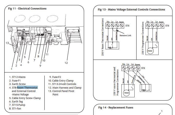

As promised - pictures. I've summarised it into a colour coded diagram too & I have added a diagram found in an on-line installers manual for my boiler.
So - if I were to sit a new wireless programmable thermostat in the switch box next to the boiler - what type of programmable thermostat would I need? I assume I would need to set the clock / controls on the front of the boiler to "always on" too.

Anyway, your existing stat is wired into block ST8 - black, red and blue wires. These would need removing.
The new stat's receiver has 4 wires. The first 2 are the permanent 240V live and neutral that can either be connected to share the terminals in the '230' block (red and blue wires) or wired into L and N connections in the boiler's fused spur..
The other two wires in receiver will be connected to Ls and Lr (middle 2 connectors) on the ST8 block. Any way around - not important for the order on these 2 wires.

baby care politics aside - I opted for this one. It would be grand if someone can help me translate between the instructions and the boiler terminals' Ns, Ls & Lr!
Ls = L
Ns = N
Lr = 3
You also need to connect Ls to Common, but this can be done by linking L to Common at the receiver.

Does the clock actually do anything? It does not appear to be wired as in the bottom diagram on Fig 13 - there are no wires to the "Spare" terminal.
According to your diagram the existing stat controls the boiler directly.
As the clock will be redundant, it is best to disconnect it.
