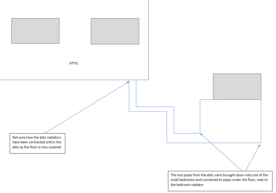

Hi everyone,
This is my first post, so my apologies in advance, if my story is very long. Before the covid-19, we had some work done by a plumber in our room-in-roof. We had 2 radiators added to the existing CH system. The pipes were connected to one of our bedrooms. Because of covid-19 the builder had to break-away from the job. He then contacted us on weekend to say he could come down over finish the install. But he said that he didn't want to risk anyone becoming, so asked if we could arrange for him to come over whilst we go to work and just leave him the money. Anyway to cut a long-story short, he came over at beginning of week whilst we were at work. He did the job took the money and went.
Due to the hot weather, we didn't test it until today. The radiators in downstairs rooms and bedrooms work fine, but the ones in the attic don't feel warm at all. We contacted him, but he denied he did anything wrong and said that he had tested them and they were working before he left. He became aggressive and blamed us (cheeky git).
I'm obviously going to report him, but I simply want to get the system working. I've already:
  • checked both sides of each radiator and both TRV/Return valves are fully open.
  • made sure there was no air
He has connected the new radiator pipes to one of the existing radiators in our bedroom. My suspicion is that he may have piped the flow/return pipes to our existing radiators wrong-way around. Could this possibly be the issue? If not, what else do you suggest?
Thanks for your help.

Sounds like it might be piped up wrong, both flows on one rad, and both returns on another. Do any of the pipes get warm/hot?
Yes....it's a possibility. I've done a diagram to better explain. I'm sorry, I'm not a good designer and I hope it's easy to understand.

not really sure how we can help you on line to be honest, get the feeling you will need someone to visit, only advice I can give is radiator circuits are just that, you have a flow and a return, if he has teed the return or flow in to the wrong pipe that is your problem
Ian, can you just clarify something for me? Does having radiator pipes connected to the existing piping wrong-way round make any difference?
