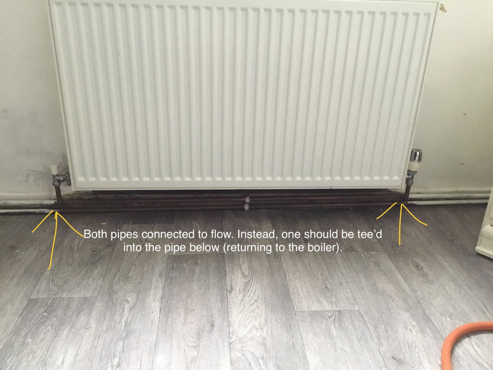

The most common mistake is as discussed,connecting both ends to the flow or return,but if he tested as he said he would have realised
You could lift the floorboards and see exactly how the new pipework is connected.
Come to think of it, I don't think he's tested it. Reason is that if he had, then when we came back from work, it would have been extremely warm in the house due to CH being on, combined with hot weather.

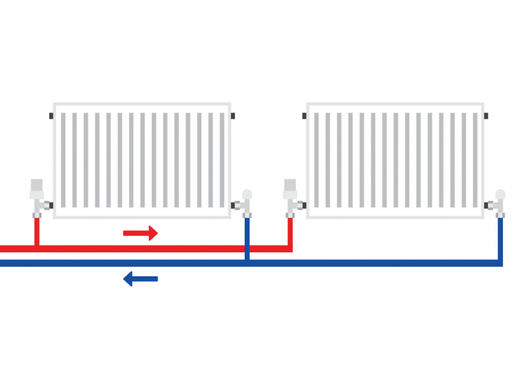

I'd really appreciate it if you can explain or maybe show me a diagram of what this mistake of connecting both ends to the flow or return looks like? It's just that then I can compare it with what my setup looks like.

Pull up the floor and see how the pipework is connected...it will become immediately obvious.
If you turn off all the other rads the new rads should very rapidly heat up...that would confirm they have been connected properly.
Thanks gasguru. Can you also please tell me what does a one-way TRV look like vs a bi-directional TRV?
The photo I’ve attached shows what someone had done, connecting both pipes to the same feed (flow), and how it should be done.
