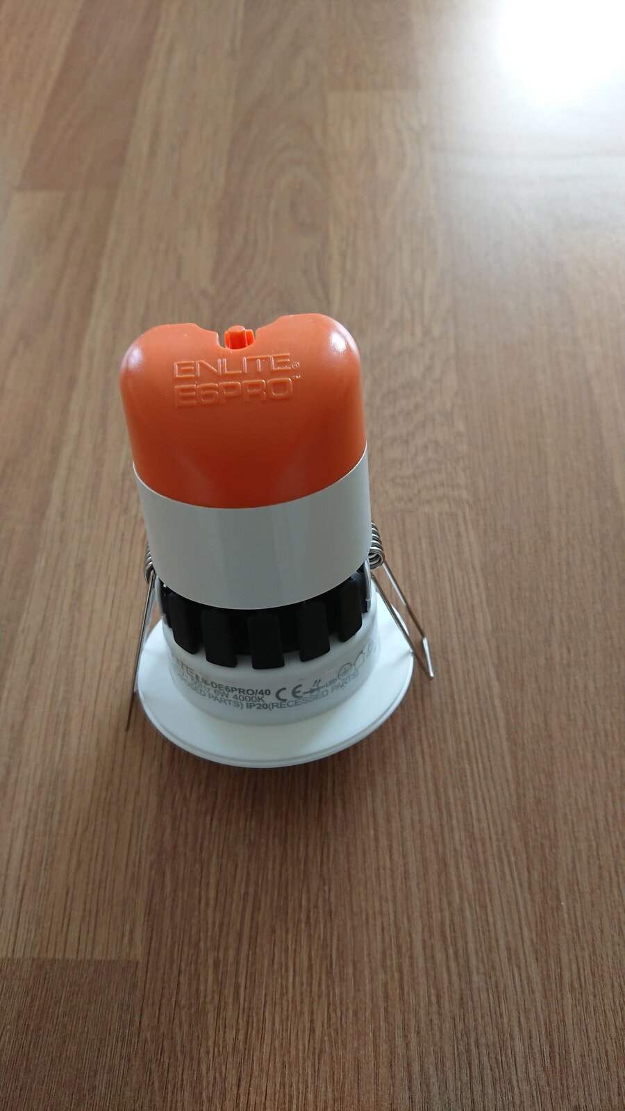

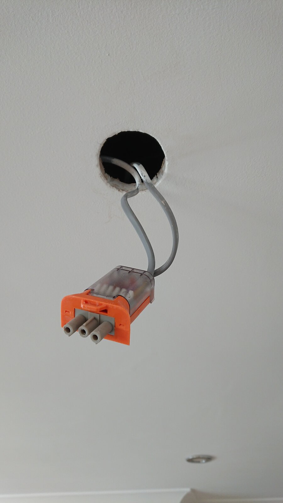

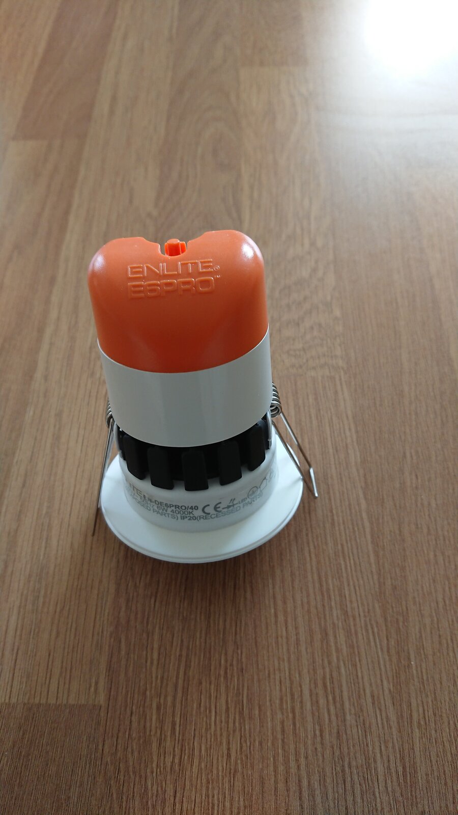

Can anyone help with a similar issue? Pictures below - not great but was hard to take while holding the light! These are Knightsbridge spotlights, I have taken the face plate off and am left with the lights as per the pictures. The bulb is blush to the plate thats left and I can't see how to pull the whole unit out of the ceiling without being overly forceful with it. I had assumed it would be a simple case of twisting the bulb out, but due to it being flush there is no way to get purchase on the bulb.
Do I need to wriggle the while thing out? I can see the spring but unsure how to make any use of that or how I'd put it back in if I did!
Thanks in advance!
