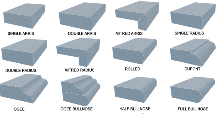

Thank you both. Another quick question about worktops.
Is "radius edge" the same as "bullnose"?
Bullnose is usually more rounded.
Might I be correct in assuming that the profile of the item in the link below is actually more like the Double Arris as shown above?
Probably, yes, it says 6mm radius.
