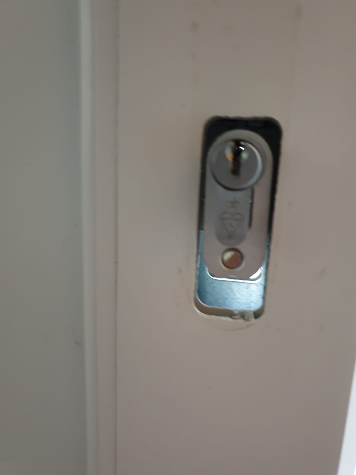

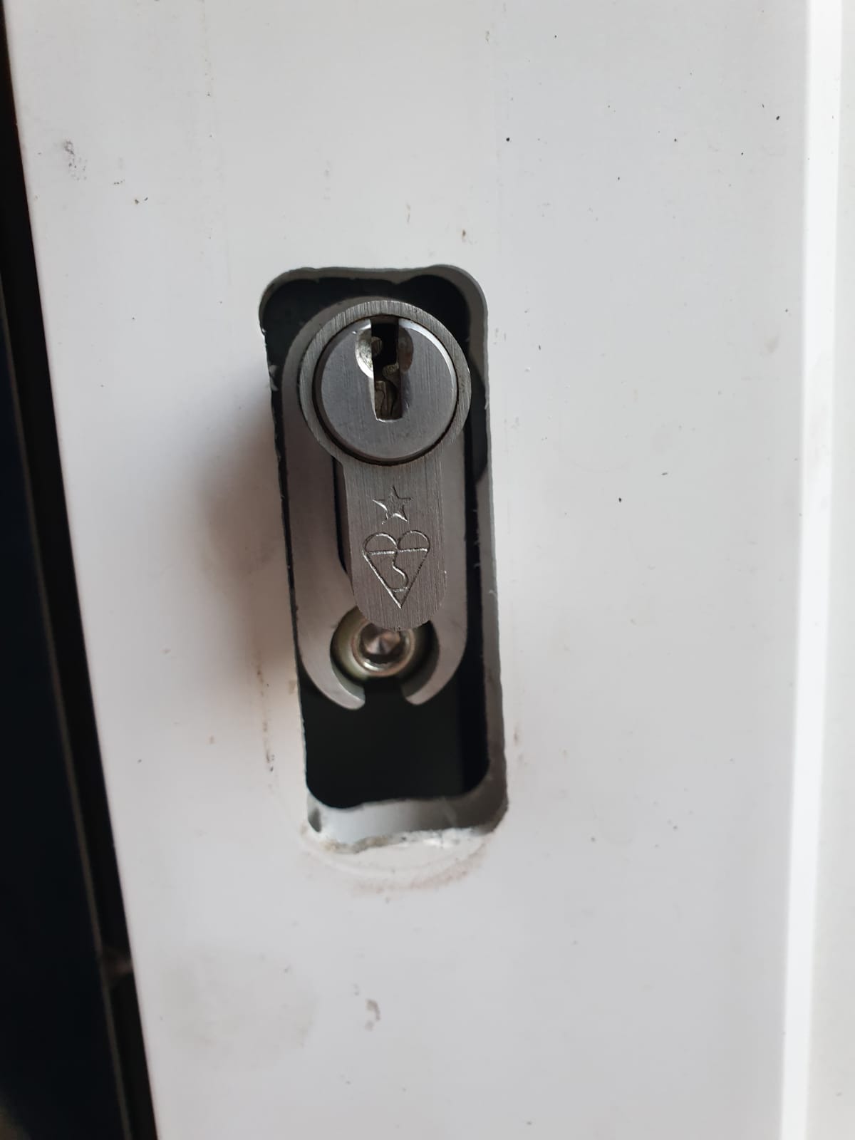

Hello,
Attempting to change over a euro cylinder on a UPVC door. Unable to take out the cylinder after removing the retaining screw. After removing the handles, was greeted with this. No visible way of easily removing the guard from what I can see - does anybody have any experience of dealing with this?
Thank you,

Is it not the Allen key on the front? Have you tried putting the key in and tried to turn and remove that way?
That was my first thought too, but it will not budge even under excessive force. I've tried every possible key position too and it will not come out.
Daft question, you have removed the screw that screws into euro lock?
It certainly looks as though the allen key screw needs removed. Look further down this forum section to a thread titled 'Composite Door Lock' seems to be a similar setup although theirs had a torx type screw.
Unless it's been thread locked in, it's a shield to give the cylinder extra strength in case of a snap attack, the cylinder could never have been fitted with that in place so the shield has to be removed

Have you tried putting an allen key into the bolt and then tapping it with a hammer? (Not hitting it ridiculously hard, but just tapping it progressively harder - that might break the thread lock, if there is any.)
