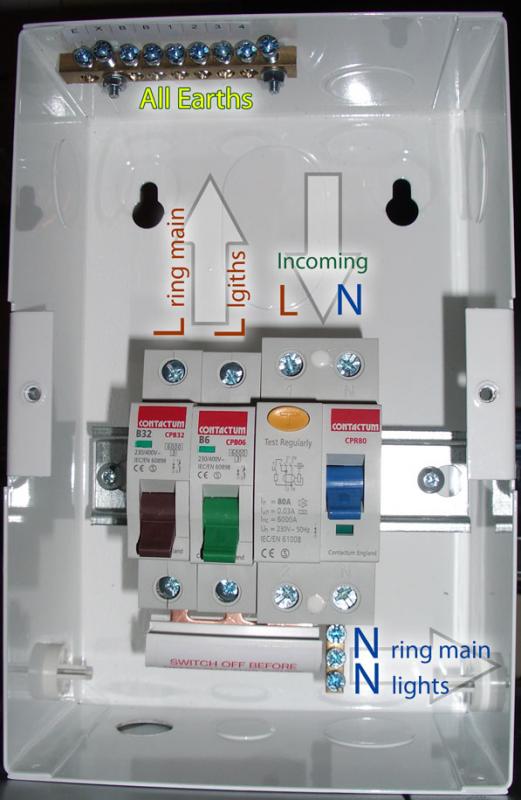

I've bought a new flush metal CU and now need to decide whether to call someone in (and perhaps pay for a days labour!!) or do it myself.
As a competent DIYer am I vastly underestimating this job or should it be as it appears which is quite straight forward? How much does it cost to notify the LABC?
Ok don't want to cause another "Help with wiring in electric hob tonight" but as this box comes with no instructions I have tried to work it out myself as below. Can someone confirm that I have labelled this correctly?
Also the armoured cable earth just terminates with a nut around the cable onto the current case. This new one is covered in paint so surely I will need to do something other than just tighten the nut?
you'll need a "banjo" or a pirahna nut ( sp? )..
have a look in the wiki or stickies, BAS has put up a post about terminating armour cables..
and yes, your drawing looks right..

yes you are underestimating it..
while the physical act of installing it isn't that difficult, you don't have the equipment to test it or the technical knowledge of the regulations to ensure you are doing it safely and correctly..
Depends on your area. But it would be about the same amount it would cost you to have an electrician fit and test that consumer unit for you.
Around here, that's about £170 + VAT for the building control fees. It will cost an approved electrician two or three quid to notify building control, giving you £167 to spend on his labour! And you will still get a certificate of compliance and a test certificate. And, most probably, some sort of warranty. All you have to do is make the tea.
