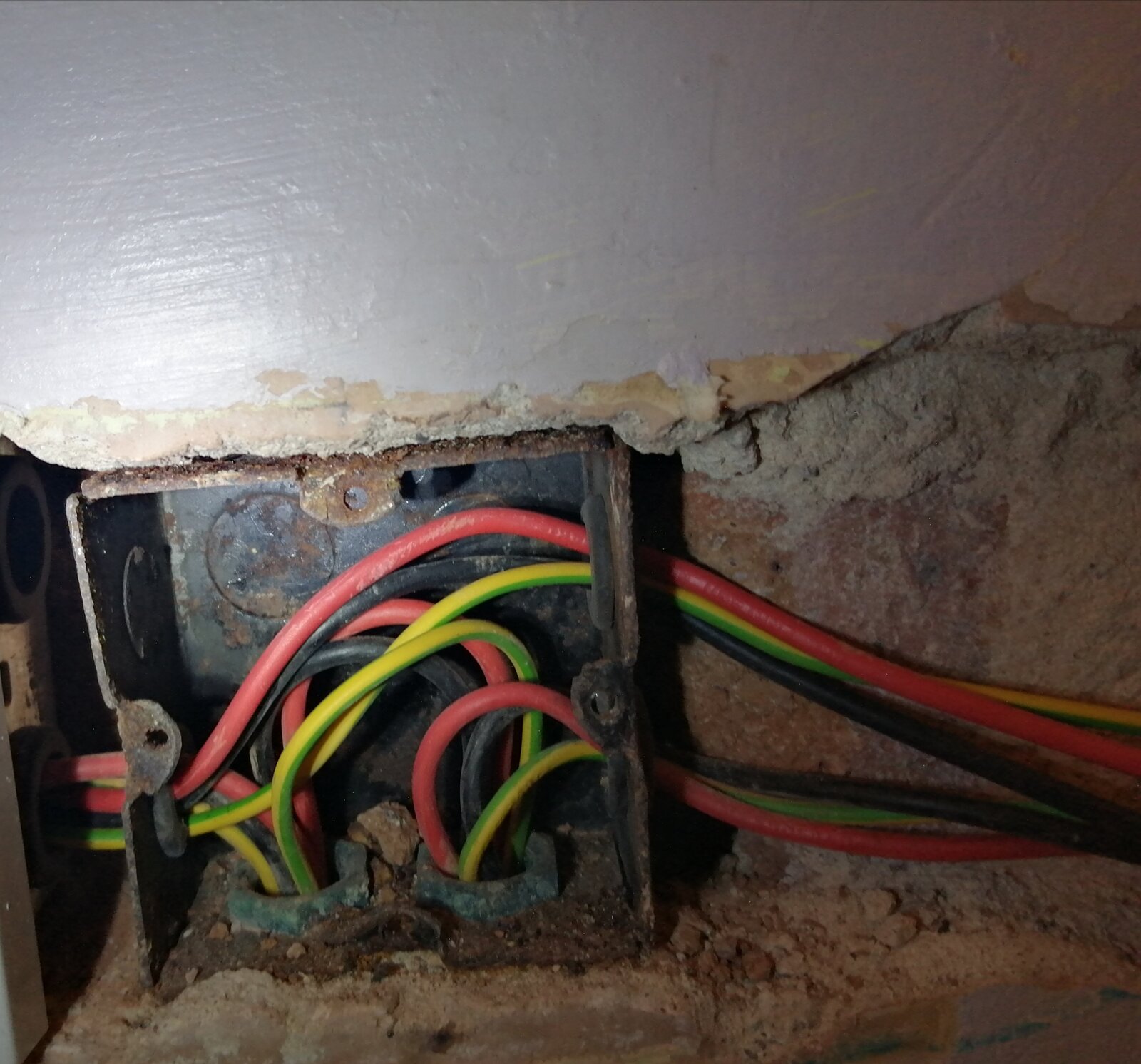

I Have chased and plastered "singles" cable for my living room sockets
when I did i just put capping on to them but I've been told that capping is not enough protection and that oval conduit is the preferred option??
In addition while chasing and capping one of the singles was not long enough so I used a twin and earth single core to extend it using ideal spliceline connector, the singles that were already there were stranded core
Is this acceptable of do i have to remove the plaster fit in oval conduit to the singles and also find a red stranded core cables
Neither capping nor oval conduit offers protection, nor is any required.
As long as your singles have insulation and sheath all is well.
A single wire from some T&E is not good enough, nor is a splice-line connector, for burying in the wall.

~~that's the offending pic your correct Taylor

If you are very lucky, you may be able to pull the singles out and pull new twin and earth cables in through the capping, but you may need to make some damage.
It may not work at all - but worth a try perhaps.

You should have used 20mm PVC round conduit with all the appropriate fittings - or T+E cable. Oval conduit is not used with singles either.
To use round conduit means that i have to chase a little bit more on the single brick wall. is oval not good enough?
It would be slightly better - yet still wrong.

Twin and earth cable wouldn't need to be as deep as 20mm round conduit - you could find a way to join the singles that ARE in round conduit to new T+E.
Send a few pics if you can, we usually come up with some brainwave.
Btw the red wire you extended sounds ok, as the joint in an enclosure, and the wires are adequately protected in the wall somehow.

So so to join the singles to t&e that would then mean making a connection in a junction box which i thought cant be buried
You would have to do the joints in the back of a socket.
