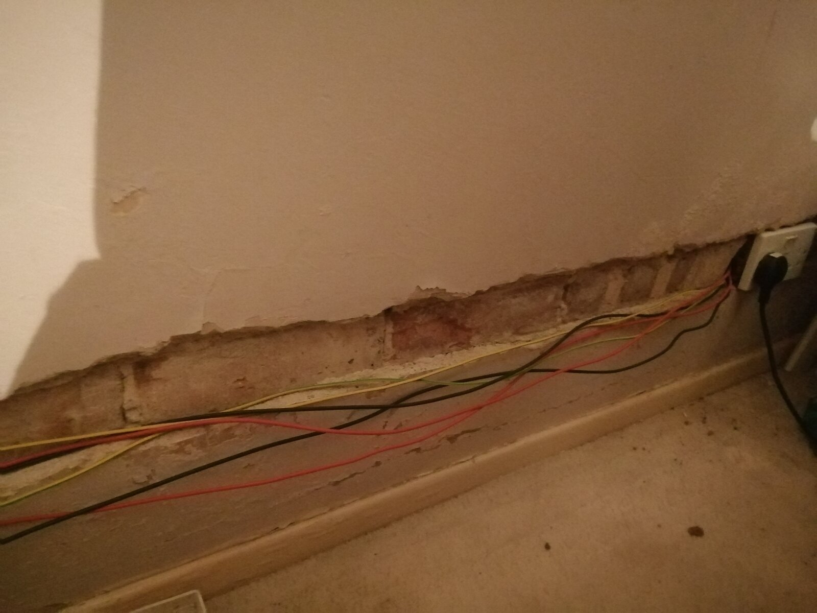

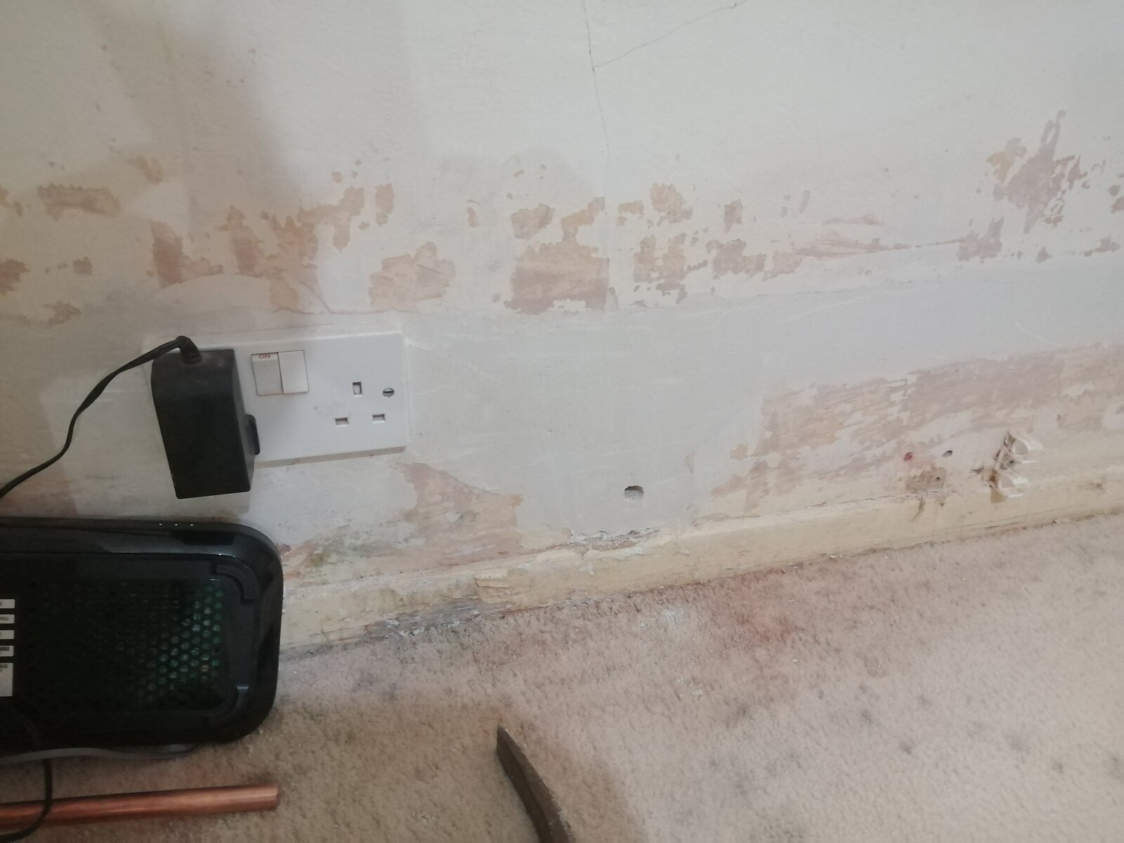

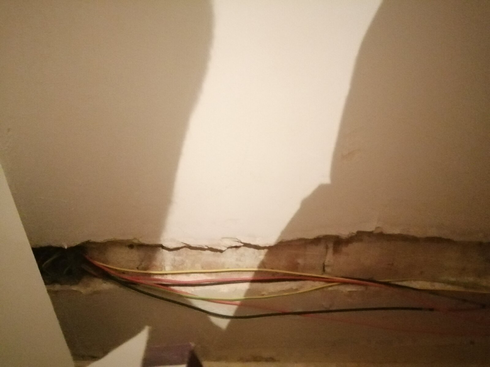

The initial chase the one that I plastered over was 20mm in some parts but on the corners less just below the plaster
The chase i made was for the whole living room was just about 5 meter hence why am shy to go at it again
Much less of a hazard than not. You are going to have to re-run the cables any way, why not use twin and earth sheathed PVC cable?

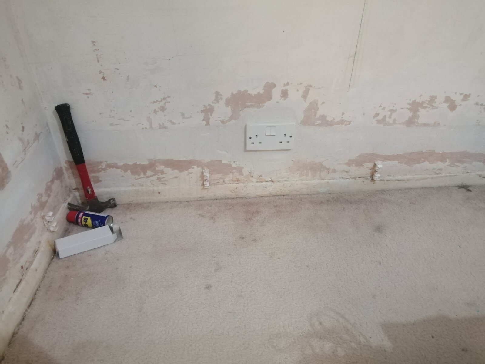

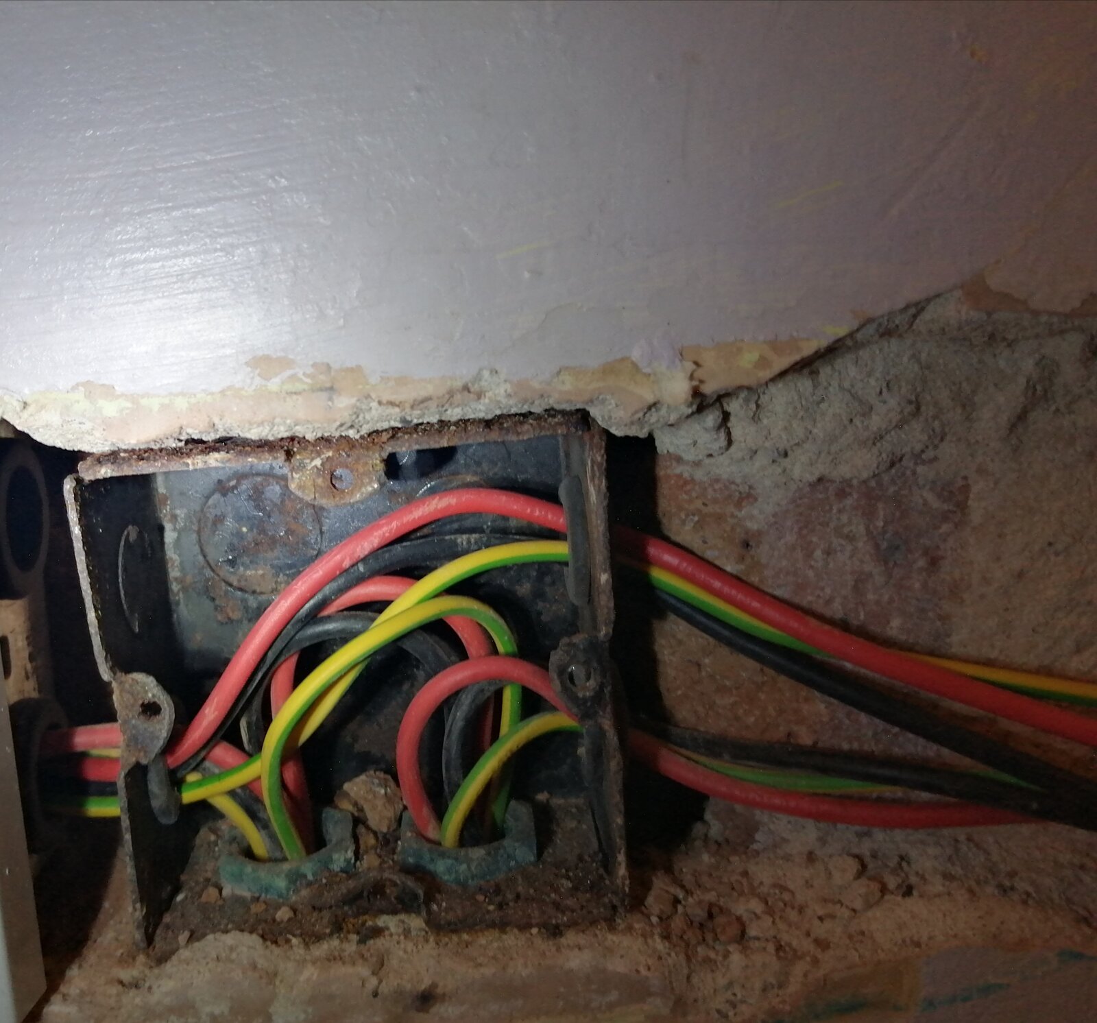

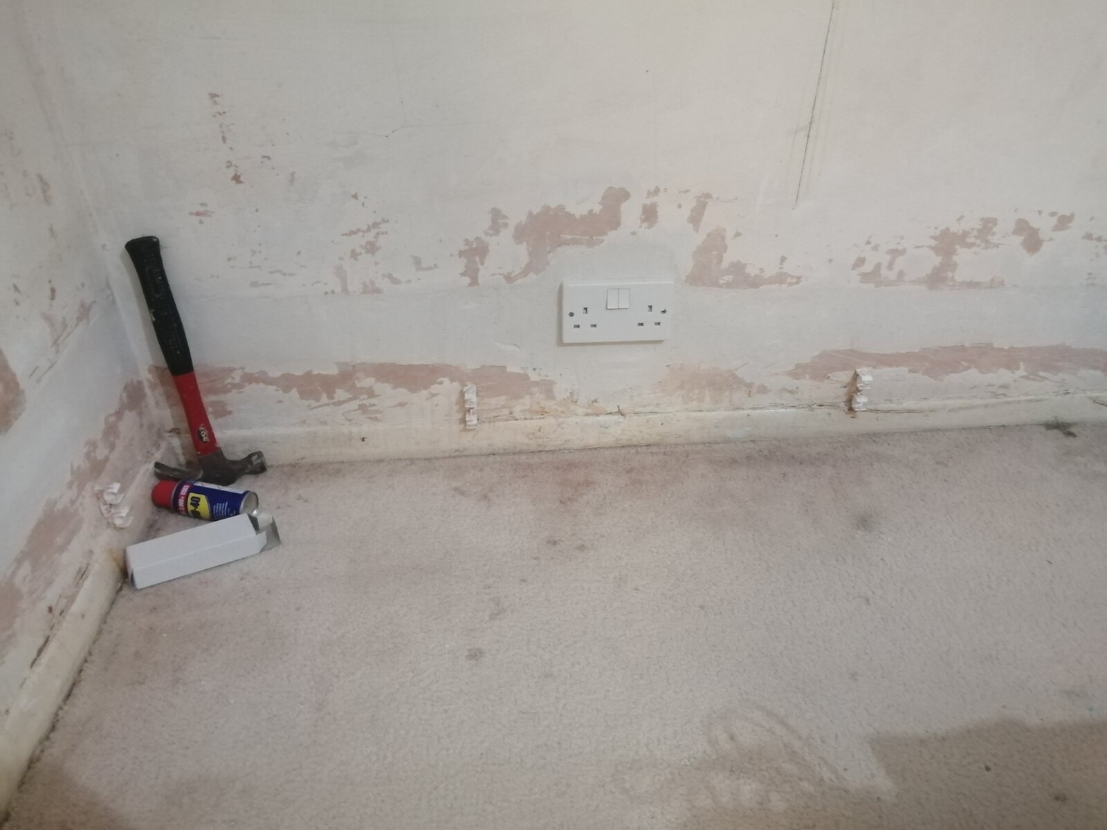

That's some of the bedroom chase that i done and as you can see from the last image their is some sort of loop from one Conduit to the other meaning that I could not remove the back box
The other photos are for the work that I had done which i had just capped the singles and one coat plastered them
Use T&E. one cable runs through that single box. The other cable that goes down, all you need is to make a junction in that box for three wires. Use Wago connectors. It’s not difficult.
