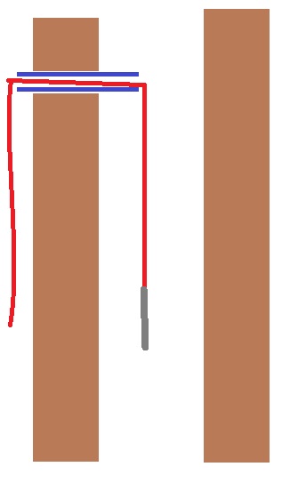

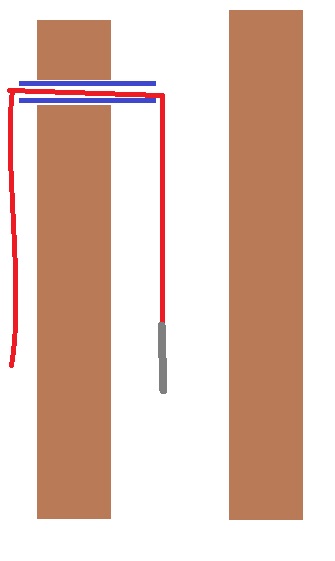

Not seen those, nice.You don't need to put a separate box next to the existing box as you can get 2&1 backboxes
andhaving the faceplates tight against each other looks much neater in my opinionDual 35mm KO Flush Box (1 x Single + 1 x Twin) | Green (GSK335D / DB3512)
www.tlc-direct.co.uk
Only trouble is it's fiddly plastering across the bridge. If you don't, then fittings can bend or crack (depending on materials) due to lack of support on one side. And/or you have loose fittings.
while it's a bit more work to go 35mm, the extra space in the box is well worth it.Yep, I've used those already in another post suggested by Murdochcat. I cannot find them with 25mm depth, so If I use 35mm I need to actually chase into the brickwork. I will think about it as it will indeed be much cleaner than just slapped somewhere above.
