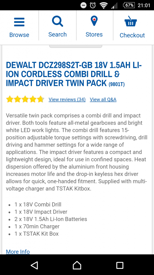

I've got a Bosch hammer drill. Used it for all kinds, pleased with it but it's a pain for small jobs, and the cords aren't particularly long so most of the time I have to get an extension roll out too. I was browsing today, and just now saw what looks like a nice offer on screw fix.
Two batteries and two drills, box and charger. Seems like a steal? Half of the ones ive seen, the batteries cost more than the tool!

1.5ah batteries arent amazing. Depending in how often and for how long you're going to use it. There's a formula used for batteries based on voltage and current, I can't exactly remember how to explain it but the lower the capacity, against higher the voltage the worse value and performance you're going to achieve. Therefore while more expensive, a higher capacity battery will deliver more at the point of use and over the life time of the tool as lithium cells have a suggested life span and amount of charge cycles before they're junk.
