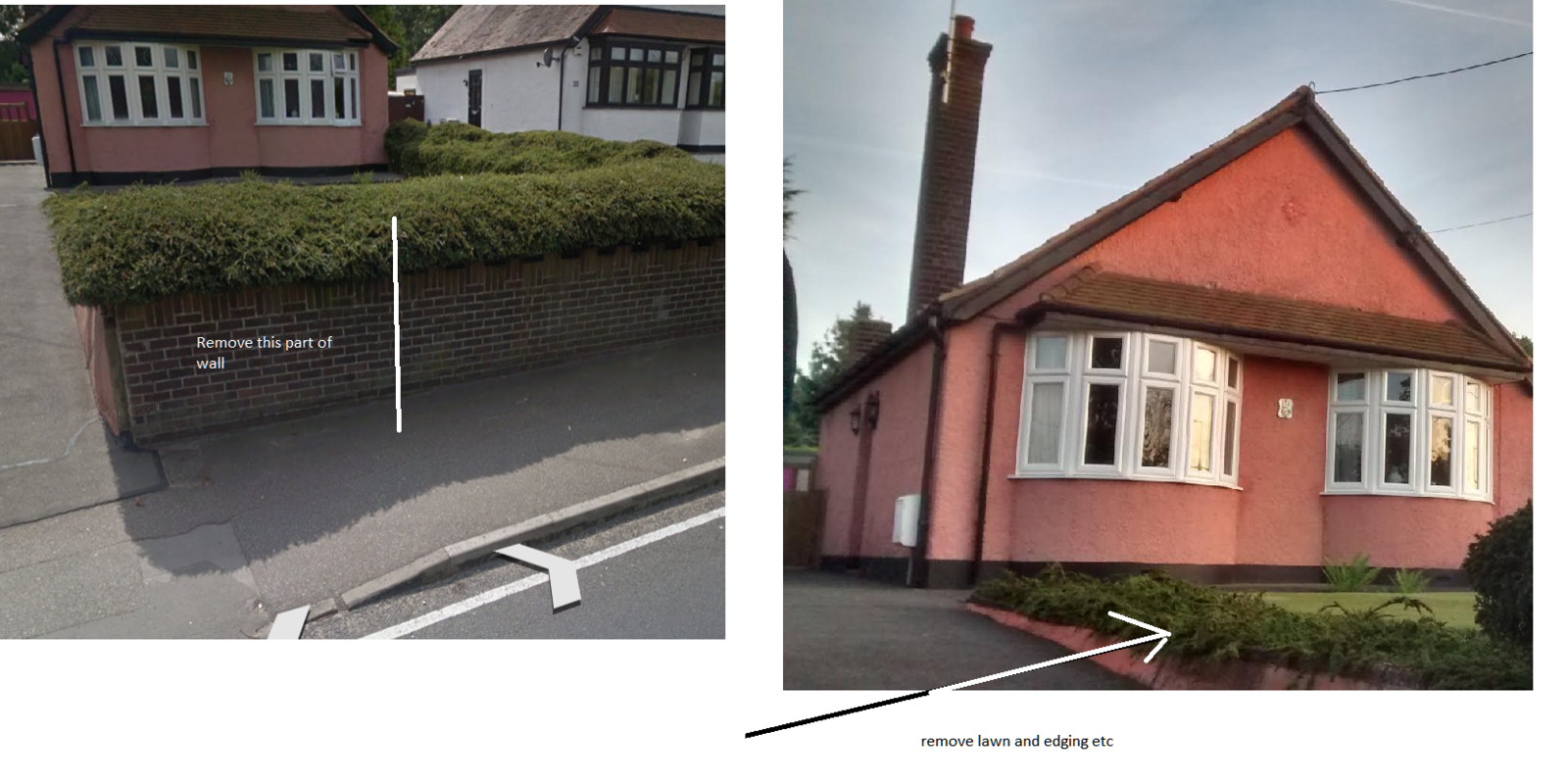

This is what I think I to do:
There is an asphalt drive (although too steep really, see other thread!) but OK if driving off, rather than reversing off.
So, the idea is to remove some of the wall (leave about half frontage as wall) and level the lawn area so its same height as existing drive. Although deeper is probably better, if I take out about 15cm, and have about 10cm of hardcore with 5cm gravel, will that be OK? Most of the gravel will be contained by the walled area, and if I am cunning, I'll leave a row of bricks at the bottom.... although, I am making this up as I go along, so probably a daft idea! I hope this will get around any planning issues re drainage, and be a lot cheaper (if a bit of a bodge) than getting it done properly. Also, if I find I have some spare cash in a few years, I can then get it done proper.

Gravel drives (with retaining rumble strip) are relatively cheap. We usually 'frame' ours with (solid) blue brick soldier headers laid flat. Build a rumble strip out of granite sets or tumbled paviors and fill in with (100-150mm) MOT then lay a maximum of 40mm of gravel on top. Any more and you will be swimming in it.
Some gravels 'bed down' better than others.
Gravel migrates and needs to be raked.
Weeds will grow INTO those areas of least traffic.
It is impossible to sweep rubbish (leaves etc) off gravel - therefore it will become compost and eventually produce organic growth.
We did one exactly a year and two weeks ago. I'll photograph it if I remember on my way past. Still looks ok and no weeds yet. He never rakes it either but the gravel bedded in well. I did put a strong geo-tex fabric beneath the MOT though.
