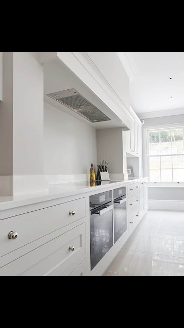

Just in the process of laying out the costs for the kitchen, part of which involves opening up a chimney breast to accept a range cooker.
I got a guy who installs log burners to come and quote the opening up bit but he doesn’t seem to know much about extraction as such. He said Obviously if you buy a log burner it will say extraction using an XYZ diameter flu based on the size etc blah.
I was going to get him to drop a flu down the chimney for some kitchen extraction but he couldn’t advise me what I diameter I need to drop down.
Can anyone recommend a decent extractor that I can install over the hob like the attached image?

Yes that’s fair enough ... just need to know what flu to tell him size wise. I can’t do that until I know what extractor I’m buying
I dont know much about extractors but would have thought if you had too much vertical rise without a pretty powerfull fan to blow the steam away it could condense in the flue and run back in the hood.
If that theory is correct could you go short distance vertical and then horizontal through the wall?
what extractor
Elica make a good range. Email and ask them to send you the glossy brochure, their website is awful.
Larger models use 150mm duct
If you use flexible duct, it will eventually become coated with greasy dirt and is impossible to clean. I suppose the grease may be a fire hazard. Condensation will drip down. Ask your chimney man about some kind of trap and drain so it doesn't drip into the extractor. If you have access to an external wall, a short rigid duct will be easier to wipe clean by taking off the grill and sticking your hand in with a sponge and detergent.

Can’t go out side ways as the Chinmey backs onto a party wall.
Don’t fancy ducting it all the way through the utility to the gable end
Must be possible
There's a long shot changce I might be able to get it through some flat ducting under the bedroom floor... I've got 58mm gap between the lintels
