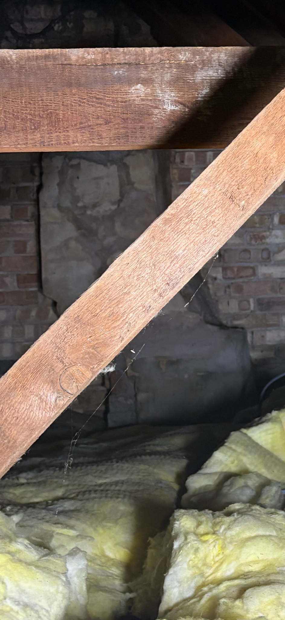

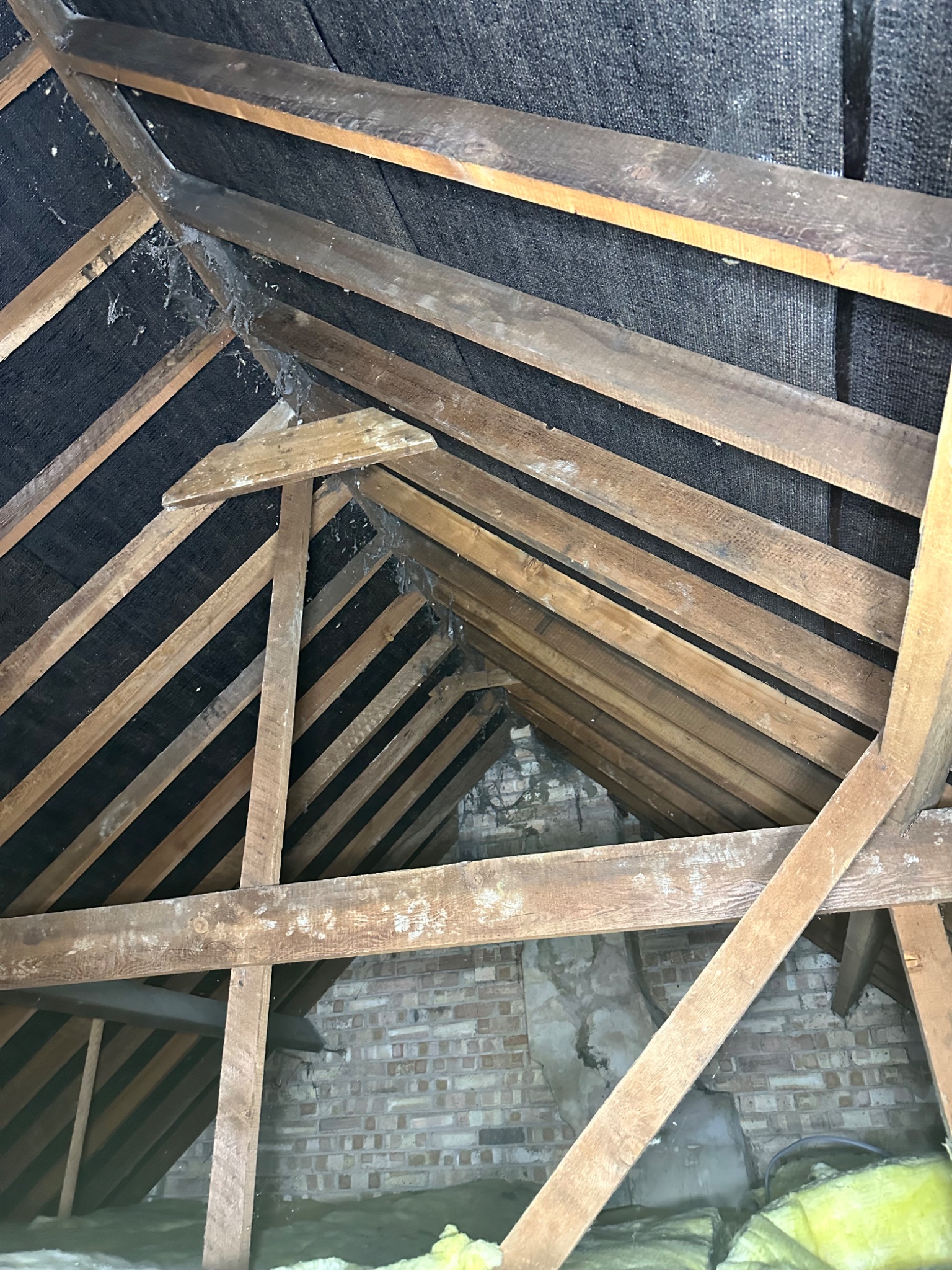

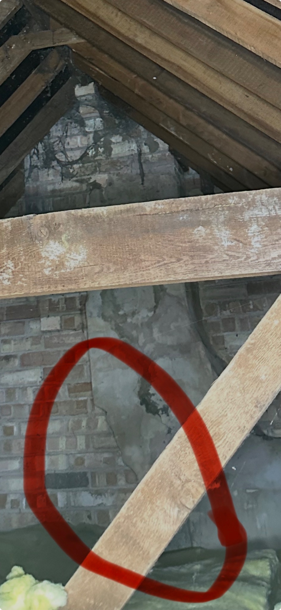

I’m sorry to be bothering you again. I’m a bit anxious about the chimney and flue in my loft. attached to a cavity gable end wall it comes down the wall at an angle that doesn’t look supported then the first floor goes down the bedroom wall at the opposite angle (thin to a thicker base) before going down to the middle of the living room on the ground floor.
All of the chimney breasts are still on each floor, all original from when it was built in the 1950s. I’m having sleepless nights worrying this huge hanging block could fall through the ceiling into the kids room
Does this look normal or does it need looking at?

As above. Typical corbelled chimney, diving over to exit the roof favourably.

Well I'll be controversial then...
It looks wrong. Has the left half been removed? I'm wondering if there was a left branch going down to other rooms. But I don't see any scars on the wall.
It would be unusual to have a fireplace in one room but not the other.
If half of its support has been removed then you're right to be concerned. Or it may have just been dodgy from the start.
Is it all yours or shared with a neighbour? Unless it's shared I'd think about just getting rid anyway, get rid of the worry and what looks like damp plaster in the room.

Yes, there are usually branches up to both sides, so it's balanced and fully supported.
I had a loft room as a kid, I had that giant upturned funnel on one wall with weird shaped alcoves either side. Some loft conversions even have a little triangular alcove under where the two branches meet.
I've never seen one like this though, where there's only support on one side and nothing under the other.
Obviously it's tied into the wall. But that has limits. A chimney is a blooming heavy lump.

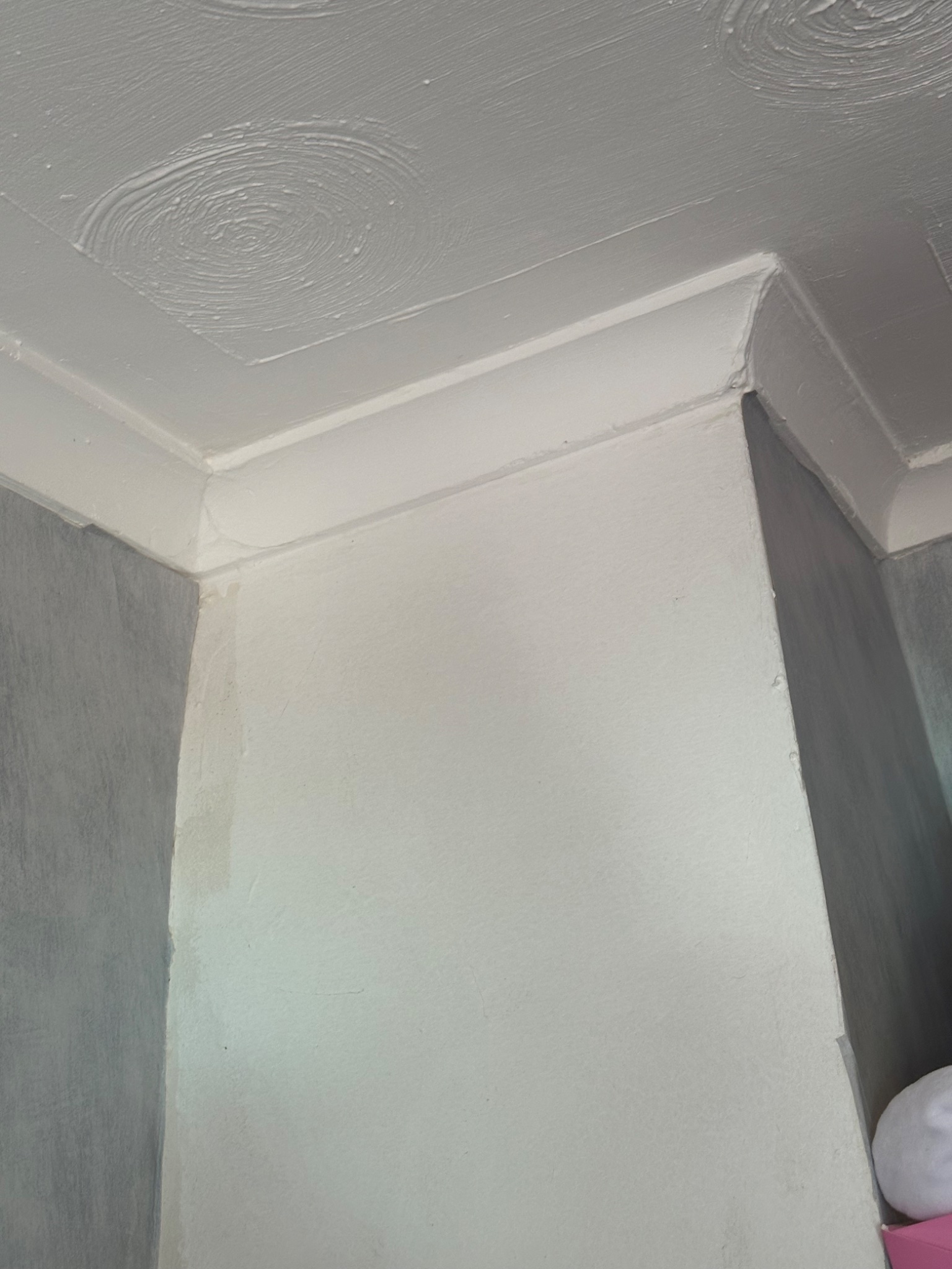

Hi thanks for replying. There’s been no chimney breasts removed. What’s in the loft is original. It comes down the corner of the room upstairs then across to the middle of the living room. It’s a gable end wall so nothing the other side. When you say damp on the plaster so you mean where the wallpaper meets the chimney? If so that’s wallpaper paste I’ve just not got round to repainting it yet

The chimney breast is the loft doesn't look wide enough to me where it travels over to contain 2x9 inch flues, although the stack above does. It might have had some brickwork removed in the past, possibly to get a liner down it.
If it has been standing since the house was built, then surely there's nowt to worry about? Structural engineer would have spotted an issue imo.
It's had some brickwork removed to get a liner in after a series of chimney fires, although the brickwork under the left side of the stack has been supported by a 9inch corbel, so it seems to me like it's safe enough. You might get an inexperienced SE say that it's not technically correct as you shouldn't bring out a corbel more than the thickness of the wall, and want some extra work done, although I'd guess most would say it's all good.
This is a slightly closer photo of the bottom where it looks like some bricks are missing, I hadn’t even noticed it until today. A new liner was put in 30-40 years ago but I’m pretty sure since then nothings been touched there
