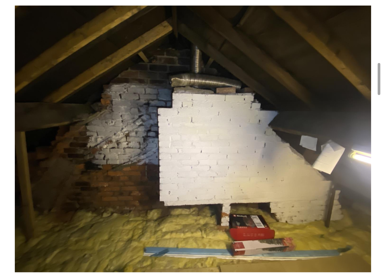

I am in the process of buying a house and the rear chimney has been completely removed sometime in the past however, the front chimney remains and it has been left like this in the loft (image attached). Does anyone know if this support is done correctly or is this likely to be a problem to the structure of the house?
We have raised the questions with our solicitor regarding building regs as advised by the surveyor but i just wondered if this is done correctly or is it likely to come back as an issue and delay things.
Thanks in advance!

The picture looks like an exam question for surveyors. Wouldnt it be easier to remove the flue liner and the rest of the bricks which don't appear to be supporting anything else structurally. I assume the single brick pier is resting on a structural wall below.
Thanks for your reply. The picture is screenshotted off my surveyor report. So it appears the stack was removed but then the owner decided to install the flue to make it a working fireplace again, they then installed an electric one at some point, the fire place is currently covered over.
Yes the single brick pier aligns with the solid wall below.
I would quite like to reinstate the fireplace at some point, does the way the chimney in the attic look correct structurally?
Id want more support under tne bricks to avoid the cantilever effect but i guess if its been like tnat for years it is in balance.
Maybe you could fit joists from wall plate to wall plate and mortar in blocks at 90 degrees to add further support under the hanging end of tne bricks. Or remove bricks altogether and rely on the flue, appropriately protected

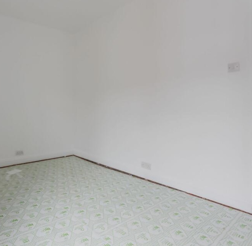

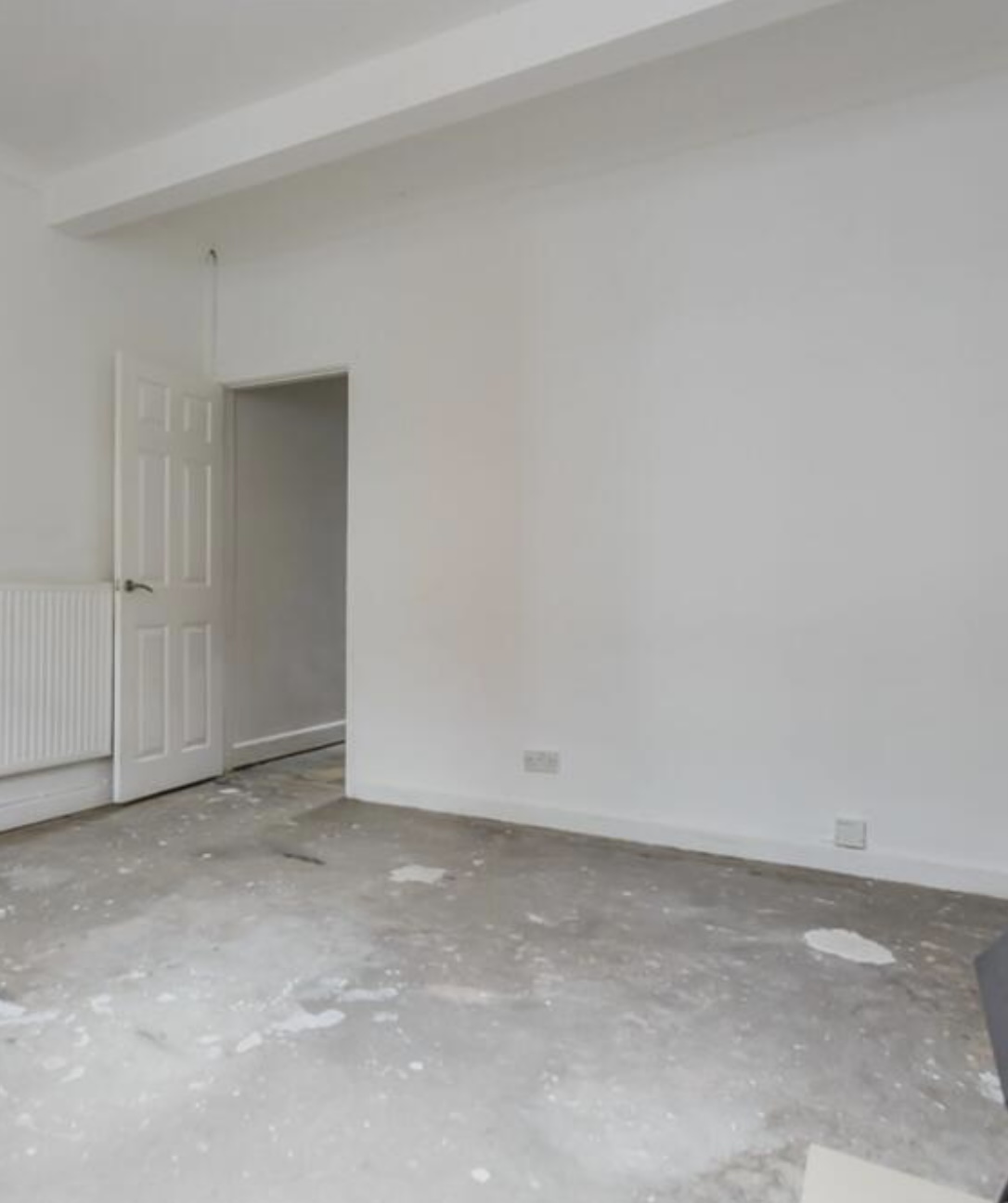

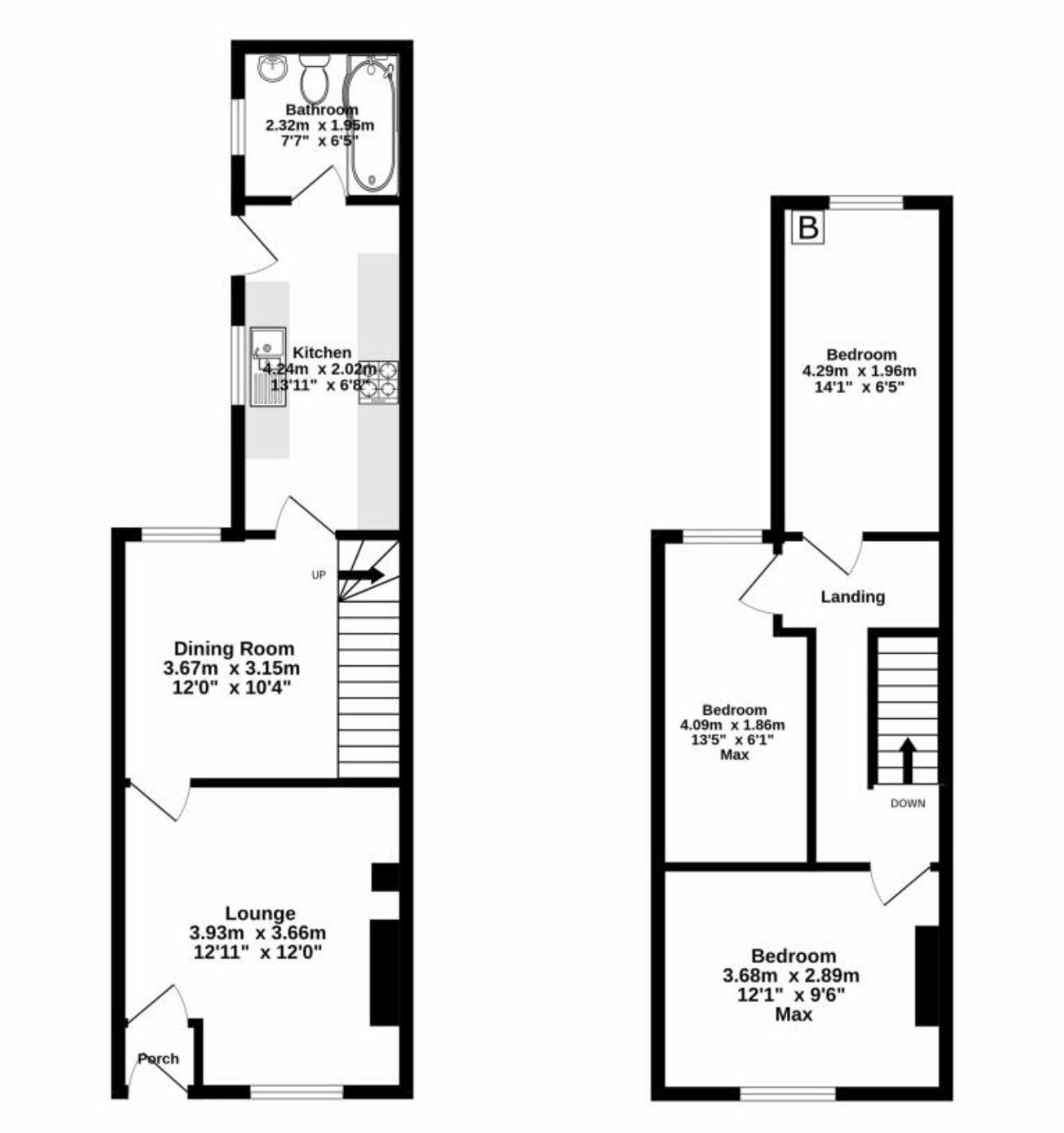

Thanks for your reply. The Survey i had done personally, the mortgage company didn’t want to do one. It was a level two RICs survey. The surveyor didn’t say the chimney itself was an issue just that the metal flue needed reconnecting and to check that the removal was done within building regs approval.
The floor sloping was just mentioned in the report and not flagged as an issue (this was green on the traffic light system).
I have attached the floor plan along with some pictures of the floor and downstairs boxed in beam where the wall has been moved.
The wall in the lounge was moved from the black square on the right backwards to where it is now. There is an additional support beam that has been added and is boxed in where the existing wall was removed. The sloping of the floor is roughly above where this beam is, it’s not hugely noticeable, you only notice because the skirting board looks higher in that part as there is no flooring down at the moment.

Sounds like the floor may have dropped when the gf wall was removed but if its been like that for years is it going to be a problem? Many older properties have sloping floors. Given what your planning it might be sensible to get a builder or SE to have a look.
Well this is more the answer i was hoping for, it’s been like this for over 10 years judging by the property history on zoopla so is it likely to be a problem? The surveyor did say this was most likely due to the wall removal in the past and didn’t seem worried about it and it wasn’t flagged as a major issue in the report or anything but i just wanted to be sure.
I wouldn't like to sleep under that. Is it sat on a concrete lintel or a bit of timber? I'd be amazed if its been passed by Building Control. If they don't supply the paperwork it's definitely worth something off the price (try saying a friend of a friend who's a builder says a couple of grand) - but the reality is that it's a weekends work for you knocking the bricks off and carrying them down to a skip.
There is what appears to be a long piece of concrete that goes across just above the single line of bricks, is this a Lintel? Does this improve the situation if it is? The problem is i wanted a log burner at some point, is it expensive to get a flue put all the way through if we take the whole chimney stack away?
I did have about 7k off the asking price, i did try lower initially which they declined. We are nearing completion and this has thrown a spanner in the works and i’m trying to gauge if it’s worth the agro of delaying everything further and with the mortgage company having to revise the offer etc.
Yeah. So if you've done the "discounts" to death and are happy to proceed it's not a big deal to remove it (as a minimum the section of masonry to the left of the central pier). As for a wood burner, you'd just use a suitable proprietary (twin wall or similar) flue system so it wouldn't affect that.
