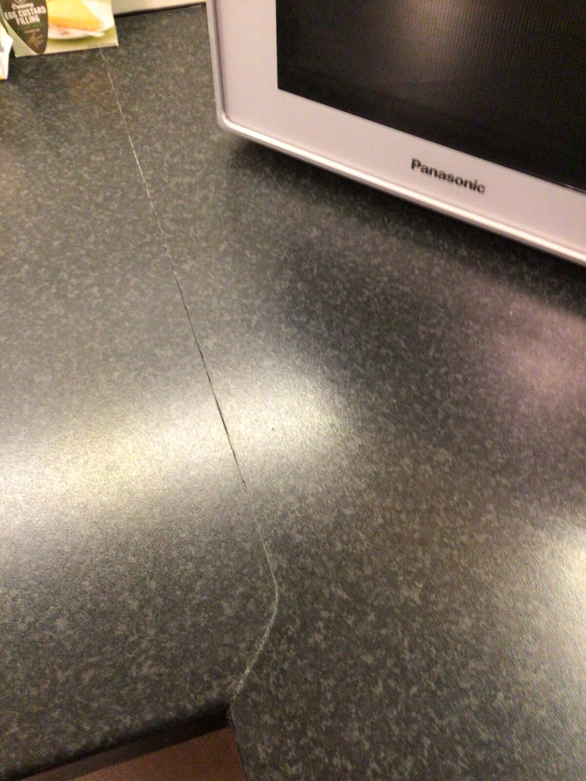

Chips on New Kitchen installed
Why did you let him through the door today? The more he does the more expensive it will be to put right

I'm not a kitchen fitter, I'm not a chippy, I have never joined a worktop myself - I'm a DIY'r.
Yet I'm 100% sure that I could do a better job than that - for all that you have shown us.
I’m not a chippy or kitchen fitter but my joints are far better than the one’s your guy is doing.

They look like jigsaw blade marks as he came through the face or using the wrong type of blade. glad to hear hes sorting it out.

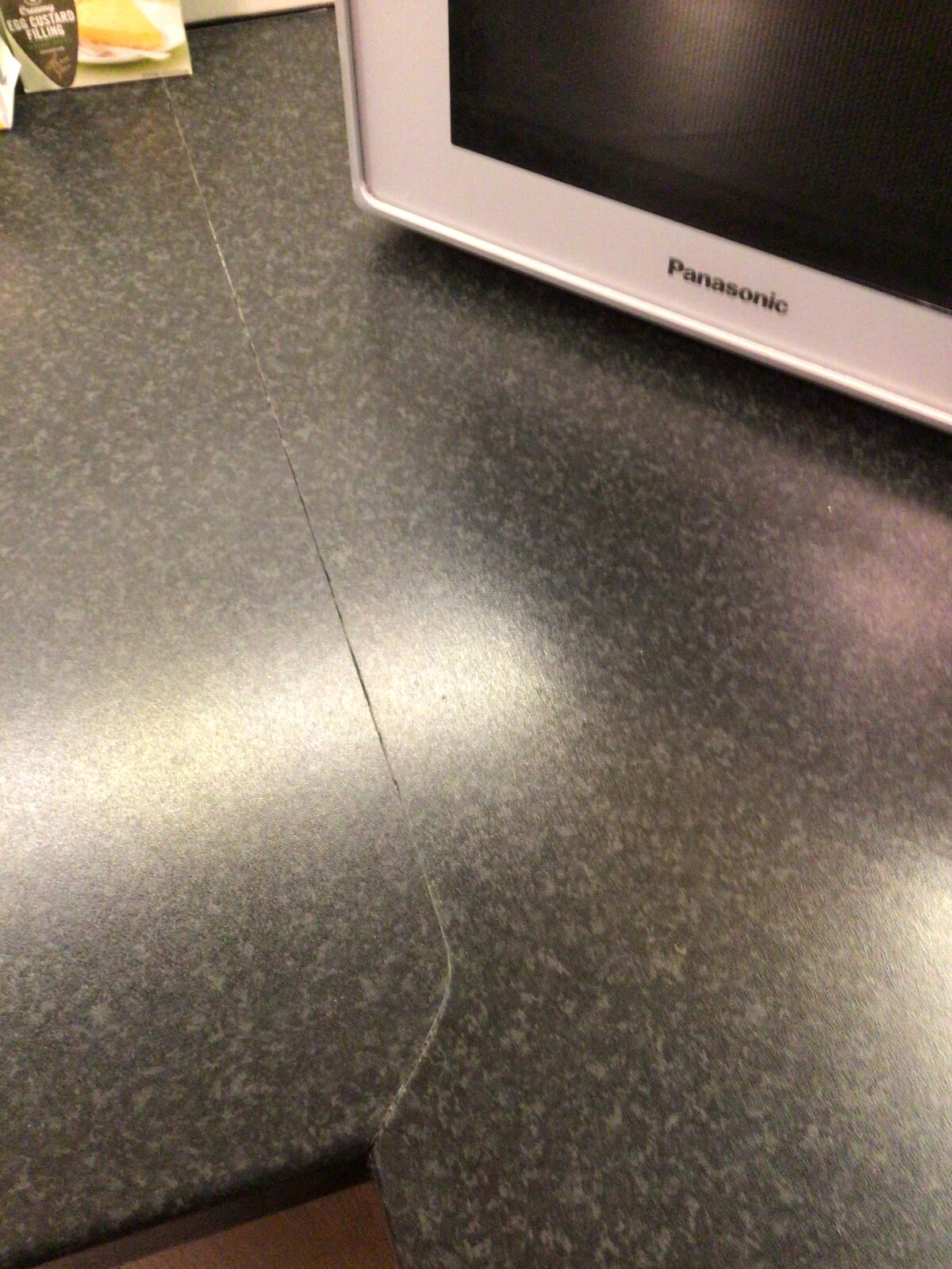

This is a good joint, maybe with a good router bit would've been better.
Why didn't you use the colourfill in it?
It would've probably become invisible if you did.
agreed , it’s a competent joint , it’s just not been clamped properly. I biscuit joint them as well . gets them 99.99%
