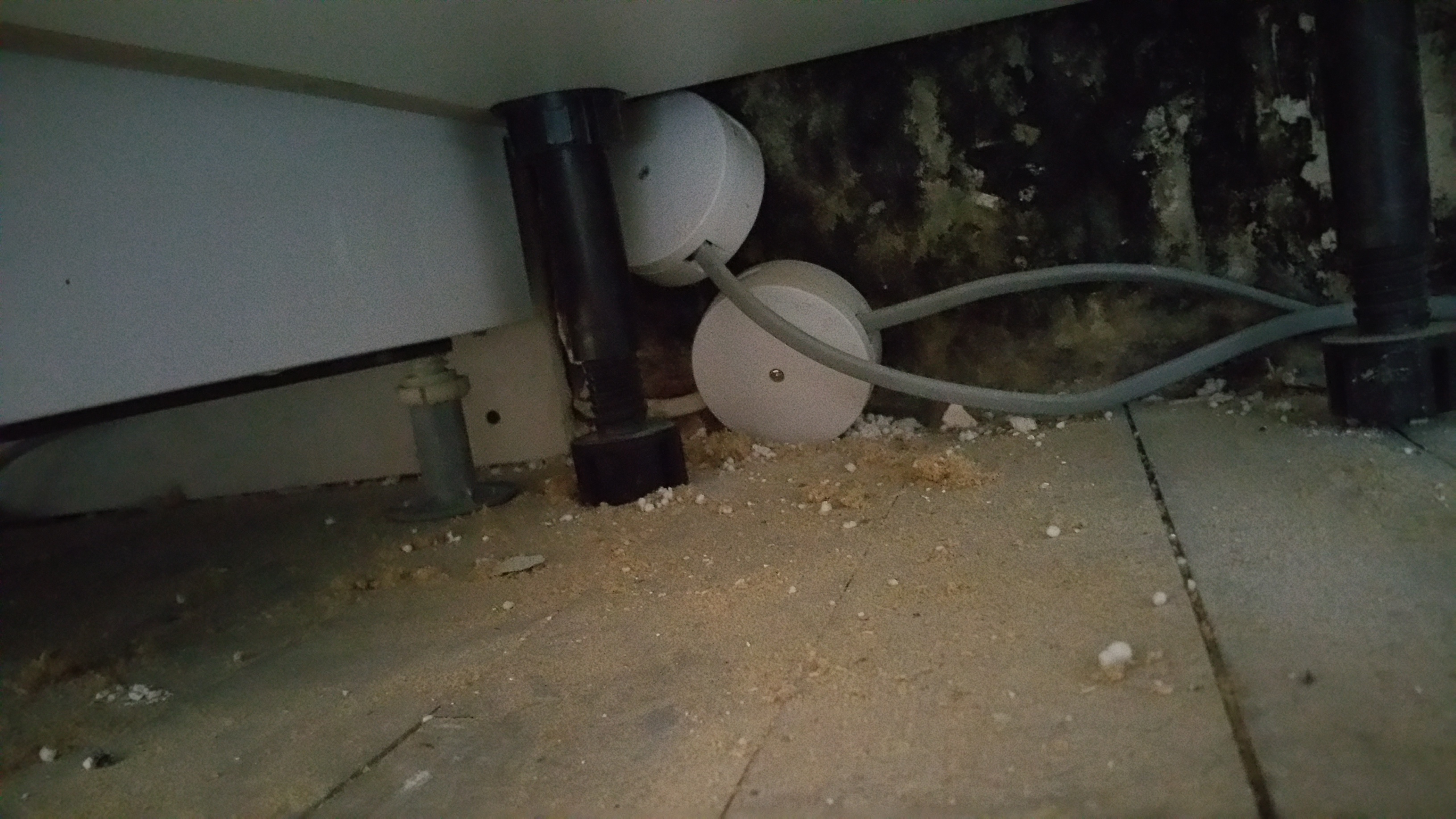

This morning we found that plasterboard has been placed directly over some mould.
My house is an old victorian school.
I would of assumed that when taking the old kitchen out- the kitchen fitter would of instantly seen the black mould on the outward wall?
Im not a builder but even I know that it should be investigated and if need be I would have to pay the additional costs to fix the problem.
However, I wasnt told and the fitter has fixed plasterboard over some of it and left the rest exposed. The fitter says he has fitted hundreds of kitchens.
I hope you can see the mould and plasterboard in the photo?
can't see bugger all in that picture.
Sorry. I'm not having much luck uploading the photo's
Basically it is a shot of under the base units.
Of what can be seen to the right is the wall covered in black mould and the plaster starting to fall off.
To the left is some plasterboard placed over the mould.
I will try to upload the picture again.
Hopefilly this is more clear?

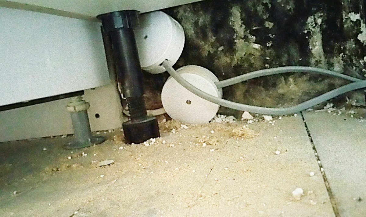

pretty bad, although that looks like internal damp, was a sink there before? I would probably have liked that to be sorted before having a kitchen installed against it.

I've managed to upload a brighter photo.
This is the external wall. There was no sink on this wall before.
I agree that it should of been investigated before the kitchen was installed against it.

Looks like the twin & earth from the bottom JB goes behind the plasterboard.
If that's the case, it travels along the wall, and it isn't 'mechanically protected', or >50mm deep into the wall, then your electrician (I use the term lightly) has failed in complying with the 'safe zone' rules.

May I ask?
Are the cables that have been trailed along the floor into the sockets within the 'rules'?
There isn't much of a problem with the cables left loose under the units. They're not likely to come to any harm, and anyone doing any alterations can clearly see where they are.
It's more to do with cables that are hidden. Someone could drill into the wall not expecting to go straight into a live cable ... or even slice through a cpc (earth wire) and not realise, therefore causing an unknown risk.
