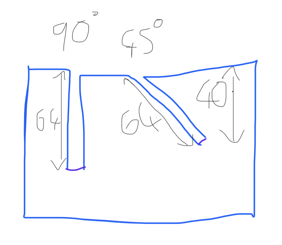

what does cutting capacity 90 degree bevel mean? or to put it another way, what depth should this saw cut if you are simply trimming the bottom the door? thanks.
It means if the saw is in a vertical position it will cut through 64mm. If the blade is rotated at all it won't cut through all the board

If you put a piece of wood 65mm on the saw it will not cut all the way through it; the blade only sticks out of the bottom of the saw by 64mm. If you put a 65mm thick piece of wood on the saw and cut then you will have a single piece of wood at the end, that looks like two blocks of wood joined by a thin 1mm strip at the bottom of a narrow gap between the woods
"At 90 degree bevel" means "when the saw is tilted such that the blade is vertical relative to the bed on which the wood you're cutting sits. For saws that tilt over to eg cut a 45 degree slope into a piece of wood, when the saw is tilted over it can't cut as thick a piece of wood. If the saw blade sticks out 64mm tilting it over to 45 degrees means it might make it through a 40mm piece of wood
The blue is the wood, approx 100mm thick. The diagram represents the side view of the wood after it has had slots cut in it at 90 and at 45
