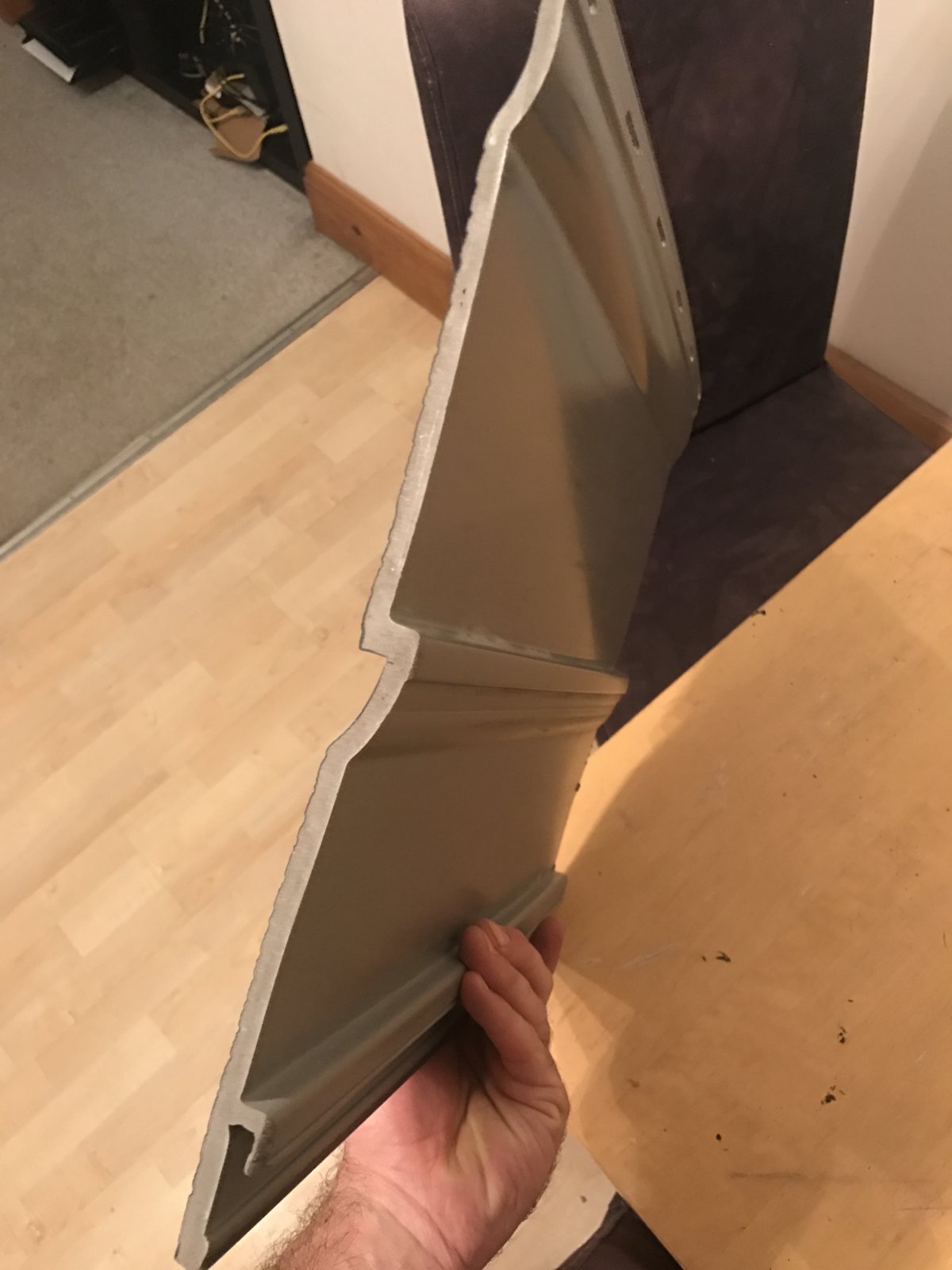

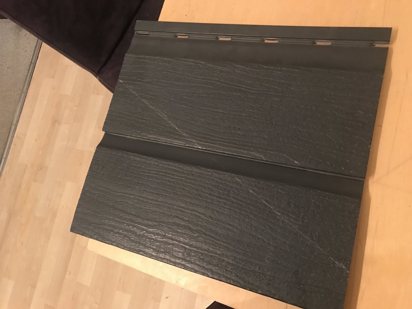

This is the sample of Fortex (or similar) double plank that my builder gave me:
The Cedral looks better on google images.
Actually, the one above is from Eurocell, this ones the Fortex:
It's very similar

Decisions, decisions!!! He has priced me for the Eurocell doubles but the Cedral does look better without the smooth/gap bit.

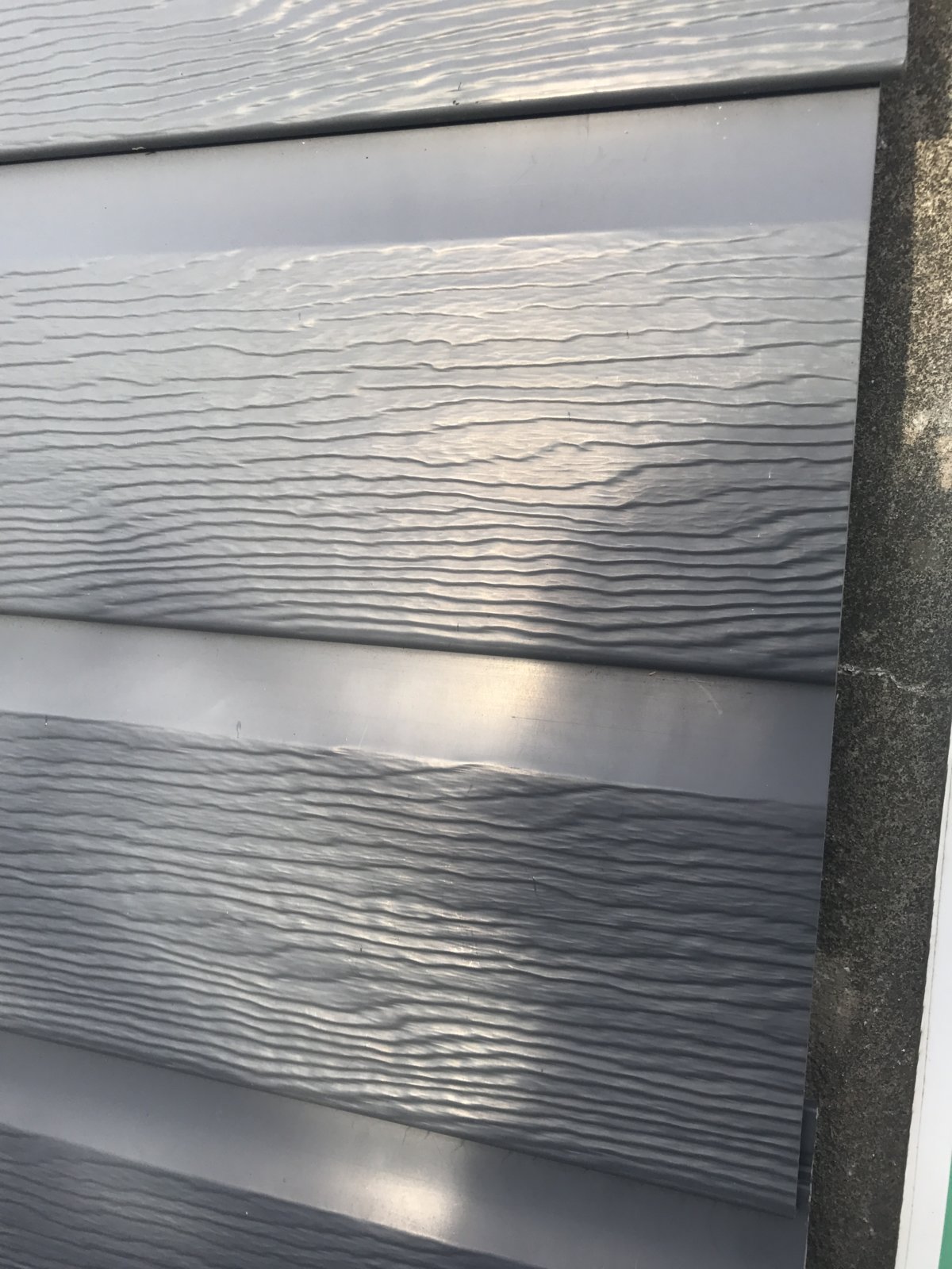

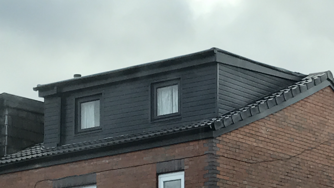

They have already done those:
I went to a job of theirs that they did with the Fortex, I'm going to drive past this morning and have another look. I've got the offcut in my hand but I'll never be closer than 5/6mtrs to the dormer.

I drove past another that looked like smaller boards but I think it might be the thin soffit stuff
Looks like normal cladding to me on my phone screen. fortex do singles they cover 170mm I think..never seen the deeplas. But probably won't be cladding much in the future ,
