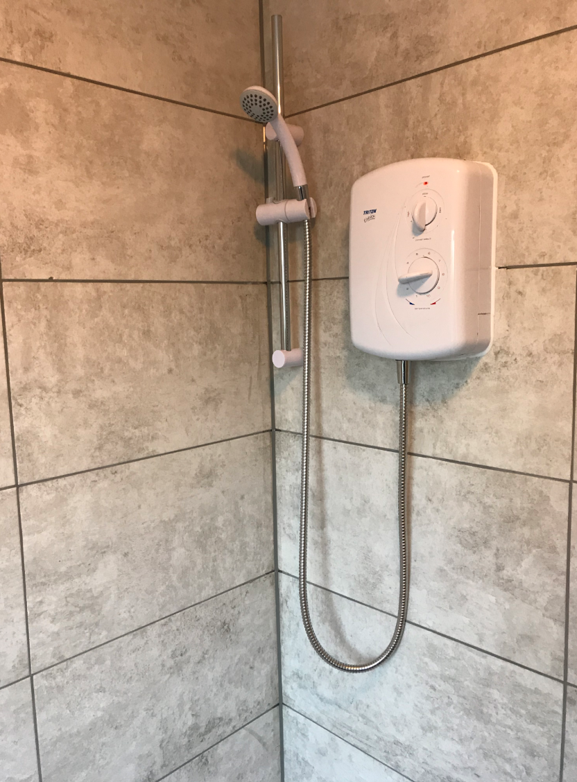

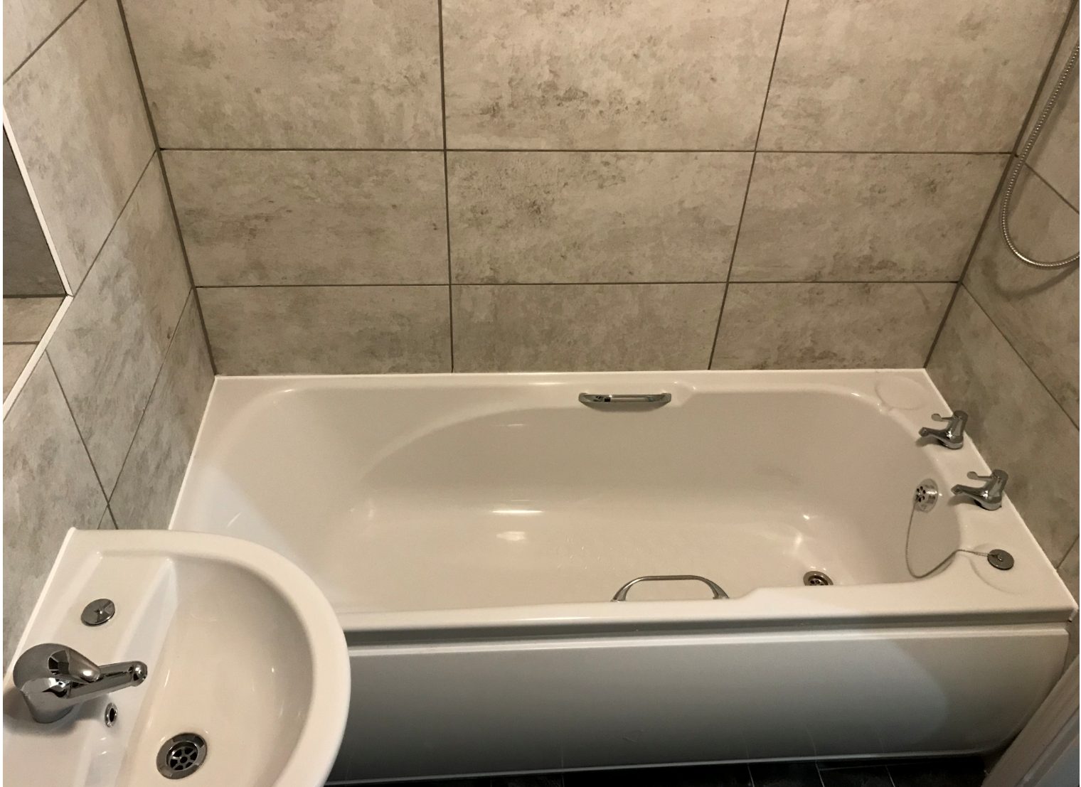

I've attempted tiling a few times now and feel that I have done a reasonable job...
I do enjoy the planning that goes into it. Here are some pics in a moment of self gratification :)
I have two questions if I may:
1. I always struggle with wiping adhesive from between the joints whilst it is wet as well as adhesive that may spread over the surface of the tile. I find that adhesive seeps out of the tile joints when fixing the tile to the wall and by the time I have put in the spacers - often multiple on each side with a tile this size - and levelled the tile, its not easy to wipe it clean, especially within the joins. I end up doing this once everything is dry and it takes long and risks damaging the tile, when I am using a screwdriver to scrape this out ahead of the grouting. I'd appreciate your tips with this please.

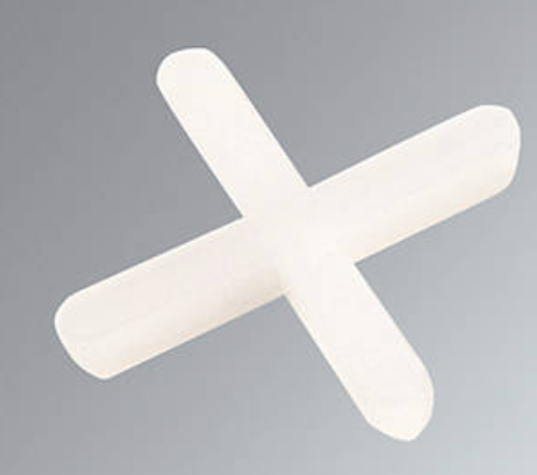

2. Secondly, I always use this style of Spacers:
Is this the right thing to use or are there more effective alternatives?

You need to keep a sponge with you and a bucket of water.
Once you stick a tile, position it and wipe it clean, then place the spacers (you only need 2 per side).
Anyhow, you should place the tile against the ones already on the wall and then slide it away into position to place the spacers.
That way you won't have leaks through the joints.
hmm , it’s about getting the right amount of adhesive on the tile or wall. if you use the correct notch depth for the job you shouldn’t have a problem.
i run the tip of my thumb around the back of the tile to remove all the adhesive off the perimeter around 1/2” in before bedding it.

At the end of the day Jupiter, that looks like a mighty good job and you should be well chuffed! Well spaced around the bath, unless you were bloody lucky!
Personally I like to use chrome trim around the window reveals, but that’s nowt.
