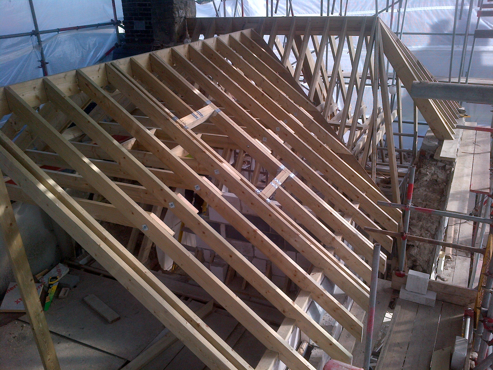

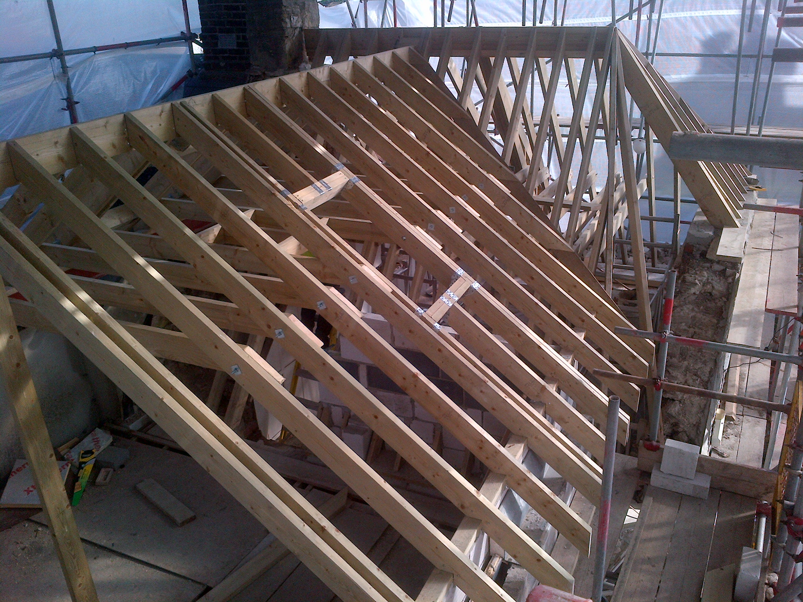

Yes but you can get that same with timber? this is just a steel ridge beam and a steel rafter
How would you join the two timbers? That steel frame works because of the welded rigid joint.

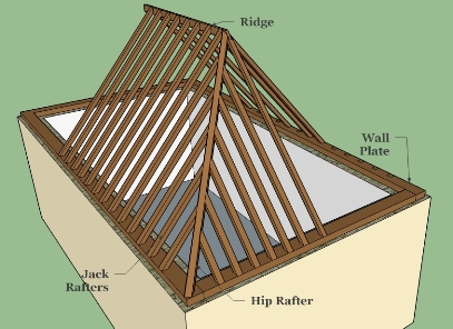

even know its a vaulted ceiling, you could still replace that steel structure and still have normal timber rafters which could support a normal ridge beam and hip??
yes its vaulted so need to restrain etc but the steel in the photo offers no benefit that i can see versus doing it in timber is all my question is
How would you achieve a rigid joint between the timbers? One that could be calculated.

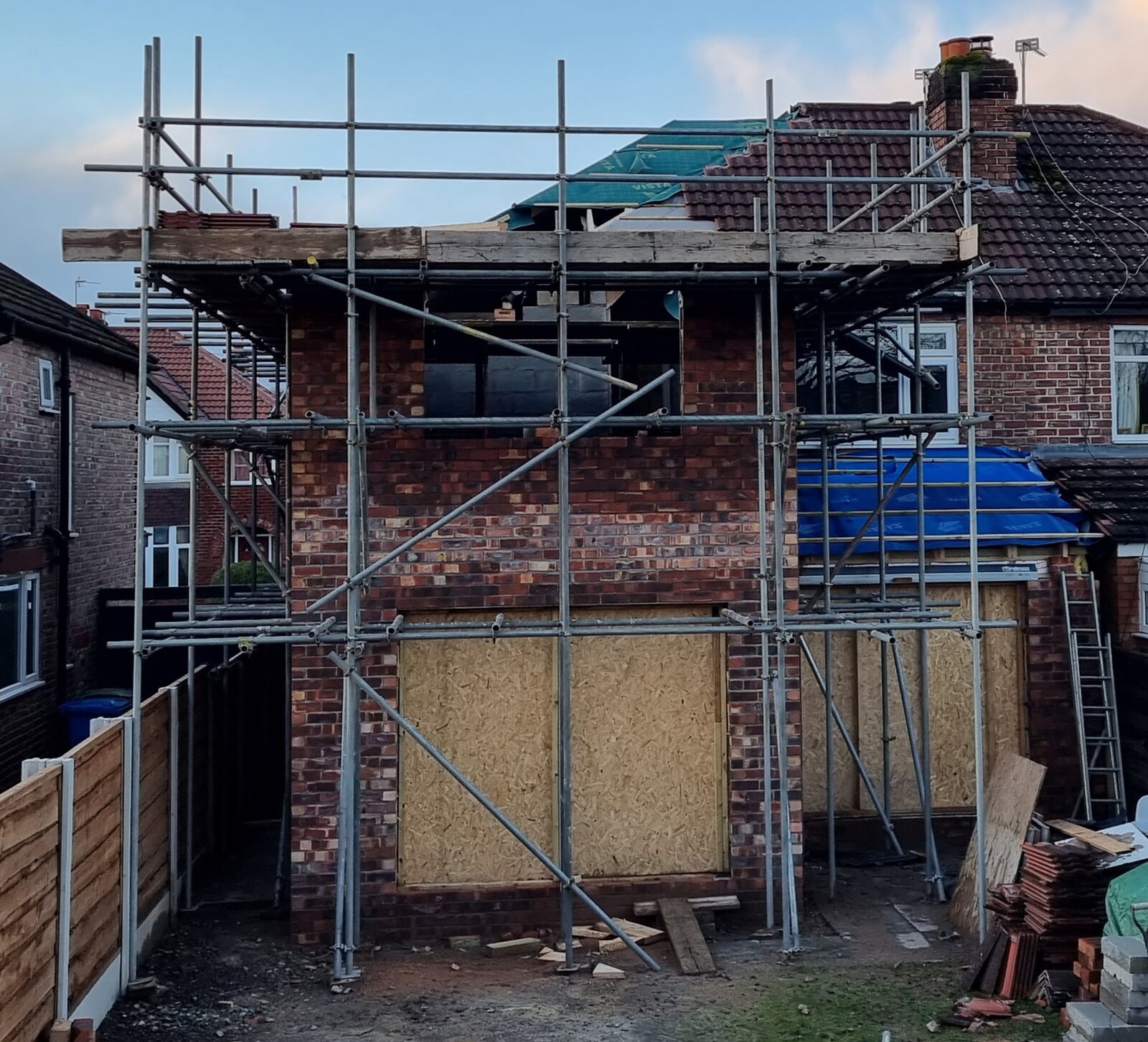

Thanks, yeah its a vaulted ceiling. Been told that we need to padstone the internal wall to replace any load on the hip rafter, and we need to split the timber wall-plate and padstone above the window.
Who said you have to split the wall plate to padstone the bearing - SE or building inspector?
If the load is not excessive, its perfectly OK to seat a steel beam direct on the wall plate. The timber design codes give allowable bearing pressures on timber members perpendicular to the grain.
A 102 wide beam seated on a 100 wide C16 timber wall plate will support a load of around 20kN without the timber crushing - a little more if the beam is supporting a roof. This trick is often of use in loft conversions, where there is a lot of timber studwork which might be required to support a steel ridge beam.
If the load is a little more than the maximum allowed for the timber, you can slip an offcut of steel plate 12.5mm thick under the beam as an enlarged bearing plate = like a steel padstone.
