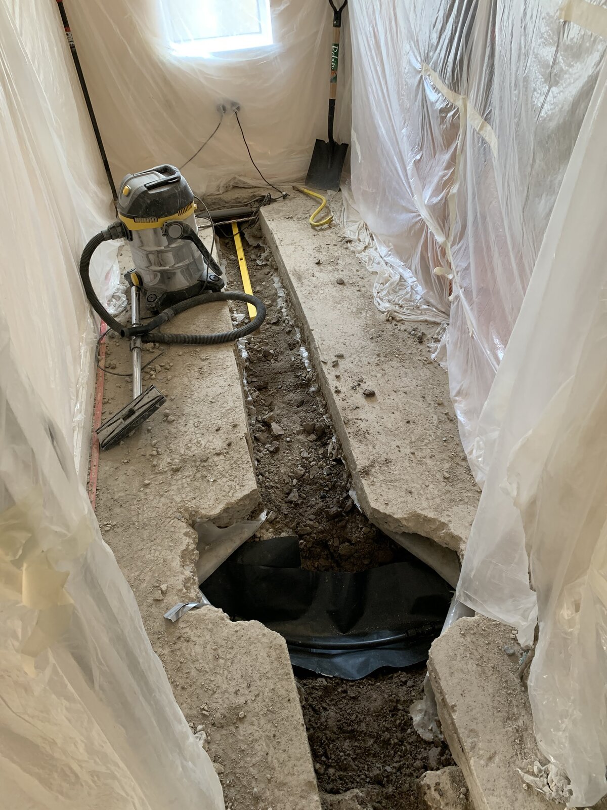

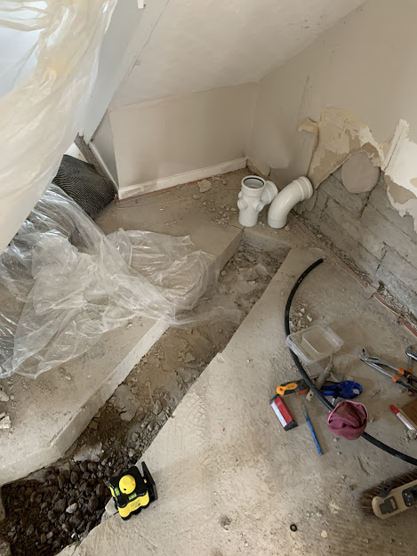

so iv made a lot of progress. trench is well and truly dug now. (pictures attached)
you will notice halfway through the trench, despite all of my efforts to locate and detect pipework prior to works, i hit a mains feed into the house. So that was a lot of fun and a scramble out to the road to stop the flood (n). Withe the help of a plumber friend and two trusty philmac couplers the mains feed has been restored and hours leak free so far. Not in a hurry to concrete this over until satisfied that those joints are sweet. the secondary issue with the mains feed discovery was that it was right in the way of where the soil pipe is meant to go so i dug an extra bit down and to the side to remove material beneath the pipe to allow it to flex very gently over a wide radius to naturally now go below the soil pipe-to-be. So as far as im concerned that setback has now been resolved.
Im sure ill have a few questions over the next couple days but the immeidate question is the order in which i should be backfilling the trench.
Is the damp proof membrane the first thing that goes down on top of the photos you see attached? whats the best way to try and integrate the new membrane with the edges of the old? would you ever suggest trying to overlap and tec7 them/seal them together as much as possible to try and restore fully that moisture barrier?
generally after that, what is the order of backfilling and supporting the soil pipe from here? i have gravel, builders sand, hardcore and plenty of rubble big and small from digging the trench? and then how thick should the top layer of the concrete be

Pipe will go beneath the DPM I am assuming?
Pipework ideally needs bedding in peagravel, I'd also haunch it over the top of the pipe. If room, then a thin layer of sand, (unless there is several inches to make up, so to economise on sand, selected material, (no lumps or large stones/bits of broken concrete), then a thin layer of sand), simply to protect the DPM from any possible punctures.
You haven't a lot of room to play with by the look of that, but your replacement DPM needs to overlap the existing as much as possible, then concrete/screed on top to meet existing finished floor level. Needs to be same thickness as the existing to maintain the strength of the floor.
@Hugh Jaleak so the original layer of DPM is below the 6 inches of concrete there originally. For the most part the soil pipe will be above that level, with the exception of near the exterior wall where the fall takes it below. Does it make any sense to have a DPM below the soil pipe as well?
I had thought i would try and connect new DPM to the old as best as possible and then another layer of it right before the concrete? It will be near impossible to tie the new dpm into old ABOVE the pipe. do you understand what i mean?
by 'haunch' do you mean just build up the gravel to level near or covereing the pipe?
also since the original concrete was 6 inches think theres no way I can restored the slab to that level of thickness. I will have minimum of 2" (at toilet end). My thinking was that it might be better to have 2" of concrete the whole way along the run rather than it getting thicker towarrd the end of the run where theres space. Does that make sense or should i let it thicken as it goes down the run?
For replaceing concrete slab like this should it be a C20 or C30 concrete mix?
I think you're governed by the invert level of the existing drain which doesnt help matters. I'd be wanting DPM at or as near to, the level of the existing for ease of tying it in, for belt and braces, another layer will not hurt anything. As the drain needs to run above theDPM then so be it, but usual practice is to haunch over with concrete if drain is hallow to provide as much protection as possible. 'Haunch' means to bring up the material to hold or cover the item your installing/laying and prevent lateral movement.
I'd use C20 concrete, you need the extra strength, especially with a drain below it. Let it thicken where possible, for the same reason. Too shallow and you may risk it cracking.
since writing earlier I have looked closer and it looks like I will be able to (in as best as possible where its torn by trenching) restore the DPM to the original ABOVE the soil pipe by slight arching its path across. So for the most part the pipe will be under the DPM.
