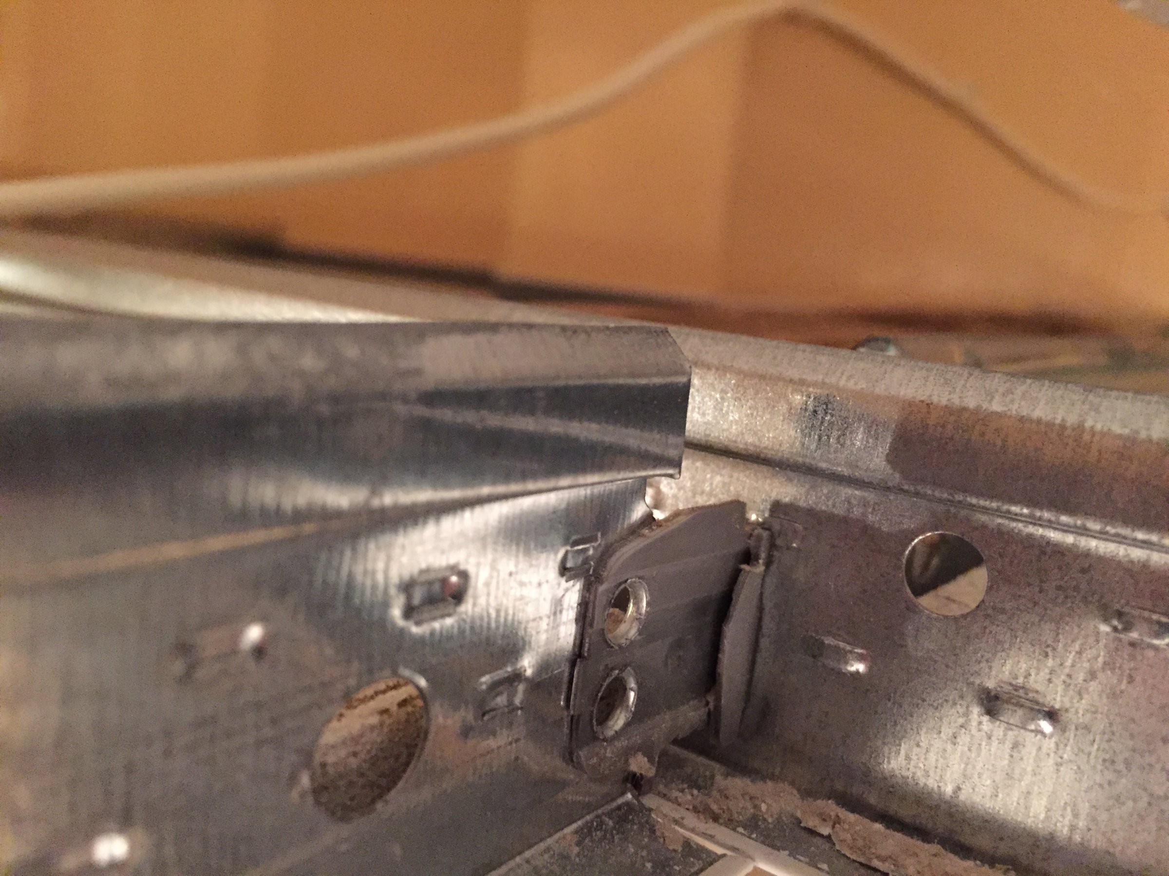

To bond every cross bar will be an absolute nightmare!!
LOL. No just connected to the grid once in each room. You don't have to do each of them.
The suspended ceilings I have seen will not be effectively earthed with only 1 connection, that connection will only earth one lengthways run, the runs either side will be isolated owing to the plastic clips on the cross bars.
I haven't seen any suspended ceilings with plastic clips on them....All i've ever seen is this design, being all metal (bar the tiles of course - unless they're burgess and then the grid's different anyway)
