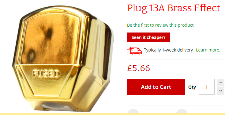

You can still have metal sockets if you want them. Personally I wouldn't as there are no matching metal plugs.
True (at least, I've never seen any). However, if it's appwearnce that concerns you, one can get 'metal effect' ones. For example, if one had brass sockets, one could have something like ...
