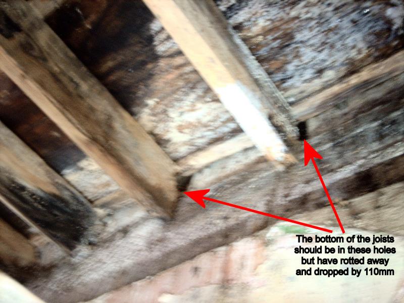

Hi, I have a bit of a problem and am hopeful the god folks here can give me some advice.
The upstairs neighbours has a balcony above my kitchen (kitchen at ground level), The joists (180mm depth) on one side, holding the balcony floor have rotted away and dropped by 110mm.
I am (was ) going to replace my kitchen because it has been dammaged by damp, which i just thought was due to the age of the kitchen. It was only when i got into the crawl space between those joists and my kitchen ceiling that i noticed something dire was up. I have taken my ceiling down and placed acrow props to support the balcony joists .
Now the bit i am concerned with,
I have told my neighbours wife that the balcony was about to fail, she said she would inform her husband and get him to pop round so i could show him. Two days later he had not been round so i knocked again and asked if he was in and she said he was at work and busy . The thing is , i would have been round like a shot to get things sorted and i get the feeling they are in no hurry. Any advice is welcome, cheers. Staffo.
...............The joists (180mm depth) on one side, holding the balcony floor have rotted away and dropped by 110mm. ....................................Now the bit i am concerned with, Who is responsible ?
Am neither a specialist in carpentry nor rot, but to drop that amount and not further sheer or snap, baffles me..... (Doesn't take much :LOL: ) Is the appearance of construction misleading, are the joists cut into the horizontal? Seems a long way to drop and remain in place..
Having had another look, I might be talking rubbish. I can't make it out from the photos... sorry! Unless the rotten timber has been crushed by sound timber?

Hi Colin I have included the links below to the photos that show the balcony in a dangerous condition.
http://s22.postimg.org/u15rvczj5/Joists_drop_by_110mm.jpg
http://s27.postimg.org/jjazh1vqr/Joists_in_these_holes.jpg
It is a shame you were not able to come round as arranged at 7pm 07/07/2014 with your Father as i would have been able to show you in what a dangerous condition it is in, as such i would strongly advise you or anyone else not to walk on it. As you are aware that your decking has listed, it would be an indication that all is not well.
The Joists have rotted away at the ends and the balcony has dropped by approx 110mm. As far as I can work out it is only being held up by a combination of the joists inserted to the wall on the opposite wall 'canterlivered' and a couple of joists that are rotting but have not yet failed.
If the balcony were to fail it would cause greater damage to the brick structure itself.
I would suggest ACTION is taken sooner rather than later, you have my phone number please feel free to phone at anytime.

As you can see the cladding is missing from the wall, down the bottom of the picture above you can tell the angle the cladding has drop and the balcony continues to leak from that side.
In the picture above you can see the unconventional construction of the balcony . They have taken the old roof off, shuttered the walls and sat 75mm x 125mm posts (to act as support for the walls of the balcony) on the brick level that the previous roof joists were sat on, poured concrete 270mm in depth lifting the roof structure totally into their side of the boundary. They did this so that when they stepped out onto the balcony they didn't have step down too far.
Hi doug, I got a phone call today Saturday (30/08/14) from the property investment firms builder saying he would be here on Tuesday and planned for it to take three days. They will be putting a fibre glass covering on, doing away with the cladding and wooden posts and putting up a wrought iron balustrade. I will be taking pictures. After two months i am looking forward to this being sorted, The board that the fusebox sits on is showing signs of water marks :eek: . Fingers crossed, roll on Tuesday
