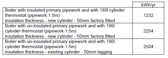

A guide to annual losses from a cylinder and primary pipework. From a field trial 10 years ago. Cylinders are available with better insulation now. Lag any primary pipework you can. A kw from natural gas is around 5p.
