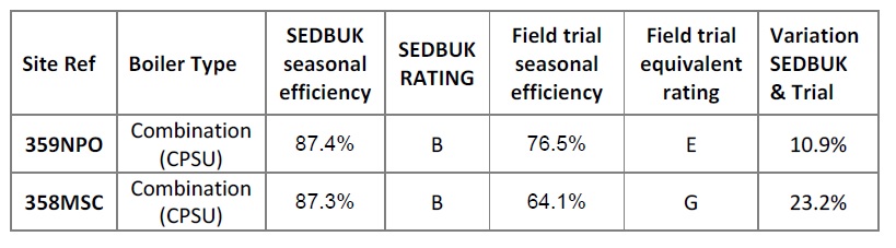

The BRE tested two highflow storage combis with A rated boilers and a DHW store over 50 litres. One had the equivalent SEDBUK efficiency as E, the other as G.
Better read some more brochures.
The Dept of Energy commissioned BRE who commissioned GasTech who certify boilers. They were two B rated boilers not A so condensing but not quite 90%
While we're on the matter of sources can you find something to back up your earlier claim I'm totally wrong?
