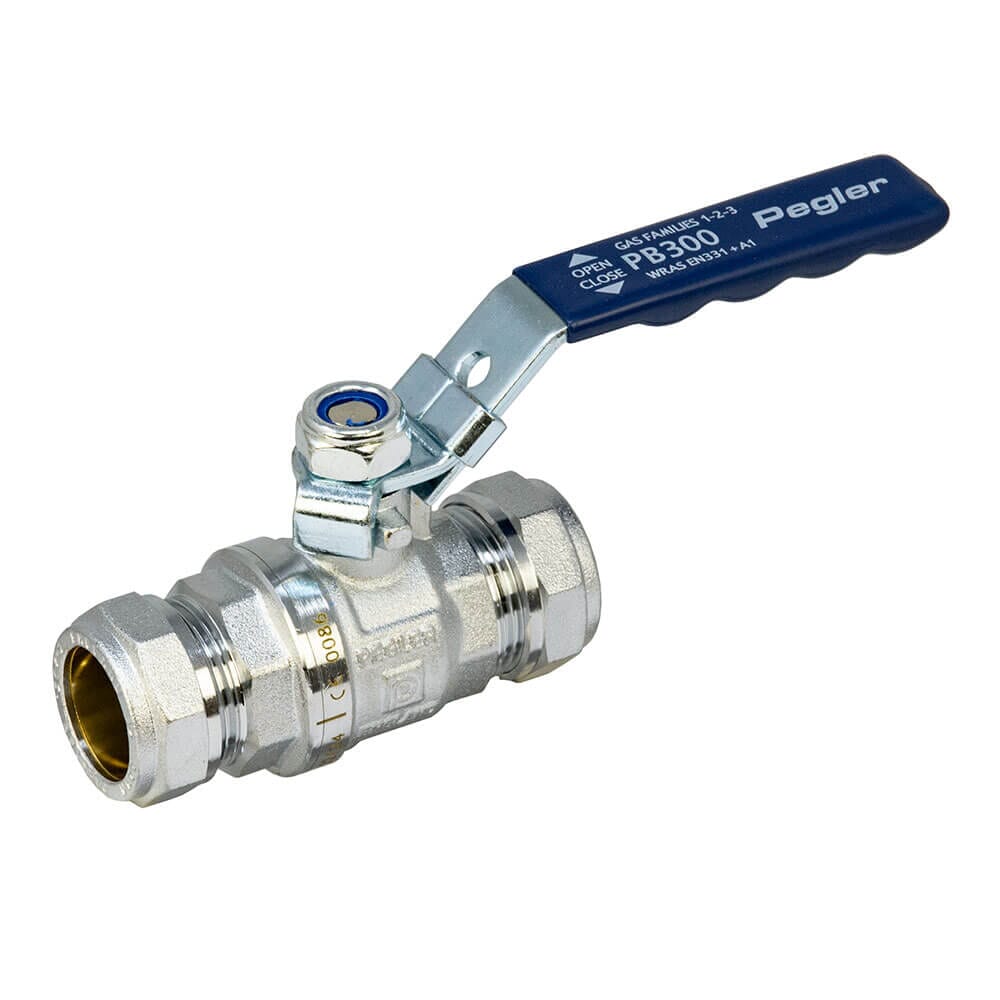

I'm trying to replace a faulty gate valve on a 22mm copper hot water pipe from a vented hot water cylinder. I've drained it down and undone the compression fittings but there isn't any play in the pipes (all welded joints except for the compression joints on the gate valve). In order to remove the valve I have had to cut the pipe as near to the olive as I can get. I'm replacing with a Pegler lever ball valve but now the gap between the copper pipe will be too big. Can anybody tell me how best to get the new valve in place because even if I cut a section of pipe and put in a longer piece I won't be able to get it in place without being able to push the pipes back?

Thanks Gasguru, that is exactly what I need. I've fitted a temporary stop end until I can get one of those.
Opps, yes I'm going through and replacing all my old gate valves with Pegler ones. Unfortunately there are 3 on 28mm pipe and the lever valves are about £35 each in screwfix :oops:

Is that the full bore PB300?
Seems to vary a lot in price.
Yes, that's the one. They are £34.54 in Screwfix. Thanks for the link - that is a much more reasonable price !
Not sure what the delivery cost is, but I did see that there some available via ebay and Amazon.
the following is only £17- with free delivery if you have Prime, but there is only one in stock.
