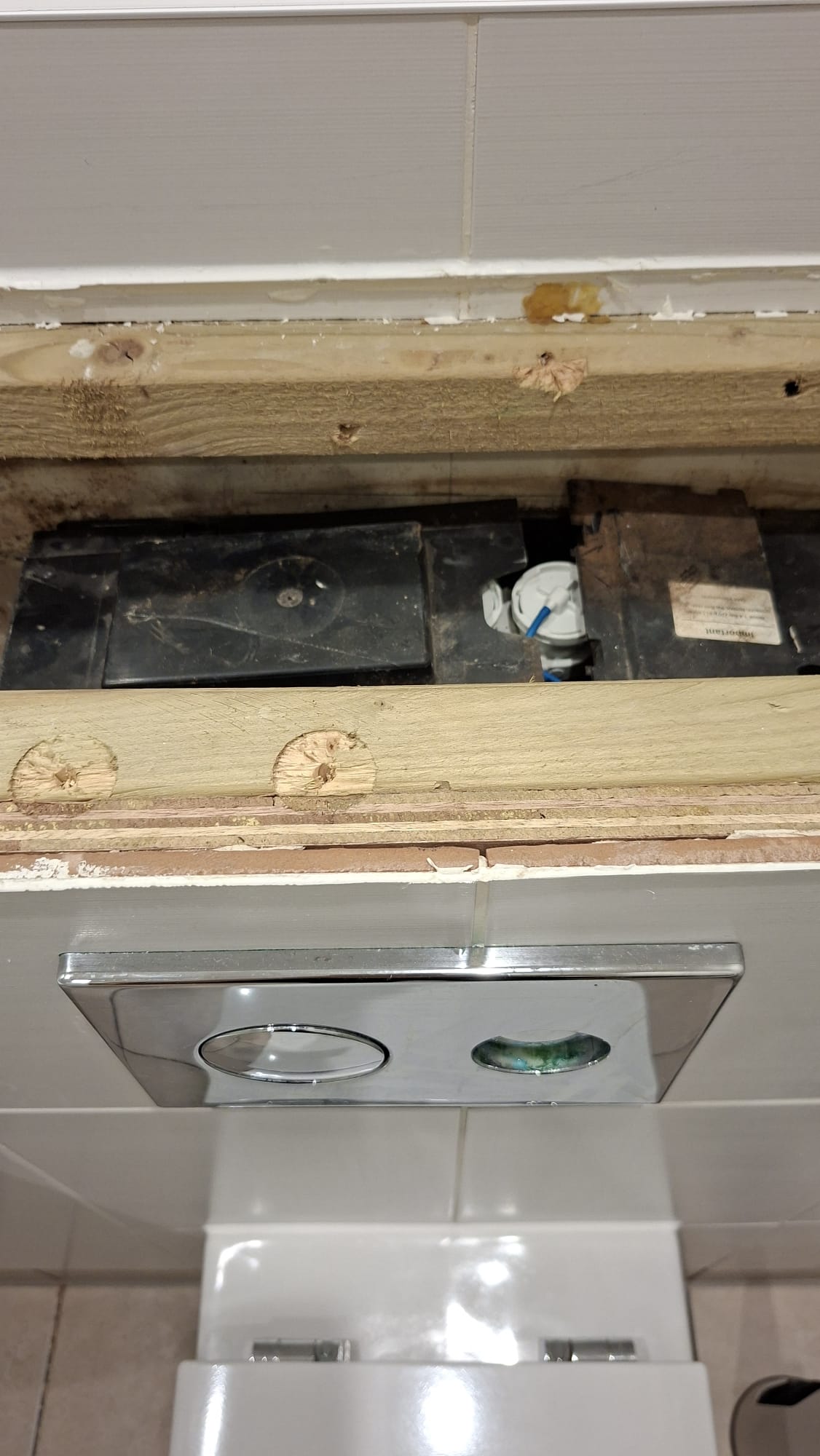

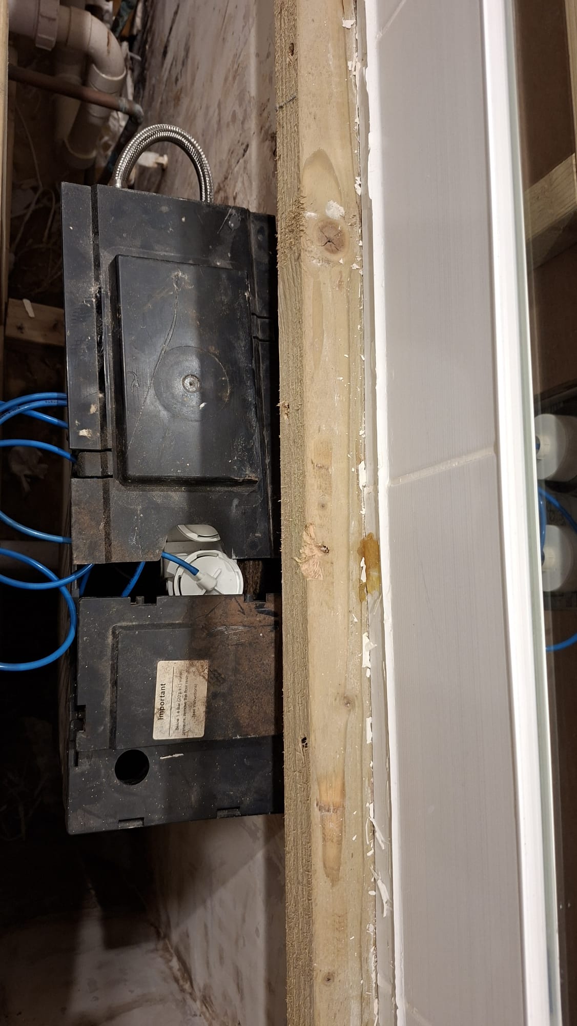

The concealed cistern in my partners flat has been leaking from the flush pipe area. I suspect it is cracked and will need replacing. Looking at these photos do you think it will be possible without breaking tiles or removing the btw pan? The only access is through the top or through the flush plate. I guess if I can do it without disturbing the pan end of the flush pipe too much I should be ok? Or am I asking for trouble?

Look up flush plate removal.
Be easier and another access point.
Look for brand markings as will help to be specific
Thanks. Yes getting the flush plate out makes sense and looks easy enough. So you reckon I should try and fit a like-for-like replacement if I can? Is that so the flush pipe and other fittings line up ok? Is there any danger of me pulling the flush pipe off the pan and not being able to get it back on?
