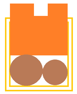

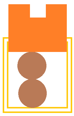

I tend to agree with this but will add that with many JB's it can be hard to tell iof the multiple wires are positioned nicely in the terminal, or if the wires are different sizes
True, but at least in the case of your illustration of the latter, the 'tug test' ought to have revealed the problem at the time of initial installation.
I would add that, in practice, the copper conductors are usually so soft that a problem such as you illustrate probably doesn't often arise, since if one does up the screw 'pretty tightly', it will often/usually squash the larger conductor enough for both to be reasonably 'gripped'. Also, of course, by far the most common situation is for all conductors in a terminal to be the same size.
