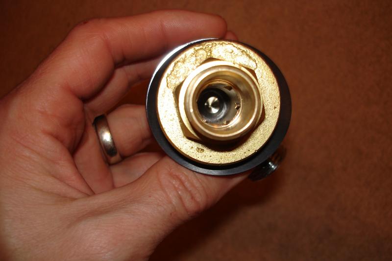

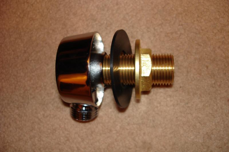

There's no instructions regarding the union elbow at all - only fitting the rise rail itself. It looks like this: .
Any tips on how to fit this or know where I might find some instructions for this type of fitting? i assume I have to
a) remove the threaded part form the chrome "housing" with a large (12mm?) hex key
b) screw this into a BSP thread elbow at the end of the pipework
c) aquapanel/tile
d) screw the chrome housing back on?
Where does the brass nut fit in the scheme of things? I'm a little worried that I'd have to tighten this up from behind (by cutting through the plasterboard in son's bedroom for access!)

That particular fitting is unusual if the threaded brass section is removeable....anyway, I would either fit the complete fitting after tiling or unscrew the threaded brass section and fit onto your wall plate elbow/female iron connector, then tile, then fit chrome section after tiling
Whatever you decide, it's likely that the threaded section will need cutting down, no need to use the backnut, most shower outlets don't ever come with one.
Make sure you apply silicone around the hole in the tile before you fit your shower outlet.
