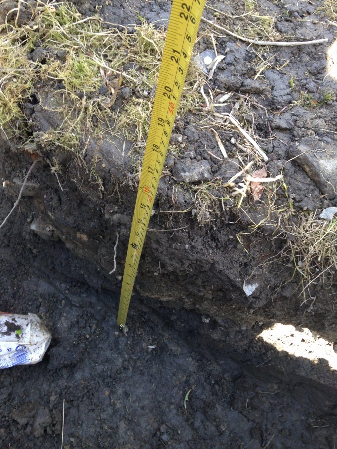

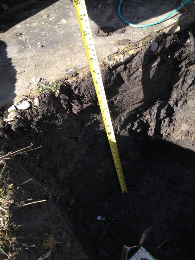

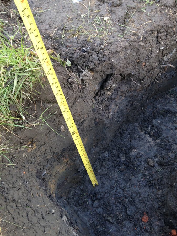

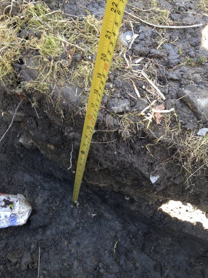

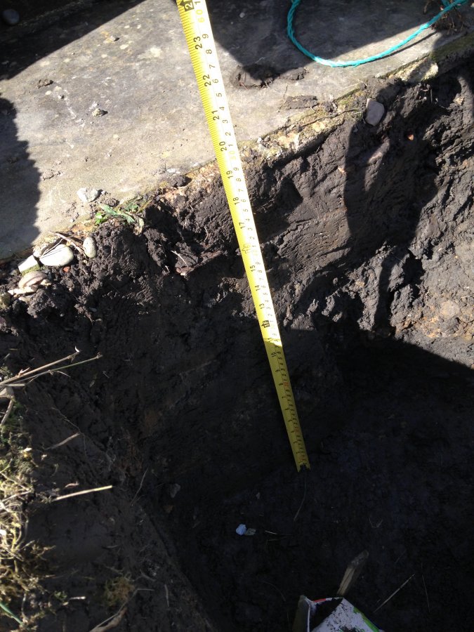

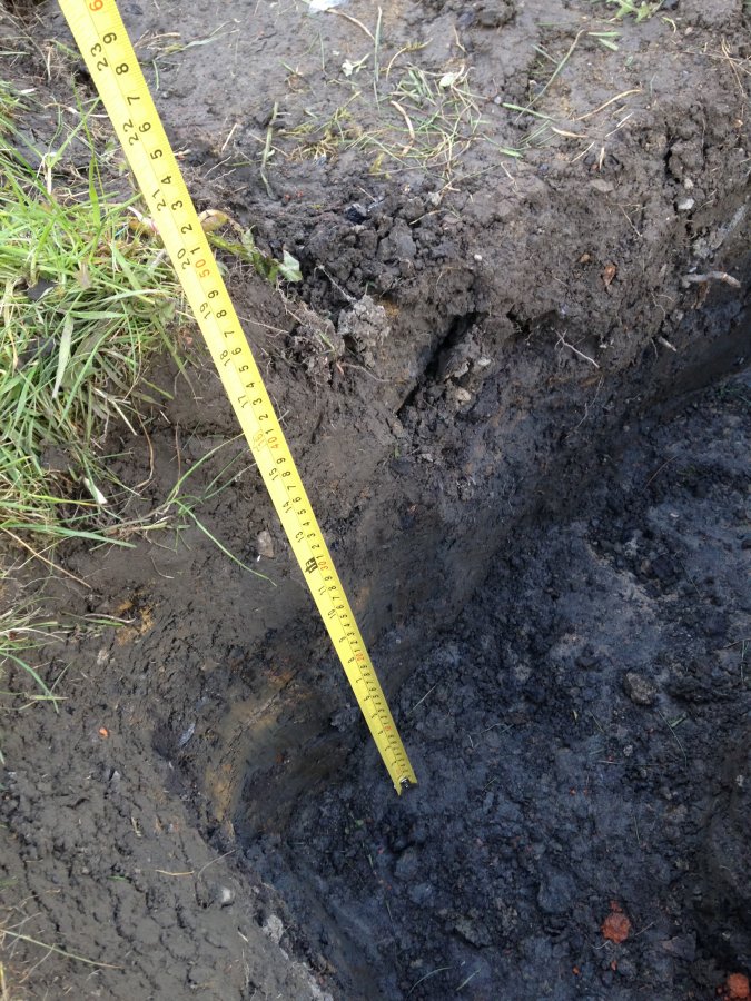

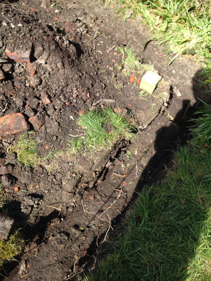

I questioned 50cm trenches and he said 3 storey houses are built with 3ft trenches so 1.5ft for 2.5m wall is fine especially with 150mm concrete in trench. The base will also support the wall he said. I'm going to have to trust him on it.
Just been out and trench depth varies from 40-50cm in places.
Pics done
Stake goes in 4-5 inches with stone.
It'll be fine. There's plenty of houses still standing with far less than 500mm of foundations :)
True, think the Luftwaffe probably assisted with a few :). Trying to stop OP fretting about details- if he's got a decent builder who knows the area and plans on being in business for a while then he'll be fine.

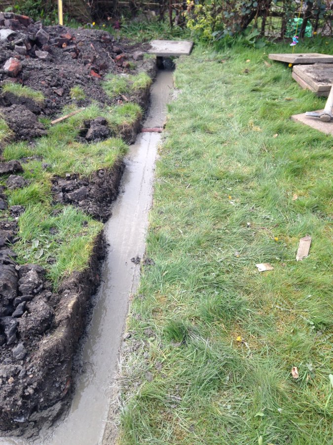

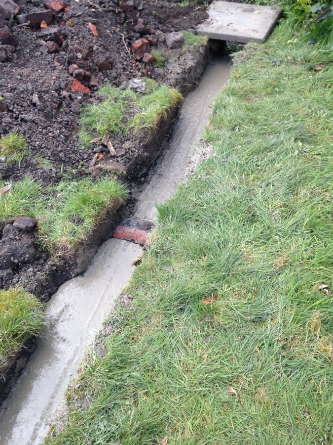

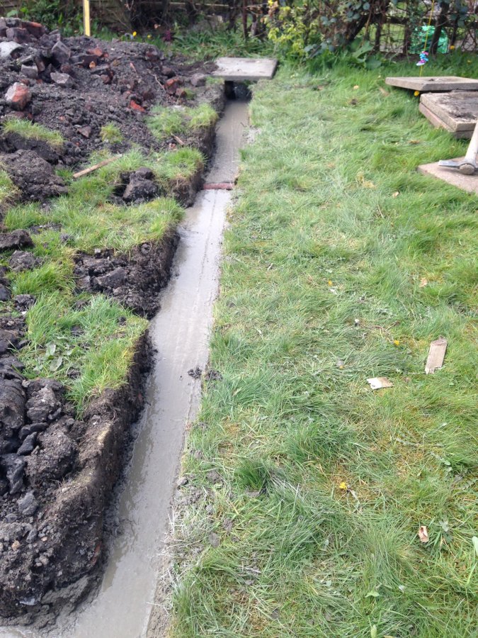

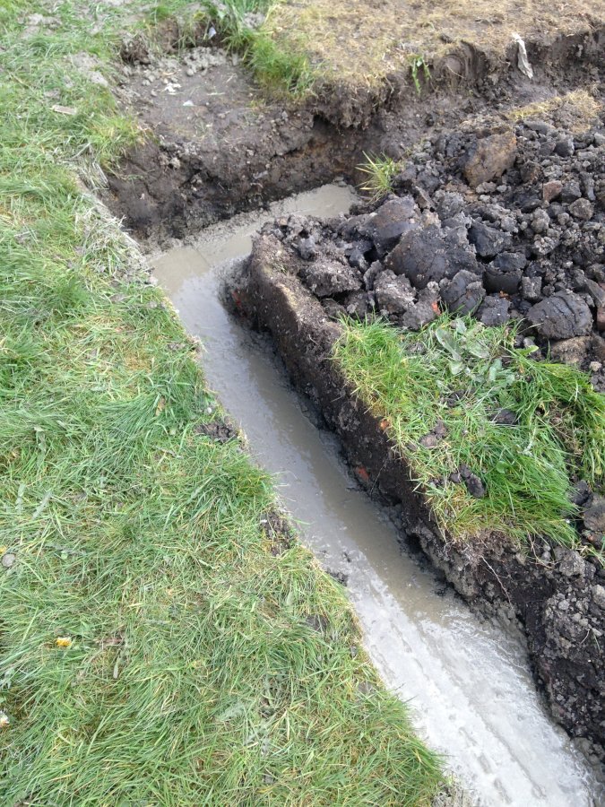

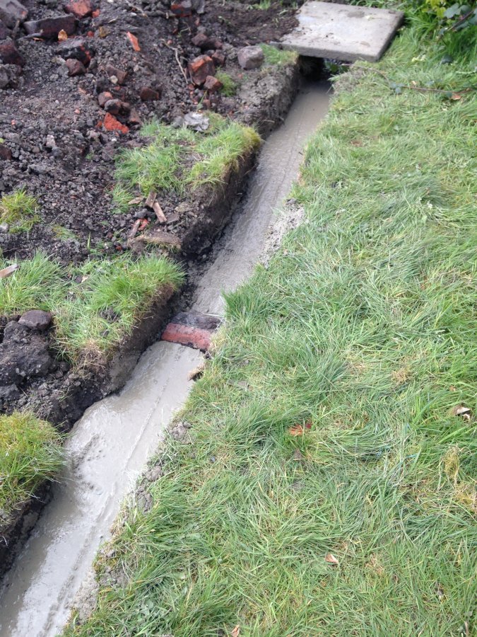

Concrete pour has started. It's at least 6 inch but most places deeper as you can see from pics top of trench is min 40cm.

WOW! A whopping six inches on black fertile soil. Good luck with that. And don't forget those pictures after a couple of wet and cold winters.(y)
Not sure why your think anything more than 150-200mm is required. It's garage FFS not a double storey extension.
And we're not living in the arctic our winters are getting warmer .
