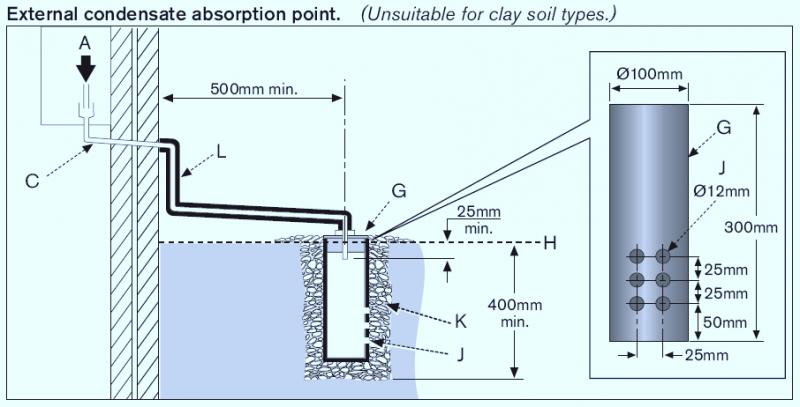

It should be 500mm away from the house. the reason for using a proper soakaway or bit of soil pipe is to have the holes on the side facing away from the house :wink:[/quo

I will do, the job was done friday, but first I have to give the installer a chance to fix it, my question, is it a building regulation that condensate pipe end has to be 500mm away from the house wall.
Thank you, well it has not been installed like that, the condensate pipe goes down the wall strait in to the soil, he did put some lime chipping in the hole but that it.
and do people honestly think putting them in a tube will make any real difference at all
