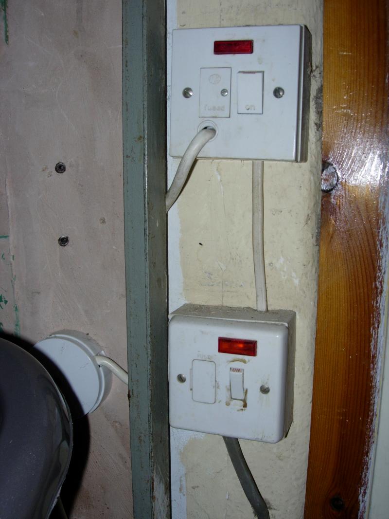

I am in the process of wiring an outdoor 2 gang socket which is RCD protected. The problem is I'm not sure if the most convenient power source is suitable. I have posted a photo to try and help descibe what I hope to do.
The bottom switch connects to the top which contains a 3amp fuse. The wire coming out from the front then goes to power the combi boiler. Is is suitable to connect into the bottom switch and spur the outdoor socket from there? I hope to power a lawnmower and v. small pond pump from it. If so what size fuse should be in the bottom switchbox.

Answer these few questions.
1. The bottom FCU, where is the pvc/pvc cable coming from? What rating
MCB is protecting this circuit?
2. The bottom FCU, what else is this supplying?
3. The cable entering the bottom FCU, is this 2.5 T&E?
If you asked me to come and do this I would have to refuse, it looks 'bad' anyway an FCU supplying an FCU, stinks of DIY
Is there no where more suitable to draw power from? Or is this simply the nearest place to where you want your external socket.
I'm not being off with you, just trying to help
Ha Ha, no problem. This will be the work of an amature as I am finding these little gems all over my new place. I will try to answer!
MCB is protecting this circuit? Not sure as it goes into the floor but its on the same B32 MCB as the washing machine
2. The bottom FCU, what else is this supplying? Nothing, just the boiler but it looks like at some point there was something.
3. The cable entering the bottom FCU, is this 2.5 T&E? Think so, cant see any identification on it, how would I tell.
Is there a better way of doing this e.g. removing top FCU and wiring the boiler into bottom. I guess if I did I would have to go down to 3 amp fuse.
It would suggest that the T&CPC is possibly a spur from a ring final, or some bodge artist has simply run another cable from the MCB to here. which if they have is plain sh1te. :eek:
If it is a spur, and it is the only item on the spur so far then that is fine, however you just cannot gurantee that with out investigating properly. :(
You certainly don't need both FCU's especially if one JUST supplys the other. :rolleyes:
If I was advising you, I would get rid of one of the FCU's and continue to supply your bolier from the other, and yes 3A fuse.
Have a good look around, are there any sockets that would allow you to spur from them (they must be on the ring) to a NEW FCU to supply your external sockets. :?:
Do not forget if you have external sockets they must be protected by an RCD!! :)
Ideally think about a dedicated circuit, protected by RCD naturally, for your external requirements. :D
TBO, I would get a sparky in to advise you, electricty has a nasty habit of giving you heart ache and possibly heart failure ;)
