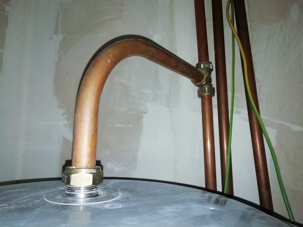

Anyway, how do i connect the flange on top of the cylinder?

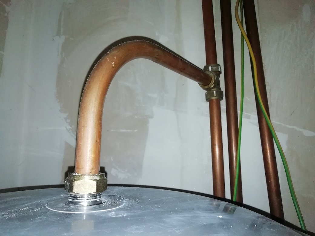

What confuses me if that the current installation has a compression fitting directly onto the cylinder as per attached photo.....but a 3/4 male thread (onto which i can screw a 3/4 compression nut) does not fit into this Female to Female BSP coupler?

You can't fit a flange to that cylinder..the best you can do it have a shower take-off on the underside of the cylinder outlet pipe...have a look in the Salamander Pumps guide.

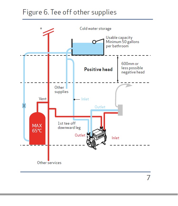

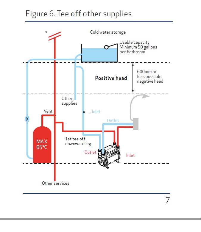

The pump (salamander CT Force 20 TU universal https://www.screwfix.ie/p/salamander-pumps-ct-force-20-tu-regenerative-twin-shower-pump-2-0bar/7146p) will be located in the attic beside the CW tank. No space anywhere else.
Still OK to tee off as per diagram attached?

A regenerative (peripheral) impellered pump is far more tolerant of air entrained water (as the cylinder heats micro air bubbles are released to go up the vent pipe) than centrifugal impellered pumps
so they will cope better with not so perfect pipework.
It all comes down to whether you want to risk voiding the warranty...often theres so many onerous conditions that it becomes almost impossible to comply without tearing the house apart to
install compliant pipework etc.

Yes. A professional plumber installed this huge 300liter cylinder when we renovated part of the house.
On the attached photo, the HW outlet is a 3/4" compression.
HW outlet then goes to a compression T:
- downwards gravity feds the house HW
- upwards goes up the attic & loops back and vent above the CW tank

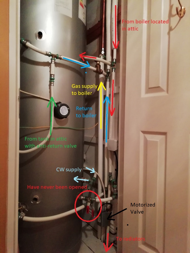

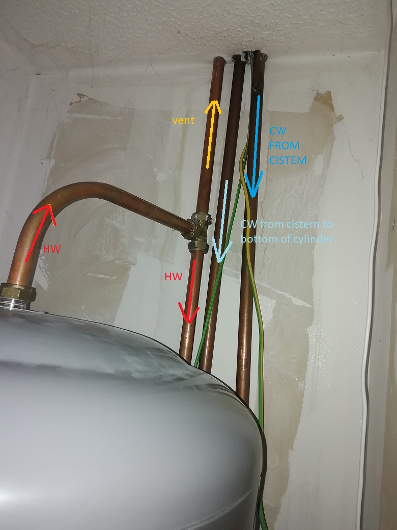

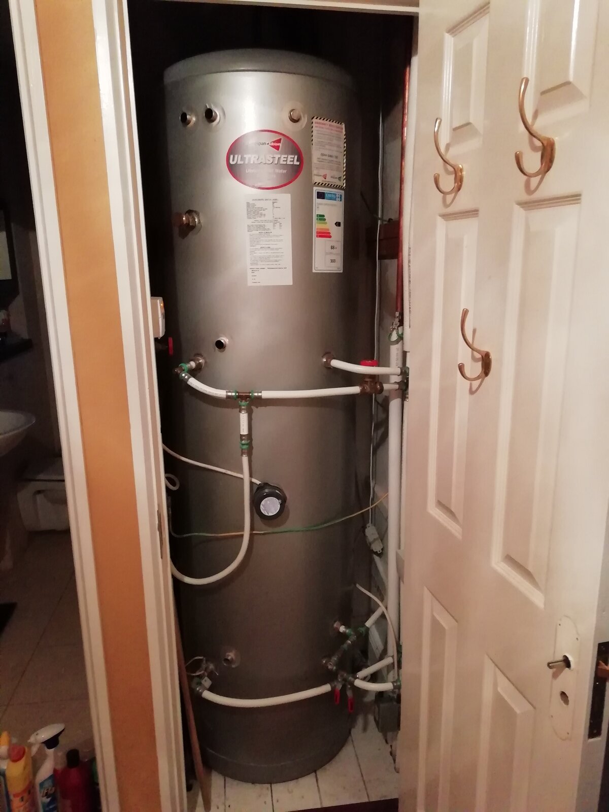

Can you show a few more pics of the side of the cylinder...it doesn't make any sense having a cylinder designed for unvented operation ie. fed by mains pressure
onto a CW tank ie. turning it into a vented cyclinder unless pressures/flowrates weren't done before deciding on the unvented option.
Please find few photos of the current installation. Thanks for your help
