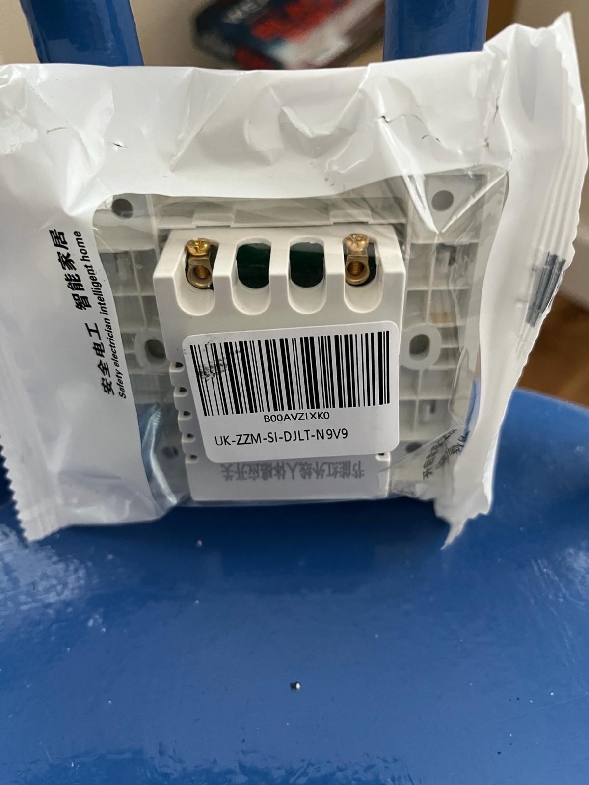

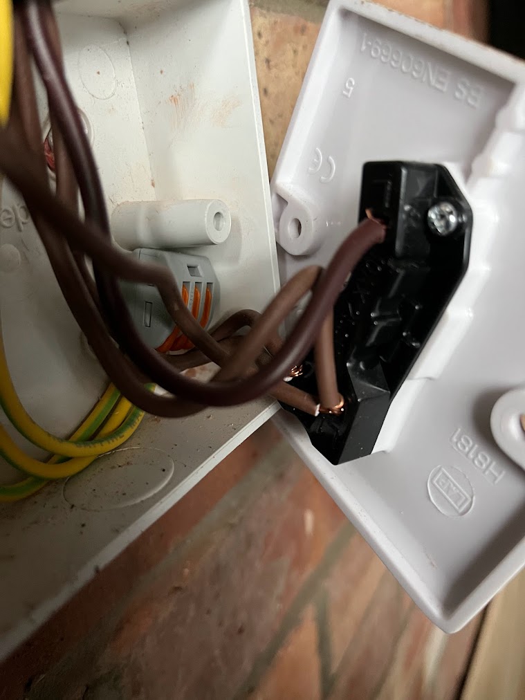

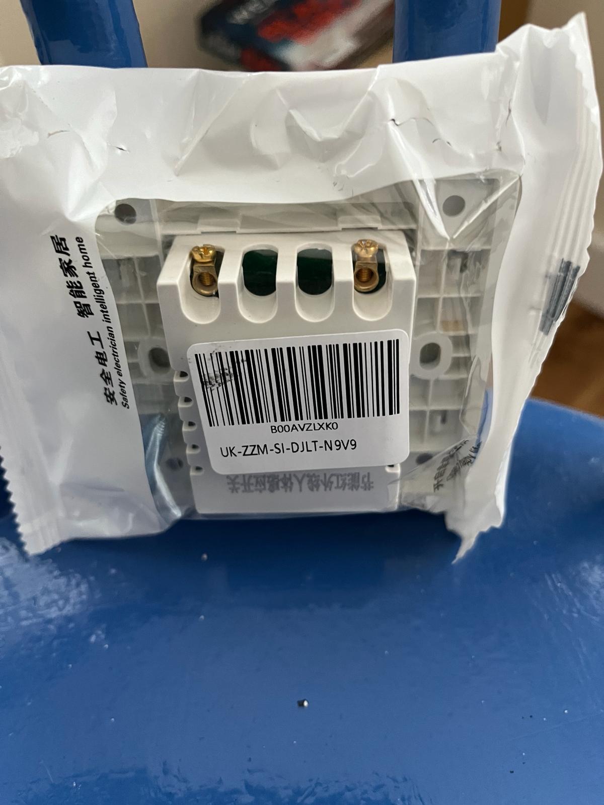

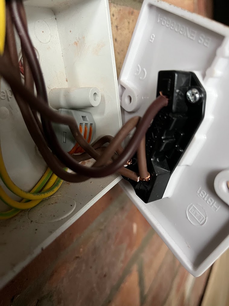

I have a single gang 2 way switching setup in my garage (see image). I want to replace the light switch near the garage door with a PIR as the light in the Glideraol control box has failed and can't be replaced.
Any guidance as to how to make the wiring change would be much appreciated.

I should have included the following.

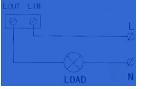

If the PIR is powered by battery or connection to neutral you could have two in parallel, but if the PIR gets its power by allowing a small amount to flow through the bulb, you can only have one.
Not if the PIR is in the garage, it won't.
PIRs work by recognising heat crossing their field of vision.
Good point, I know in one house the PIR only worked if I drove in forwards, if I reversed in it did not work, I would think the reverse would be true for a rear engined car, and would completely fail with an EV.
The PIR you show does not seem to have a neutral connected, so can't run two in parallel.
You cannot have a PIR as part of two-way switching because it is only a one-way switch.
Do you want to do away with the other switch or have it as an override - either on or off - to the PIR?
Of course you can, just wire the pir across L & SL which will leave the 2 way switching in place
