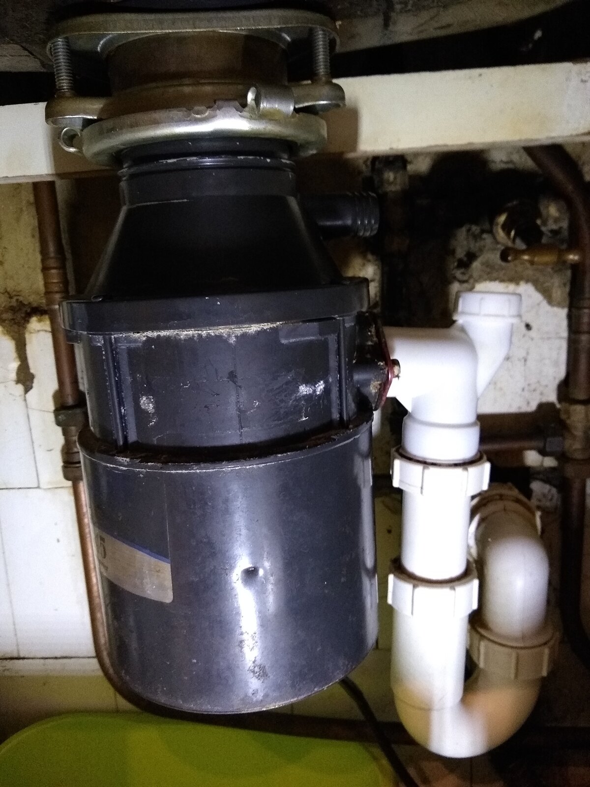

Hi - I want to replace my sink basket strainer. Can someone advise me what fitting I use at the lower threaded section of the strainer so I can continue off in 40mm plastic pipe and fittings to my existing trap. I've seen the fitting used but I don't know what it's called - basically a plastic nut (or sometimes a brass nut) and a (top hat?) washer. Would a McAlpine T29 fitting be suitable?? - or I've seen trap height adjusters which may possibly be suitable. All advice appreciated.

A pic would help but most new basket strainer waste and roughly the same depth and are the same 40mm size or at least you should be able to find one with the same throat length/shape. So replacing the whole sink waste for a new one shouldn't really effect how the trap will fit.
Thanks for your quick response, you would probably be right normally BUT I have a waste disposal unit at the moment which I intend to abandon.
And I'd still like to know the various fittings that can connect to a strainer basket and allow me to continue with 40mm compression fittings ie T29, T12 etc. (Actually I get a bit confused by mention of 38, 40 and 11/2" sized fittings? I assume the strainer basket outlet is 11/2" male BSP?).
The size of the waste in the sink, once the waste disposal (WD) is removed will be key. Most are 90mm dia which means a normal strainer waste will fit. Some WD's have their own internal traps, has yours? If not then you will have to extend the pipework from where the trap is currently to where the waste outflow's new position will be, what type of trap is there currently? Then it would just be a case of a piece of 40mm pipe and some couplers to fit to the existing waste pipe run.
I would adjust the waste pipe and move the trap, if a standard P trap, up to where the waste outflow will be, leaving everything the way it is and trying to use various couplers and bits to fudge a connection from the trap to the sink waste is a recipe for potential problems in the future
Again pics of the current setup and waste run etc would be a big help
I’m fairly sure it’s a 90mm dia. sink waste. The WD is an Insinkerator and I’m fairly sure there’s no internal trap – not least because there’s an external P trap! In any event I intend to dispense with the WD.
But my fundamental question is the connection to a new basket strainer which will allow me to continue with 40mm dia. plastic pipe ie is it a McAlpine T29, T12 or some sort of tailpiece (if I reuse the existing trap)? And is the basket strainer 11/2” (40mm?) male BSP at its lower end? As I said I'm a little confused by mention of 38, 40 and 11/2" sized fittings.
As you suggest a photo is better than a thousand words (I think I should've shrunk it somehow!).

The trap connects to the basket strainer.
While there may be other parts that could be cobbled together to do that, it's entirely the wrong solution, will cause problems and is just making a pile of work for nothing.
Trap: https://www.screwfix.com/p/mcalpine-adjustable-inlet-tubular-p-trap-white-40mm/46577
You will also need two of these: https://www.screwfix.com/p/mcalpine-mt4-bend-90-40mm/45446
and a length of pipe: https://www.screwfix.com/p/floplast-push-fit-pipe-white-40mm-x-3m/65426
New trap onto the basket strainer.
Pipe horizontally from trap outlet to one of the elbows, with the other opening downwards
Other elbow goes on the existing waste pipe with the other opening upwards
Piece of pipe vertically between the two elbows.
Lengths of pipe cut as required so that the elbows line up vertically.
The existing trap and the other bits attached are removed.
Theoretically possible to clean and reuse but it will inevitably need new seals and what's gunged up inside it will be vile.
