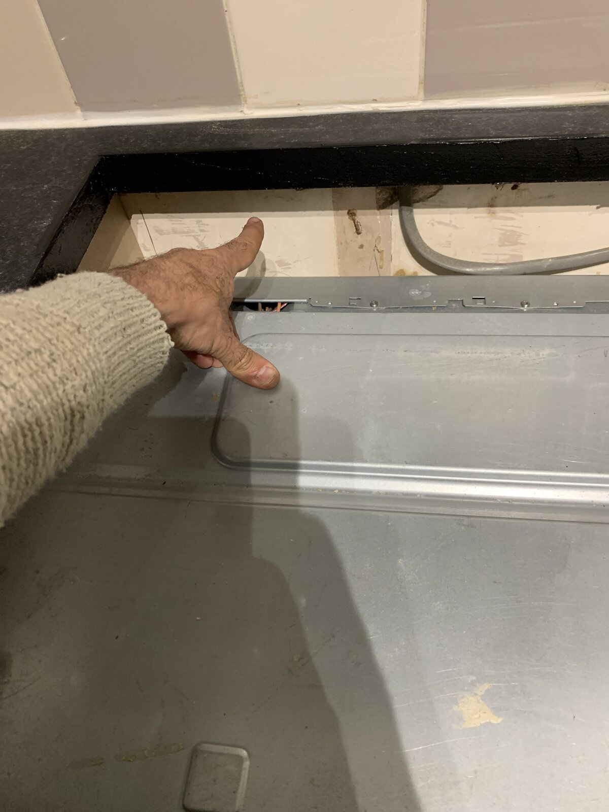

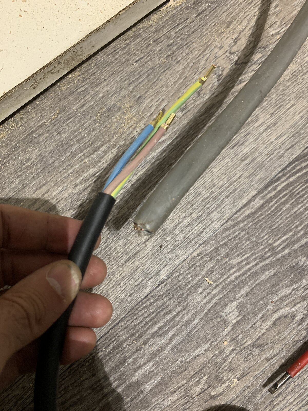

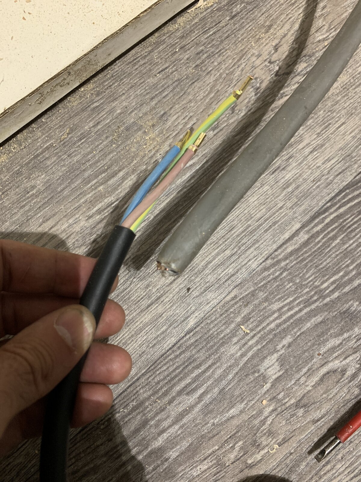

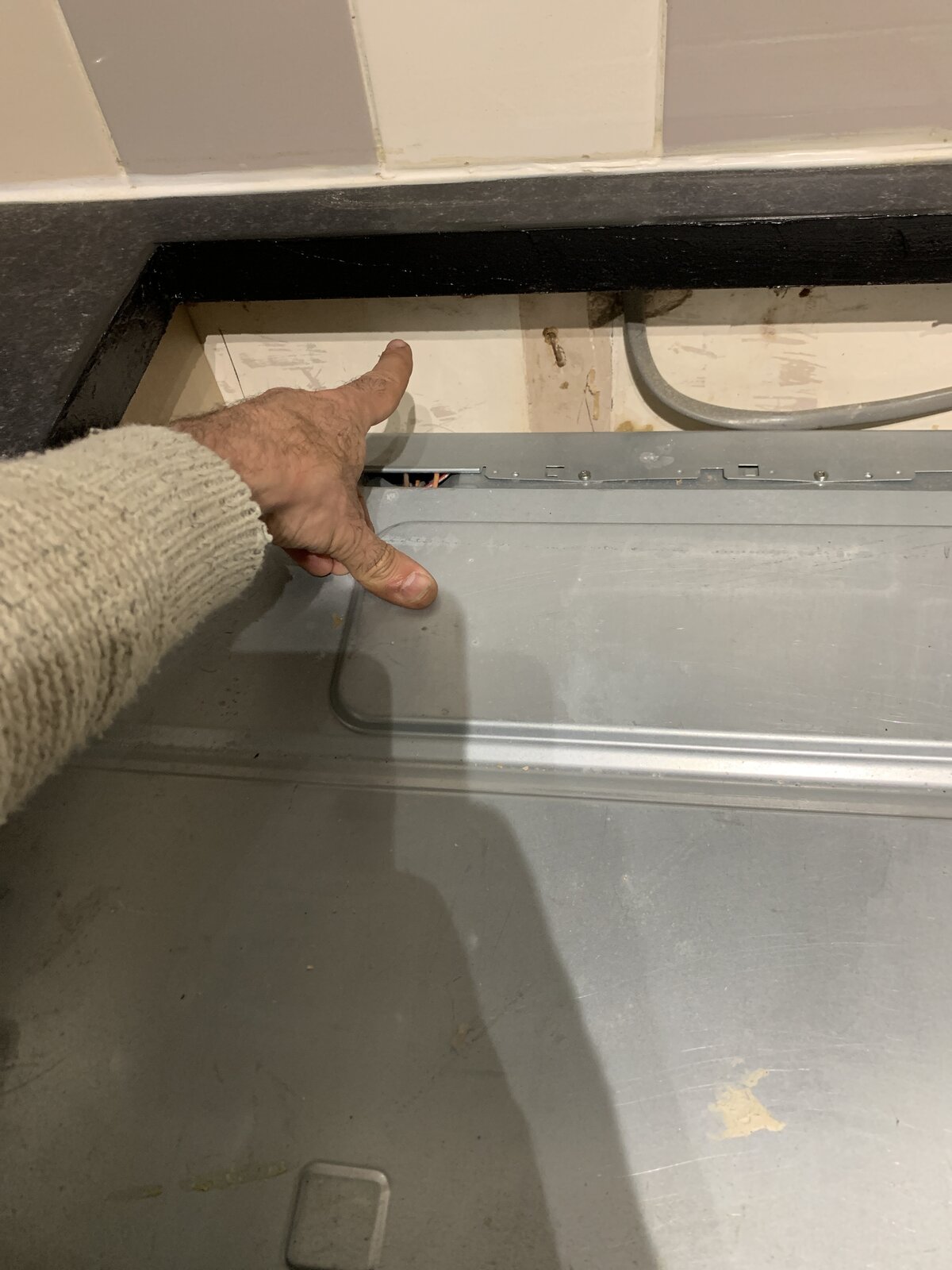

I’m connecting a hob cable to a 6mm via a whiska weatherproof junction box underneath the cooker.
Do you know what gland sizes I need for the flat 6mm cable is it 20mm or 25mm.
Also what size wago connectors do I need I can see the 4mm ones on Screwfix but do they do a larger one.

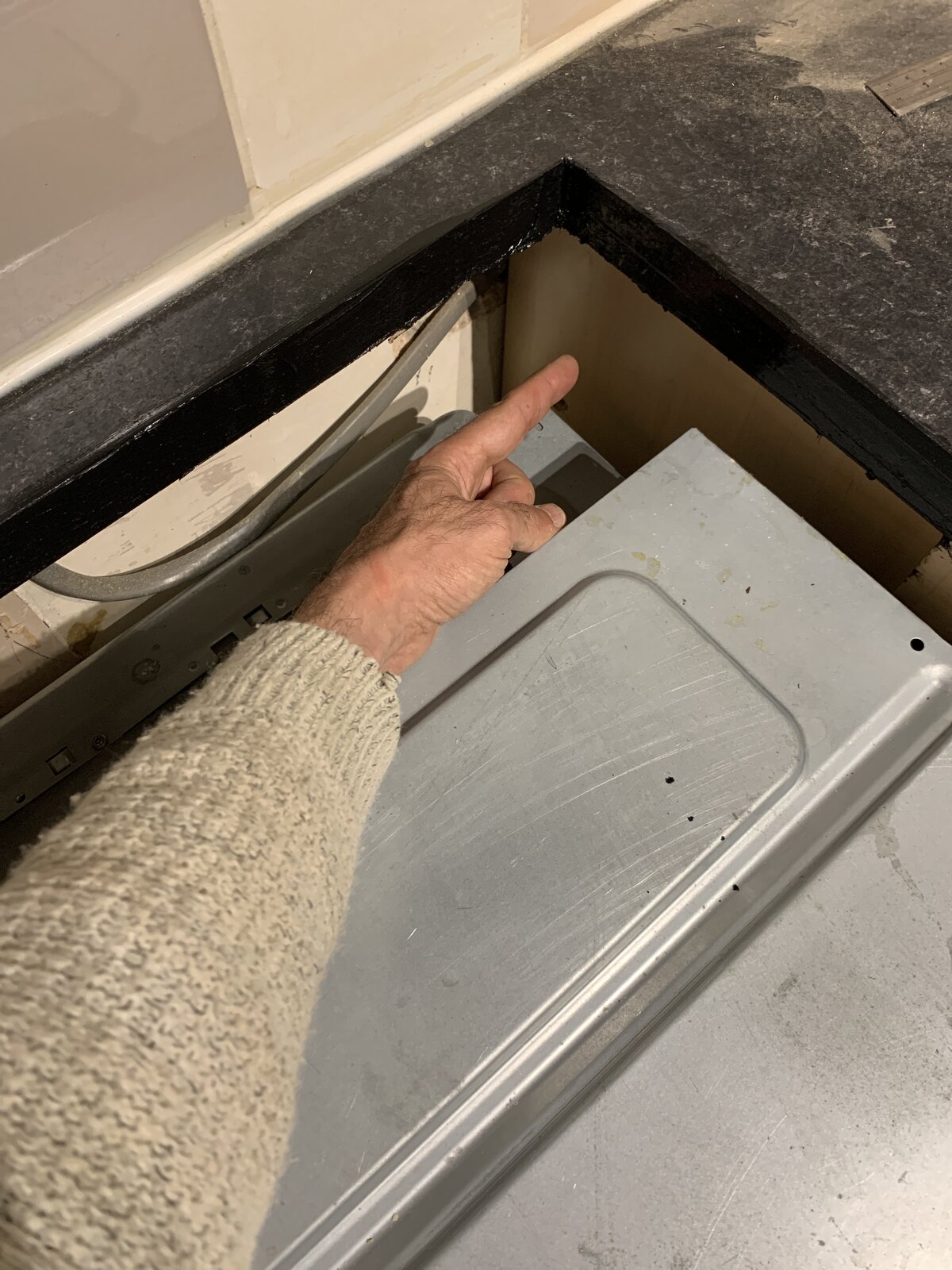

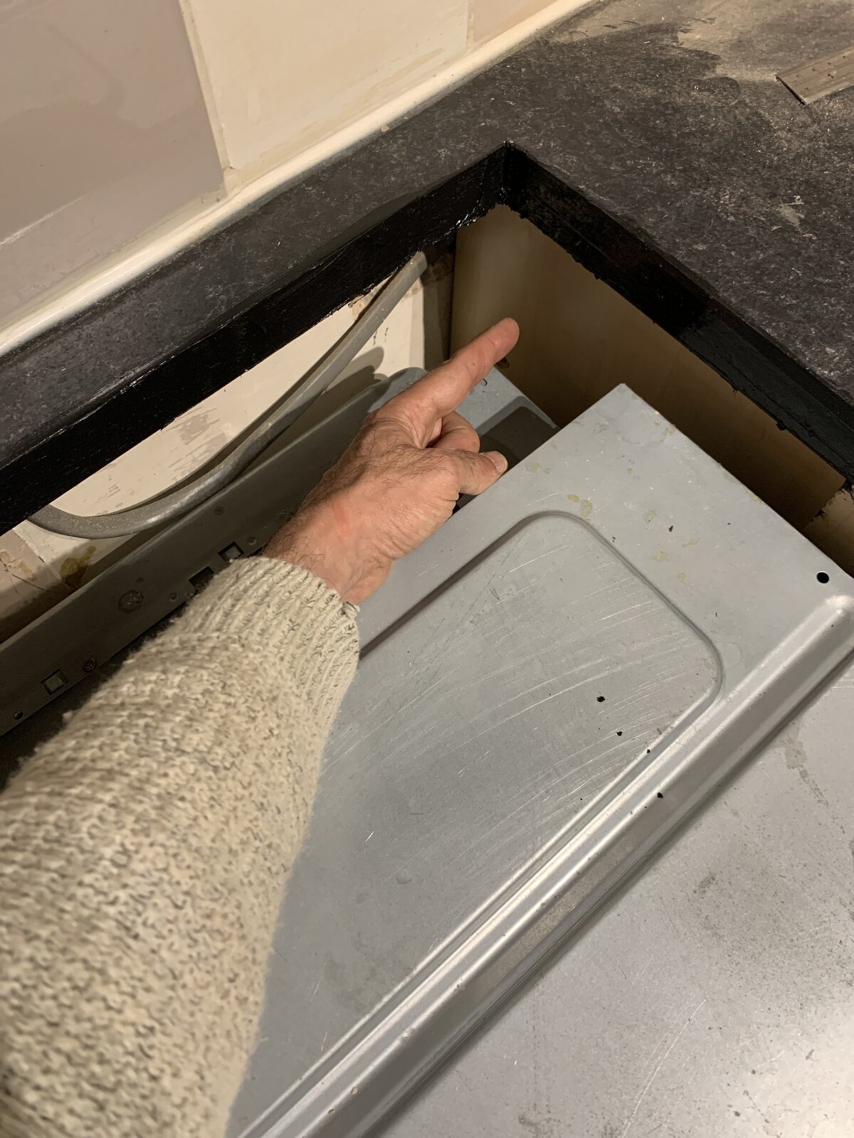

The tenant is moving this week and have no time chiselling the wall to put a flush mount box and don’t think a surface mount one fits in. I’ll have a look, unless I put it I. The cabinet next to it
Can I actually place it here the cooker outlet?
Or attach it to the back wall?

This would be my choice, fixed to the back wall
toolstation also do larger wago,s

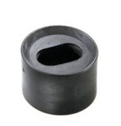

Stuffing glands for twin and earth use special grommets 1684831007864.png it depends what your local suppliers have in stock, no good asking on here if in a hurry, need to ask your suppliers. From what you say internet buying will be too slow.
I ended up installing a flush MK cooker outlet, it didn't take that long as the back was a breeze block easily drilled out.
I did use a 47mm flush box that was a bit deeper than expected. Used a standard grommet, 6mm cable went through fine.
