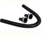

Hi there,
I have two waterbutts - an 250L amphora urn style from Garantia (impossible to access the inside of this one) and a regular Ward 210L from B&Q. I want to connect them together at the bottom so I only need a tap the urn style, with the other sitting behind it, water levels rising and falling together.
On the urn there is a screw-in drainage plug socket I can use, on the regular one I can take out the tap and use that socket, they have the same dimensions so guessing it must be a standard size - apx. a 9cm circumference, there is eventually a question on this!!
I bought a connector kit from B&Q (see first picture), but this is designed for new holes, I cut off the flange (intended for inside) on them, screwed into both waterbutts, but only a couple of turns for the urn - which increases my concern that without washers/flanges they are going to leak with all the pressure they will have to bear.

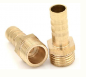

I think I need to buy something better suited to the job, such as the brass ones in second picture, however there is a variety of size options, any advice on what size required for these connectors? Any other advice also would be much appreciated.

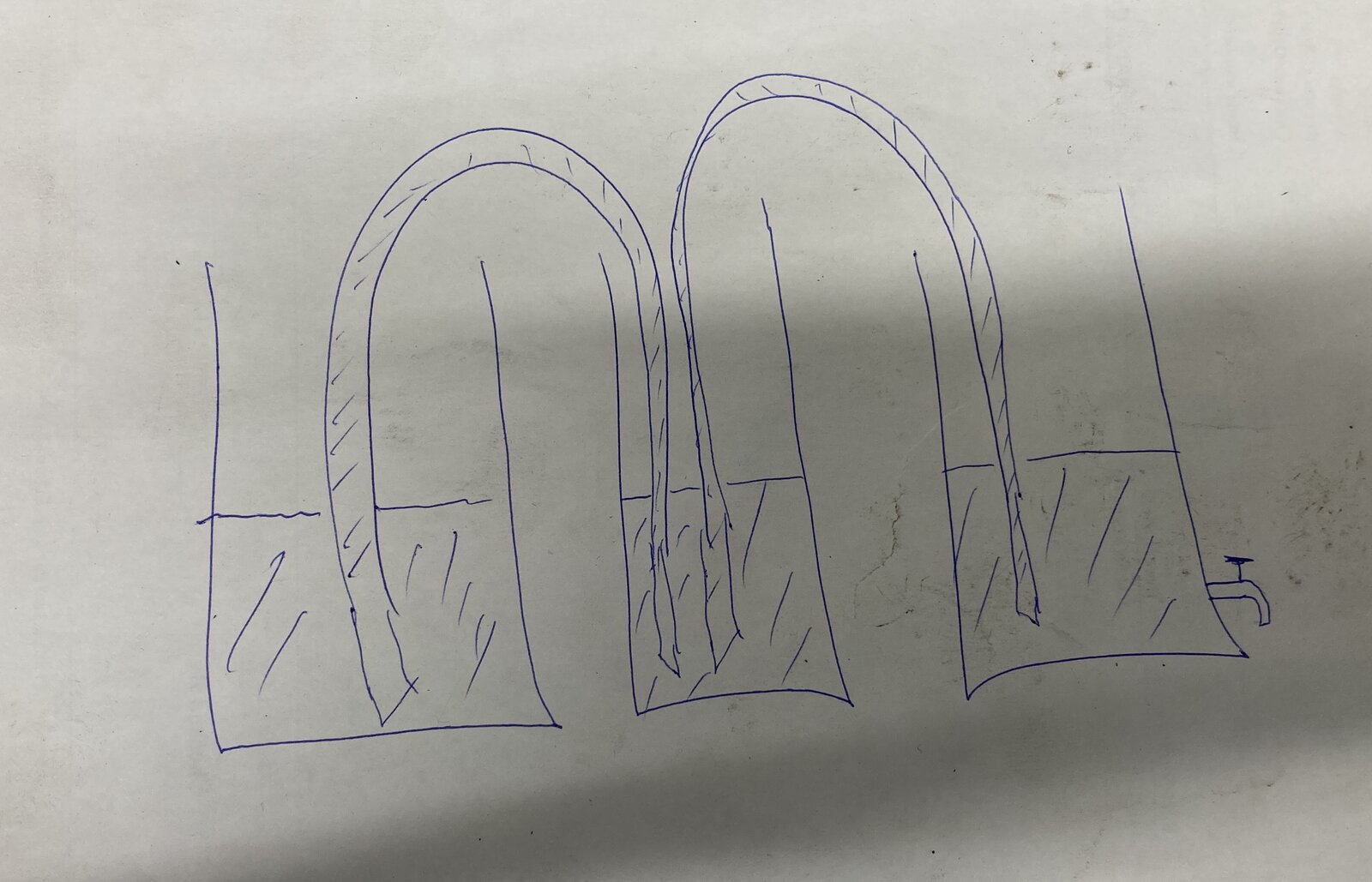

I have three that I'm going to connect together. What I've seen done is to just loop then together with some stiff pipe from butt to butt but you must fill the pipes first. The water level will always equalise.
And the outlet tap must always be above the end of hoses level otherwise you will loose the syphon effect

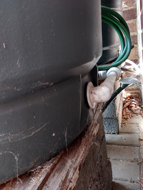

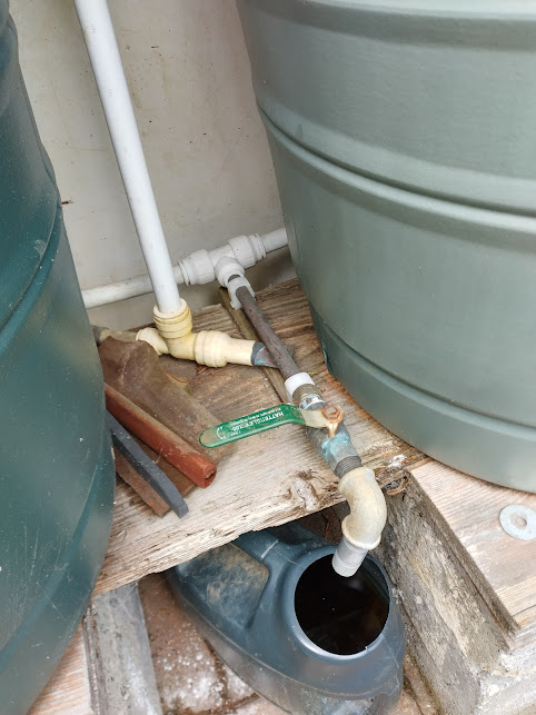

I happened to have enough bits in hand to create this (supposedly temporary installation) but if purchasing new I'd have probably gone all plastic.
Ignore the vertical pipe and Tee piece, that's for the overflow.

Have also gone for CBW's link thanks for the Ward kit, they fit a treat and much better than my hacked B&Q ones. A shame B&Q dob't sell the Ward kit since the water butt I bought there is Ward!
