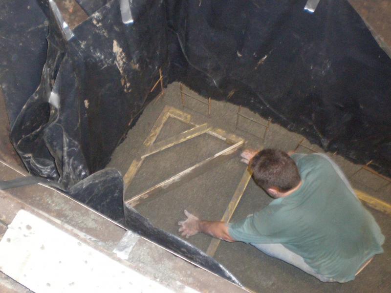

I will be using steel mesh reinforcing supported by standoffs on a plastic sheeted lined base.
As the base will be clay, and the trench walls are shear, I dont want to stand on the mesh and puncture the membrane, how would the pro's do it?
Would you pour a thin top coating of concrete and work on that for example, any help would be much apreachiated.

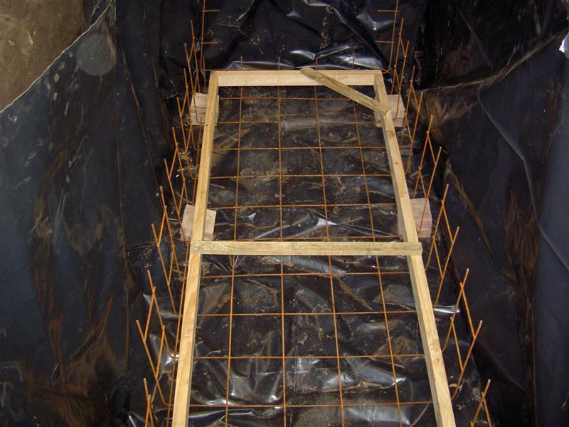

@ Redpis, Dunno where your upto with your pit but if its any help I'm right in the middle of the same project and am using extra thick guage DPM and standard mesh for the base bent round to stick out of the kickers so that when I cast the walls Ive got something to wore the wall mesh to. The job's at a stop at the moment while I decide on how thick I need the walls. 2 ft of topsoil and then 4 ft of clay, seems stable enough but am wondering whether to step the wall out a few extra inches at the bottom just to be safe.
For the record the hole is:- 3.5m long x 1.1m wide x 1.8m deep.

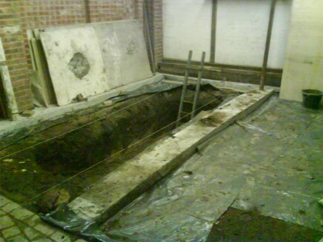

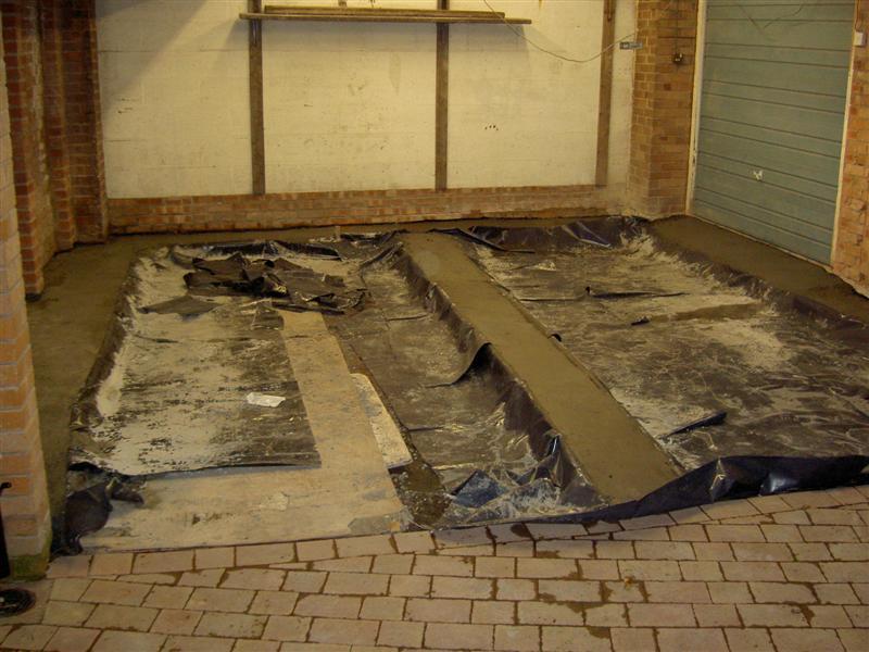

Decided to dig the pit in the left bay before I laid the concrete floor
I'll post the results when I'm done. :D

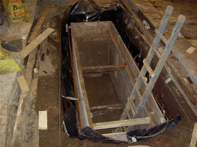

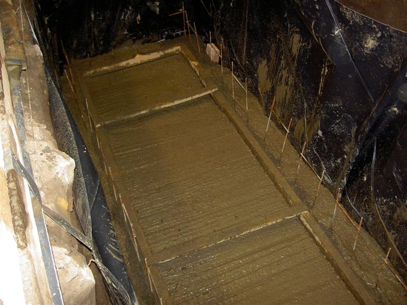

in your 3rd pic, is that a brick wall I can see at the end of the holel?
I was wondering how much the surrounding building would be destabilised by digging it out.
No its just the top of the clay, I thought I would chop the soil back a bit to form a step in case I needed to climb out in a hurry as the ladder isn't too marvellous as you can see by the missing rungs.
The concrete ribs i have poured are just to set the levels of the floor so I have something to tamp off when the ready mix lorry arrives. The dpm is folded back on itself several times, there is about 1m overlap.
The ground has never been disturbed so I dont think it will destablise too much if at all. I've had a bit of advice off a structural engineer to make the walls a bit thicker so I intend to dig another 4" out each side, although IMHO i think its a bit of overkill.
I've got mesh for the base folded up to form starter bars, and have mesh for the sides which i will tie in at the top. So I'll post some more pics when I get some more done.

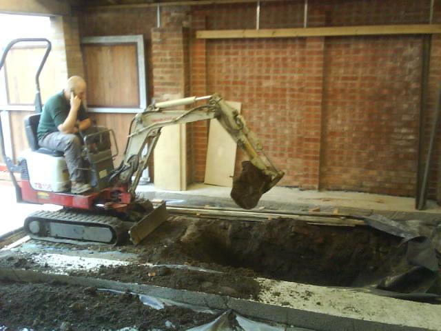

OOI, what are the dimensions of the hole, and how long did it take you with the baby digger? Have you used one before?
Did you just dump out of the digger into a skip?
Thanks :)
The hole is now 4ft 4" wide, 11ft 6 long and about 5ft 8 deep (3500x1320x1750) although its a bit hard to guage the depth when trudging around in the clay and the water, LOL.
I made a depth guage out of timber to measure 1700mm but I've dug past that now just trying to keep the stones from the soil falling into the clay. they tend to be a lot sharper than the pebbles in the clay and Ive been worried about perforating the 1200 guage visqueen.
The guy with the digger took about 6 hours, he took 14 ton out and had a large Ifor Williams trailer parked in the right hand bay of the garage to dump the stuff straight in. He made 3 trips to the dump to get rid of the spoil. It worked out at £180 for him and the digger, and 3 x £50 for removing the waste, so £330 in total.
I'm realising now it is not going to be a cheap job but I've started so I'll have to finish :? I'm going to get readymix when I fill up the bays as they are cheaper than my builders merchant, but for the time being while I'm getting 1/2 cubes of concrete from my local builders merchant in ton bags dropped into a trailer. At £150 a cube they are expensive but I get to set levels and tit about at my own pace whereas readymix will just throw it in and go (readymix are £125 first cube and £85 thereafter).

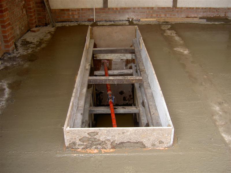

I've now cast the floor and kickers (1/2 cube), and will have the first lift of the walls done on Saturday. Will need to get the mesh tied in to the starters first and then form the mesh round to meet up with the garage floor slab.
It's a slow job as its just me doing it, but I'm so glad I'm out of the mud :)
Trying unsucessfully not to puncture the visqueen :cry:

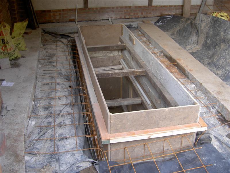

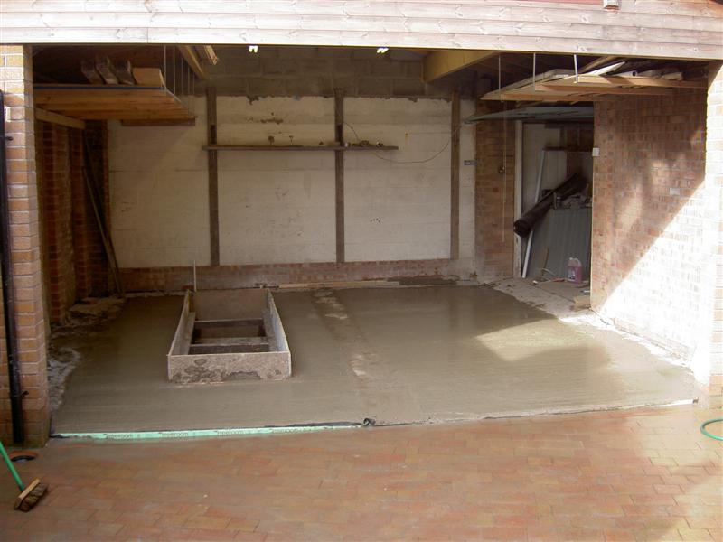

Shutter taking shape
A bit of reinforcement
Readymix in at last
Finally starting to look like a garage again :D
